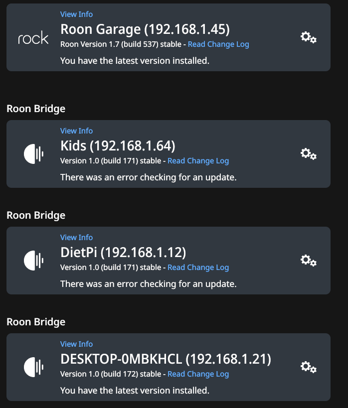

I am having the same issue. Here’s my inputs:
  1. Networking Gear: Swisscom Internet Box for internet, access, Planet GSW-2401 Gigabit switch. Roon Core: ROCK on Asrock Deskmini 310
  2. Logs are here: https://www.dropbox.com/sh/157h92ig4mljjqj/AABhNQgZo1QfJ3Aewg26kui1a?dl=0
  3. No firewalls, all devices on same LAN
  4. no other issues than update message
  5. No change after reboot of Roon Bridge
Here’s a screenshot:
Devices from top to bottom on Screenshot:
  • audiolinux with Roon Bridge on Intel X86. Does NOT show the issue
  • Odroid C2 with volumio and Roon Bridge plugin. Shows the issue
  • Raspberry Pi4 with volumio and Roon Bridge plugin. Shows the issue
Hope this helps
