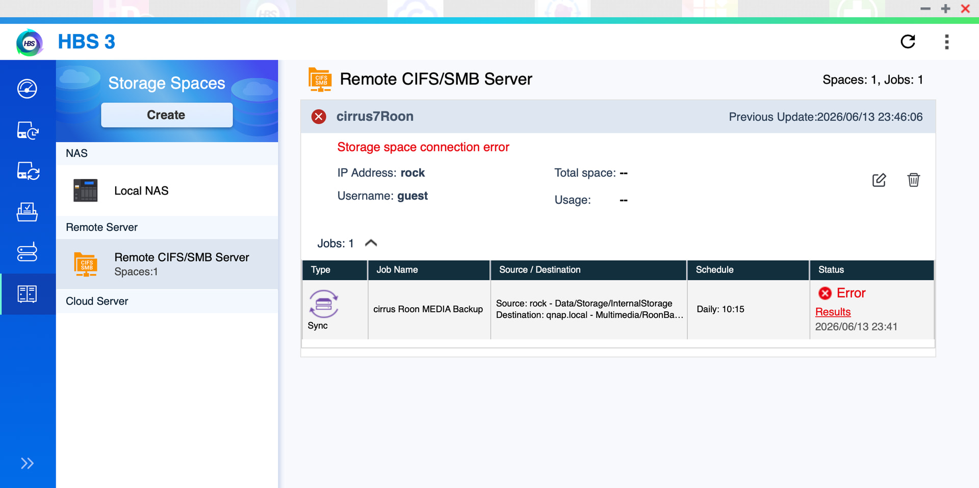

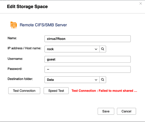

I just realized that my HBS sync job from the ROCK’s internal disk to the NAS is failing after the update to RoonOS 3.0.
I made sure it uses the guest/guest credentials but no dice. The log just gives an error -22, “Bad job parameters. Check job settings”, but I didn’t change anything about the job:
[Hybrid Backup Sync] Failed to complete Sync job: “cirrus Roon MEDIA Backup”. Bad job parameters. Check job settings. Attempting to retry. Error code: -22.
The only things I did was:
  • Change the ROCK hostname because this was a change I made with the OS update. But the IP fails, too.
  • Use guest/guest, but I think this was always the case, anyway.
I’m a bit lost, any ideas?

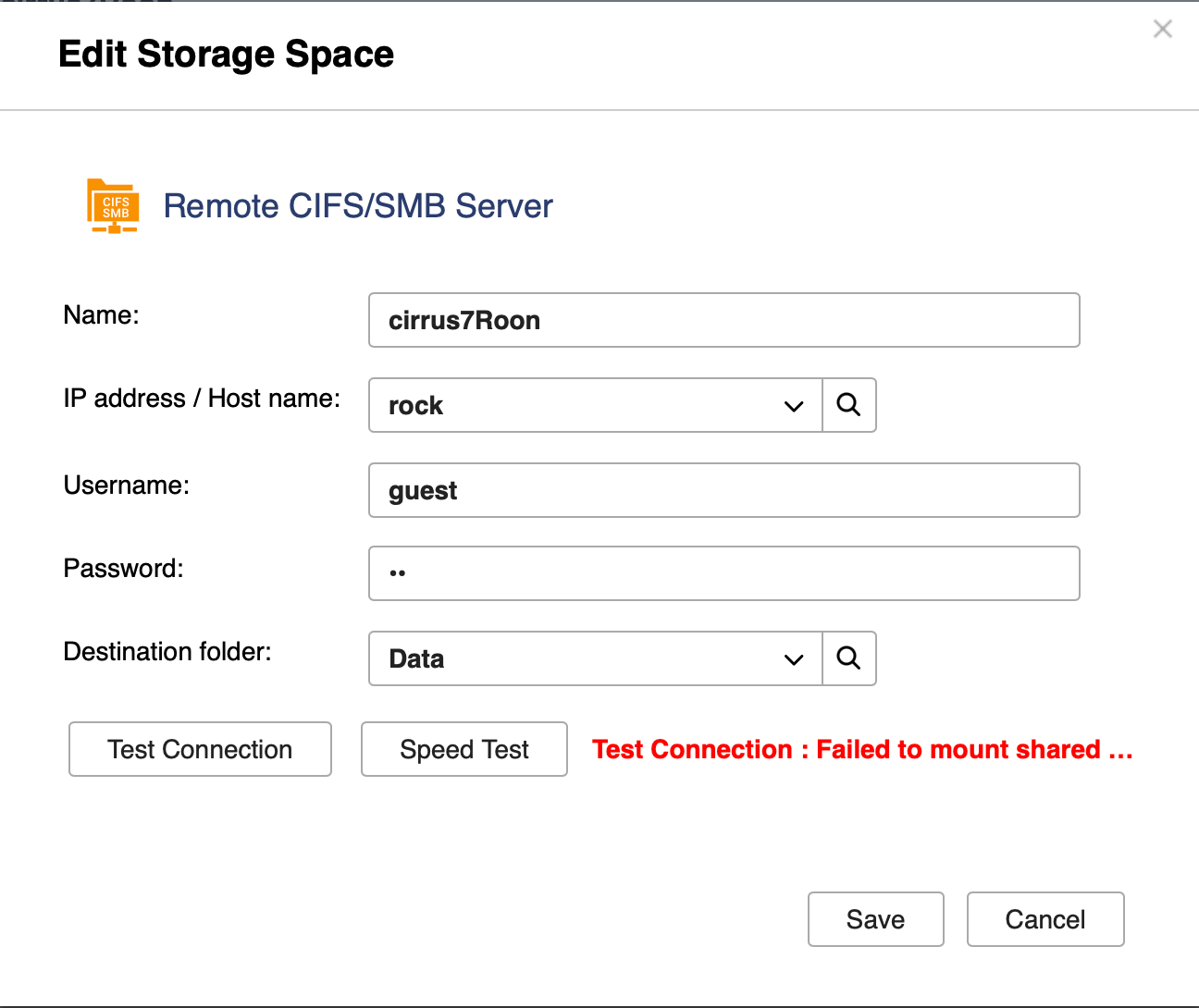

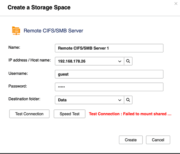

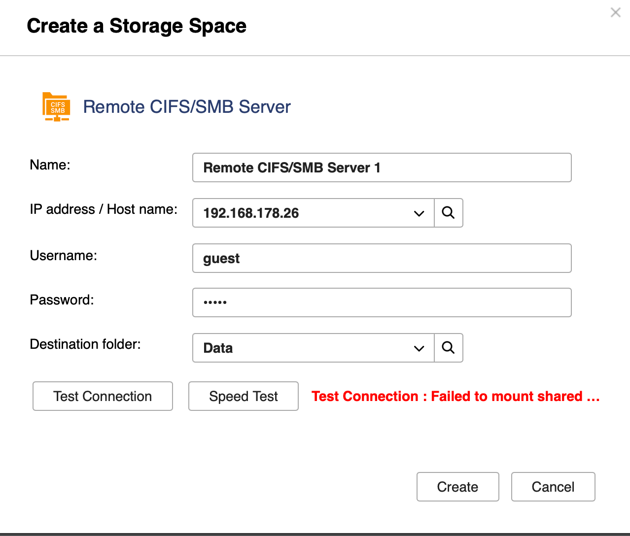

Creating a new storage space fails with a connection error too.

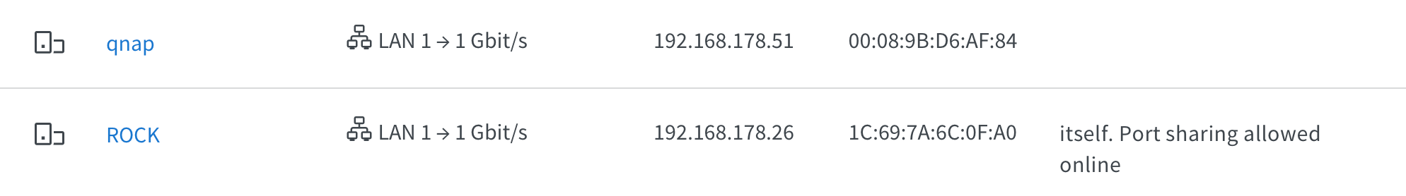

IP and hostname are correct, from router:
I can’t connect from File Station (New SMB Mount) either. Both the Anonymous and the guest/guest credential option fail with connection error.

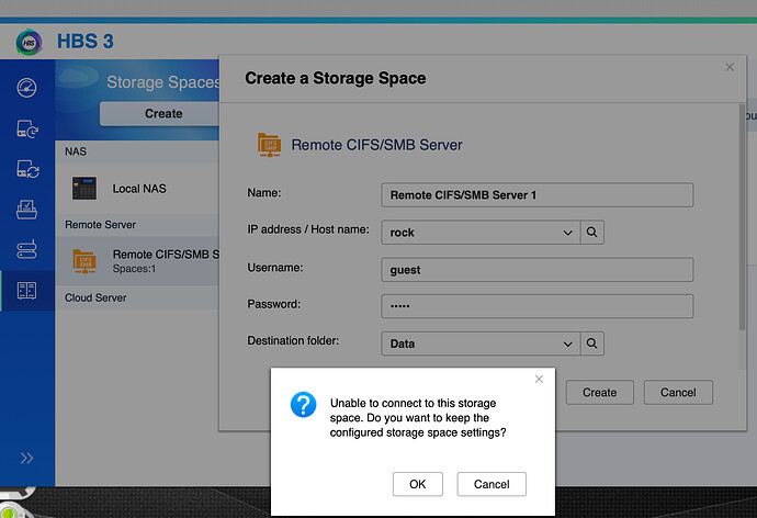

I can’t even create a new Storage Space in HBS3 representing the ROCK:
Hi @Suedkiez ,
Sorry, but RoonOS v3 samba config defaults to SMB2_02 as the minimum protocol version and has SMB1/NT1 disabled. So if the cifs client only supports SMB1/NT1, it’ll fail. Can you share what version cifs returns from the ssh admin shell on the QNAP with mount.cifs -V and modinfo cifs | grep “^version\|smb” to get the version and see if there’s any SMB2 support. Other threads about it supporting SMB1 didn’t go all the way and attempt an SMB1/NT1 connection. I think they were just reporting what the min negotiation capabilities were on both sides. It fails when trying to use just SMB1/NT1 (the first command is listing the README.txt file and the second one is the same but setting NT1, SMB1 dialect, as the minimum and the protocol negotiation fails):
$ smbclient //rock/Data -N -c “ls README.txt”
README.txt                          N      367  Mon Jun 15 16:14:55 2026
$ smbclient //rock/Data -N -c “ls README.txt” -m NT1
lp_load_ex: Max protocol NT1 is less than min protocol SMB2_02.
Protocol negotiation to server rock (for a protocol between SMB2_02 and NT1) failed: NT_STATUS_INVALID_PARAMETER_MIX
If anything changes in future RoonOS builds, we’ll post it in the release notes.

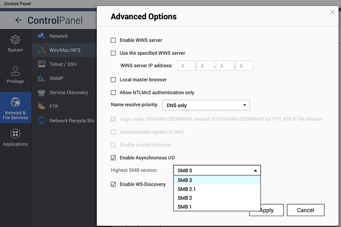

QTS 4.3.4 definitely supports up to SMB v3. This screenshot is for the NAS used as an SMB server, but it wouldn’t support v3 as a server and just v1 as a client:

But it runs Samba 4.4.16, which supports SMB3, and it is enabled (again, the daemon is obviously server-side, but anyway):
[~] # smb3enable -h
**smbd (samba daemon) Version 4.4.16**
**smbd (samba daemon) is running.**
**max protocol SMB 3 enabled.**
[~] # smb2enable -h
Usage: /etc/init.d/smb2_protocol.sh {enable|disable|status} [1|2|20|21|3]
Options:
        disable       - SMB 1
        enable 1      - SMB 1
        enable [2|20] - SMB 2.0
        enable 21     - SMB 2.1
        enable 3      - SMB 3
[~] # smb2status
