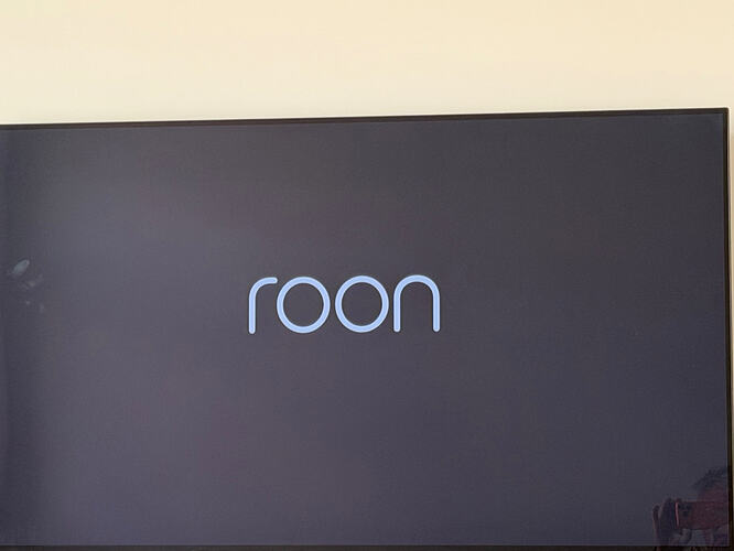

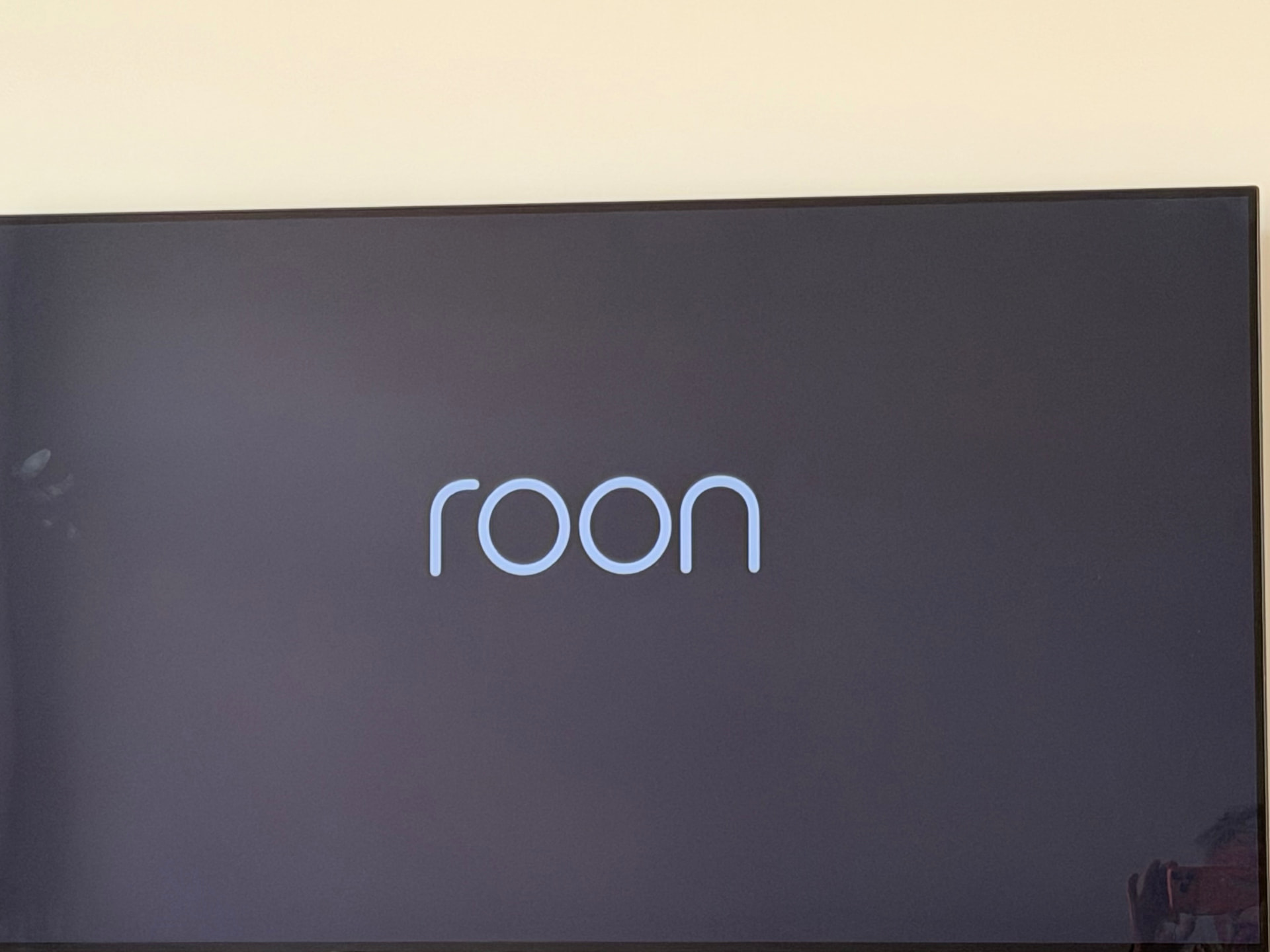

I love that I can now use the HDMI port in my Nuc 10 i7 as a display for Roon/ROCK. Unfortunately it stopped working two times now. My display only displays the Roon logo (see photo), but no album art, etc. After a Server restart the display works again. I do not have to reboot the Nuc, only restarting the Roon service is enough to make it work again.

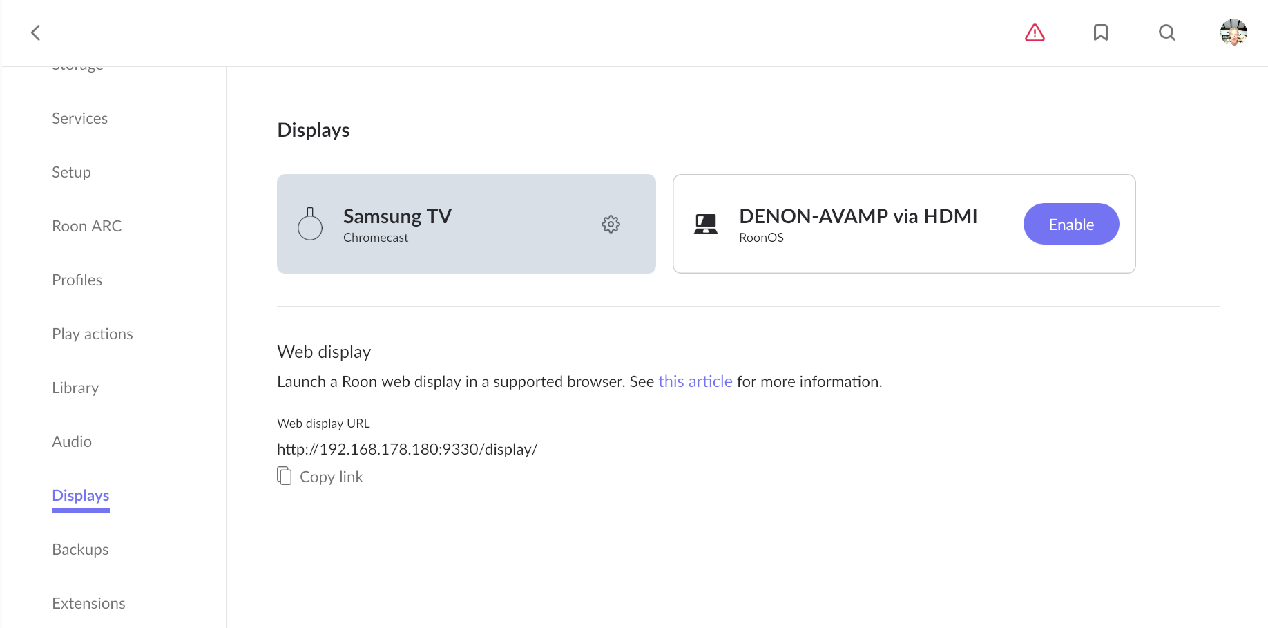

When I installed build 1676, I went to :gear: > Displays and saw that the ROCK/NUC HDMI output connected to my Denon AVR was currently Disabled:
Yet the TV connected to the AVR was showing the Roon screen:
Which raises the question: shouldn’t this show the diagnostics screen when the Display is disabled?

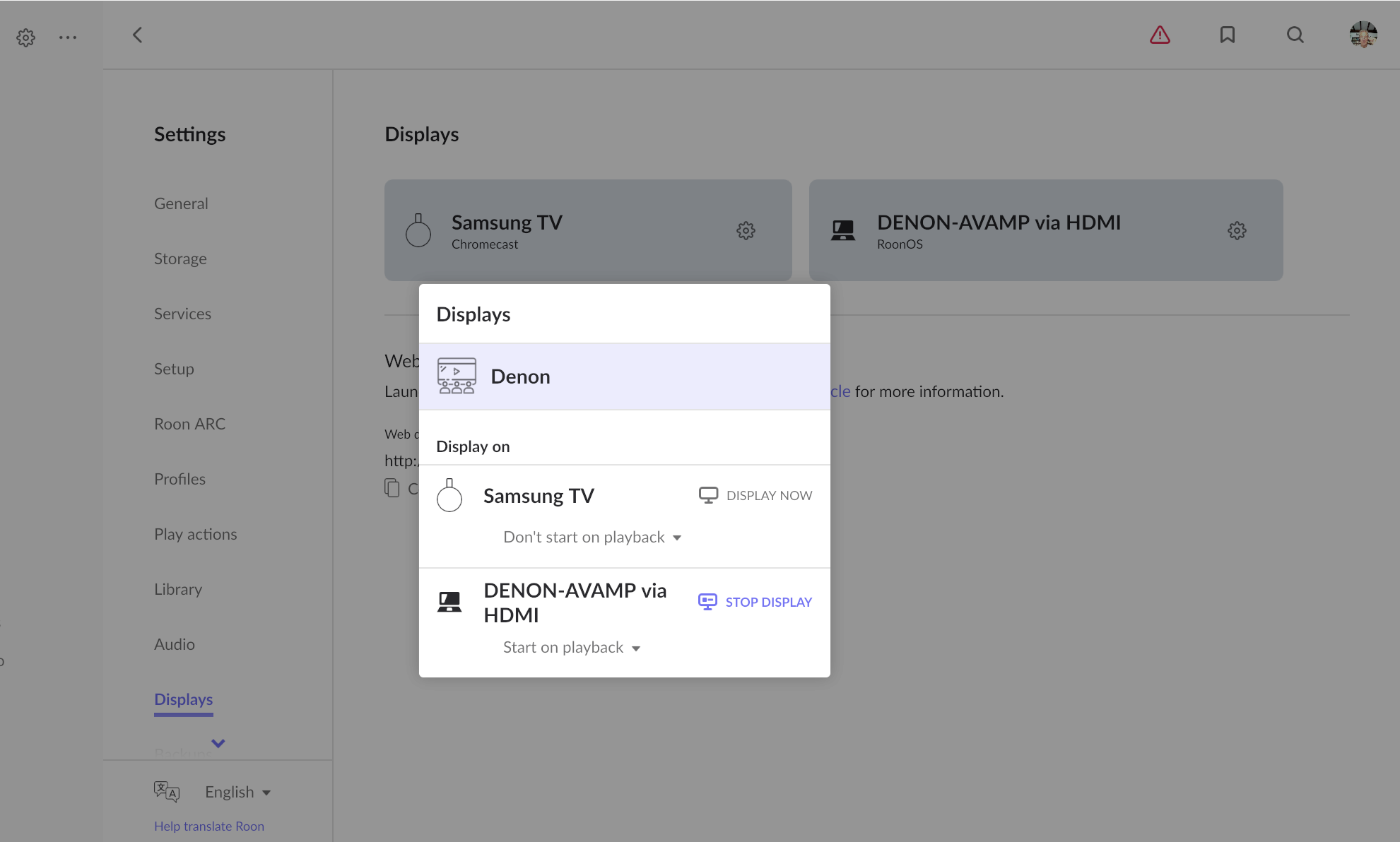

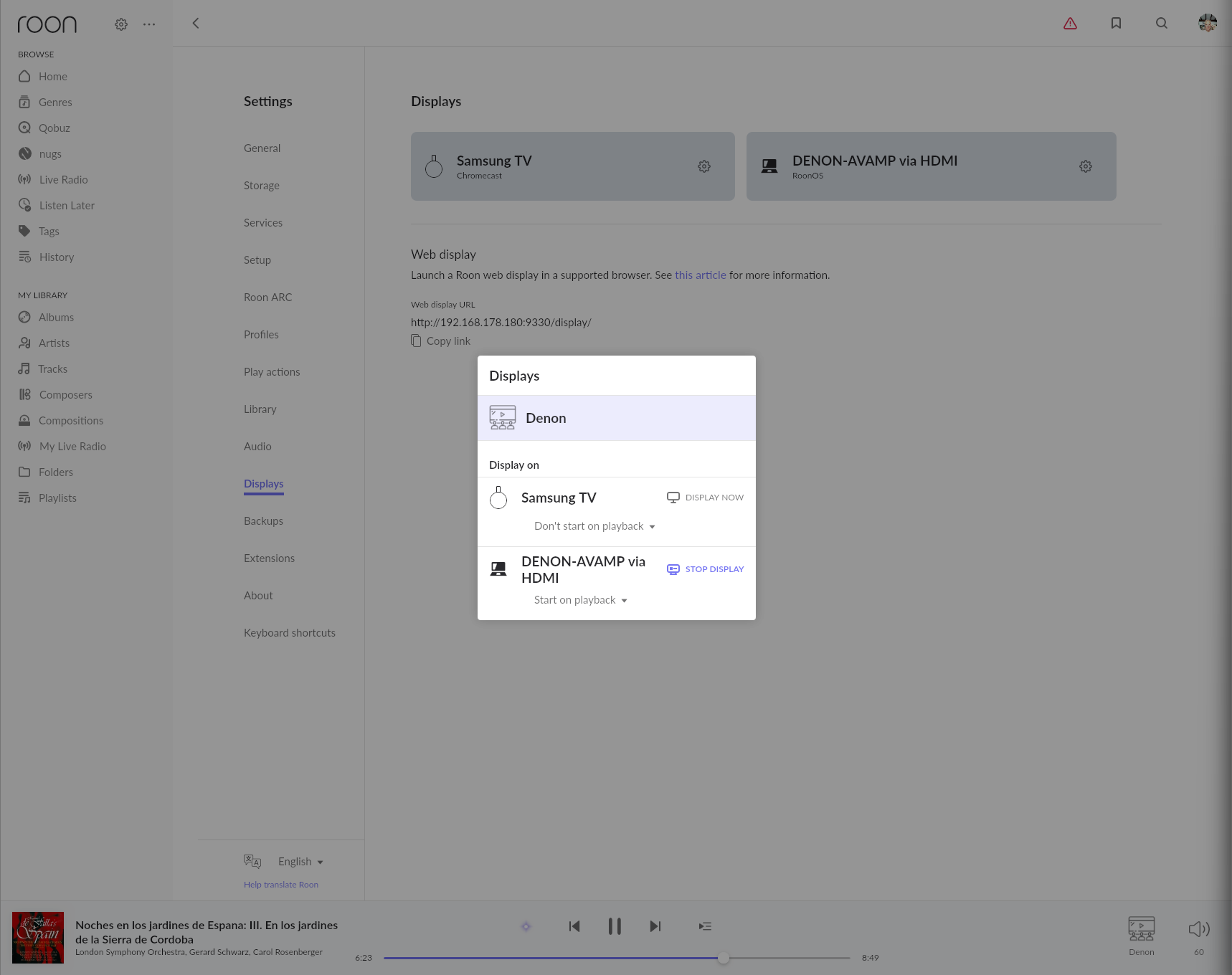

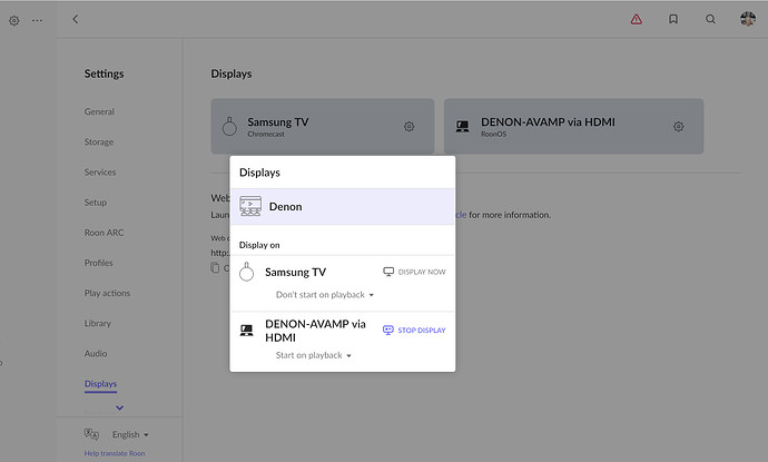

So I then Enabled the Display, attached it to the Denon Zone and started the display:
No change on the TV - it still showed the Roon screen and I was playing something on the Denon Zone…
I tried another Zone with the Display and the same thing - just Roon displaying.
So then I restarted the Roon Server using the Web Administration Interface (not a full Reboot of the NUC) and now Zones are being correctly displayed.

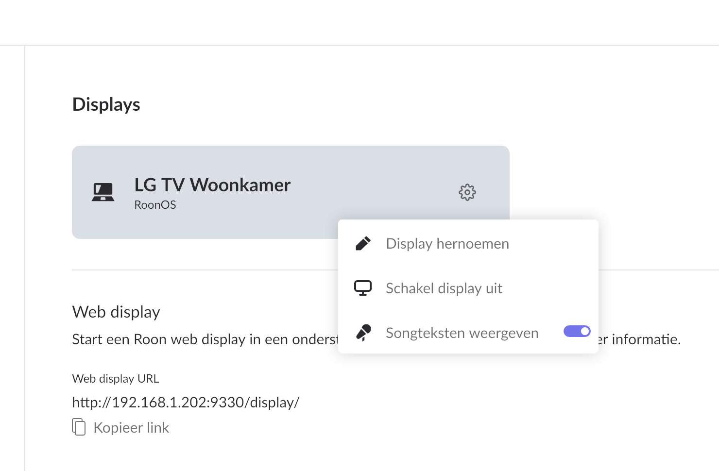

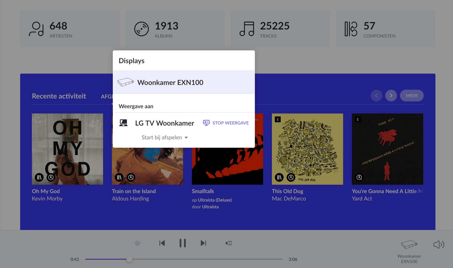

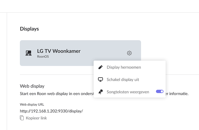

B1676 - I have just connected an HDMI from ROCK NUC to LG OLED. Enabled and named the RoonOS display.
Manually selected the appropriate input and the display looks as I would expect.
However, stop display and disable display do not see to have any effect. The Roon display stays active. I cannot turn it off via the phone app.
I haven’t yet tried reboots yet but I assume I should be able to stop and start display like other displays ?
Following reboot of the NUC the controls now operate as expected.
Is a reboot always necessary here to get full control of the connected display? If so, this should be clear in comms when push to production.
