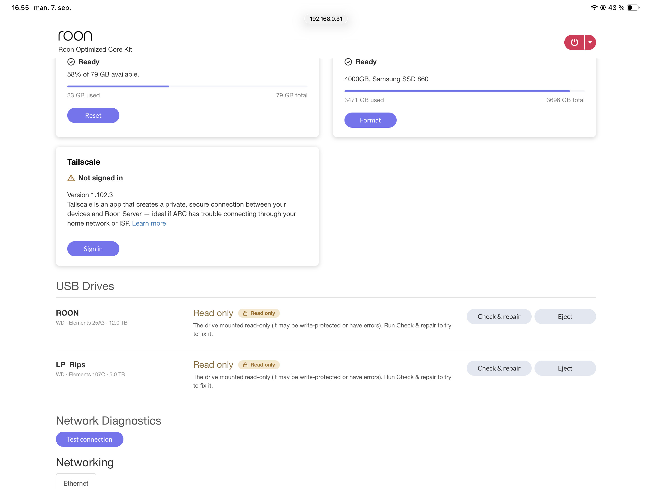

RoonOS 3.0 USB drives says Read only
Trying to copy files from my windows computer to usb drives on my Rock/NUC. this cannot be done after i updated to Rock 3.0. File system is NTFS
What can be done about this?
Does it change if you click “Check & repair”?

It does not change.
Last thing to try is to put the drives back on a Windows PC and run Chkdsk on them. Don’t forget to eject them safely from Windows - don’t just pull the USB cable out.
Sounds like this change in OS 3.0
So, as @Geoff_Coupe said
It’s ok now, after a chkdsk on my computer. I will never touch the check/repair button again!
