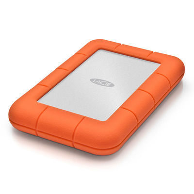

Depending on the age and specs of the mini, you (and your Roon install) may be happier by skipping the NAS and just hooking up one or more external disks for data. I use these guys with my NUC and found them to be quiet (not really important in my case, as all server stuff resides in a separate room) and reliable:
The Time Capsule can be relegated to its native functionality of backing it all up.
