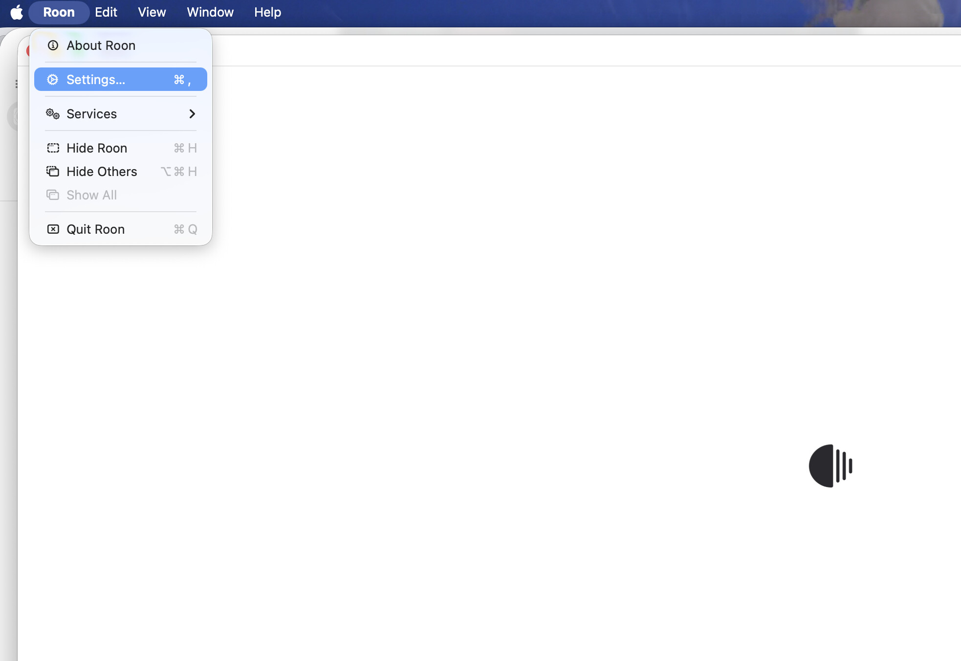

I’m now completely lost. I tried changing the storage location to /Music but kept getting an invalid folder message in the Roon app. So I thought I would try logging out of the server and logging back in. Only I can’t log back in…it’s stuck on the moving Roon logo. And no, sorry, I didn’t take a screenshot of the error messages.

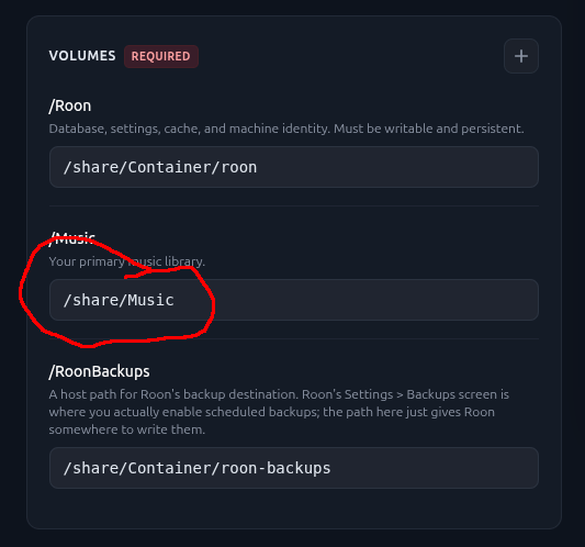

With roon running in a container, which is a closed environment for software within a folder, you cannot just choose a storage path of your liking. You must define the path to the host machine (Your NAS) as a part of creating the container. That is what the second path in docker generator is for. As you have no main folder called /Music on your machine, you must define this anyways.

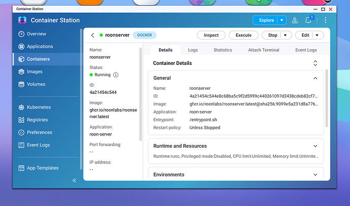

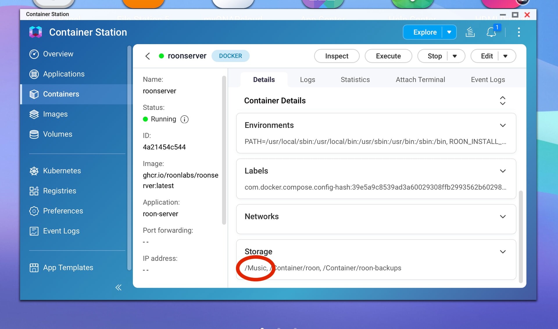

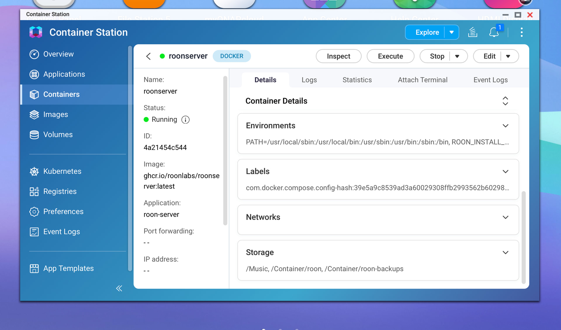

Looks like the container is healthy, but it can only see the music stored in a top-level folder named /Music, being properly mounted as a shared folder on one of your volumes.
If the folder with your files is of a different name, or is not properly shared, roon cannot see it, so the container properties have to be altered.
You would have completed this part of the configurator
Since your container is healthy, /Roon and /RoonBackups appear to be correct. However, it is unclear what you have set for /Music. The default in the image (/share/music) is probably incorrect for you NAS. You need to place the exact path on the NAS in this box. This probably starts with /DataVol1.

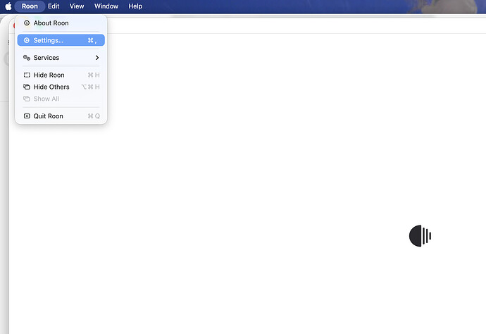

I also can’t figure out why Roon won’t open at all after I logged out of the server. When I try to open it on my Mac (OS Tahoe 26.5.1) or my iPhone (iOS 26.5) I just get the moving Roon logo. Even clicking Roon–>Settings on the menu bar does nothing.

/Music is inside the container and maps to the actual location of your music library.

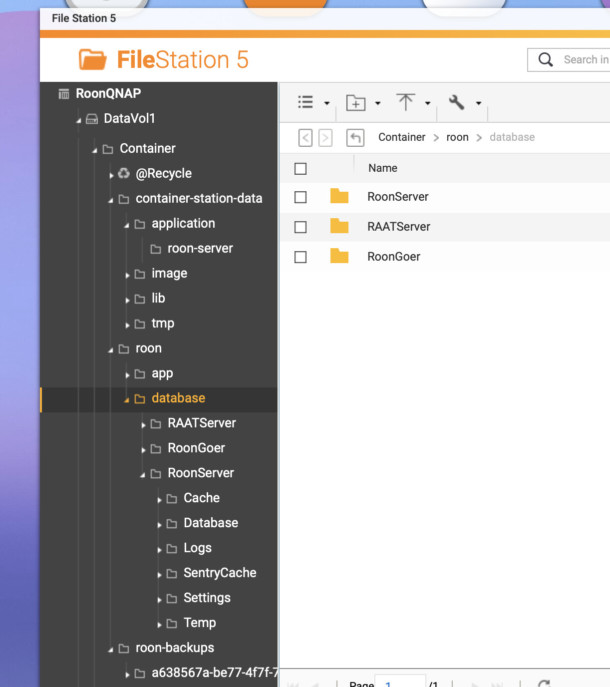

I did find some log files under RAATServer and one from 5/15 (which may have been the day I discovered RoonServer was permanently stopped and I changed to Container) ends somewhat ominously, with a lot of stuff being “destroyed”:

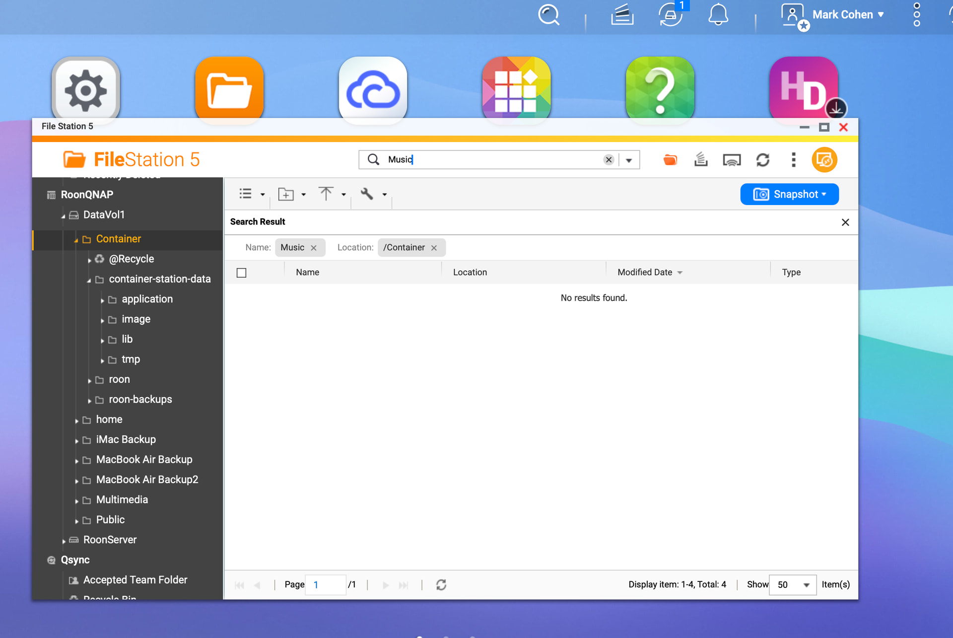

If not, maybe this guide will help you locate your music.
No I didn’t find my library. Thanks for the guidance, but when I search for Music files in Container, I get: “No results found.”
I tried the Recently Deleted folder but it’s empty.
