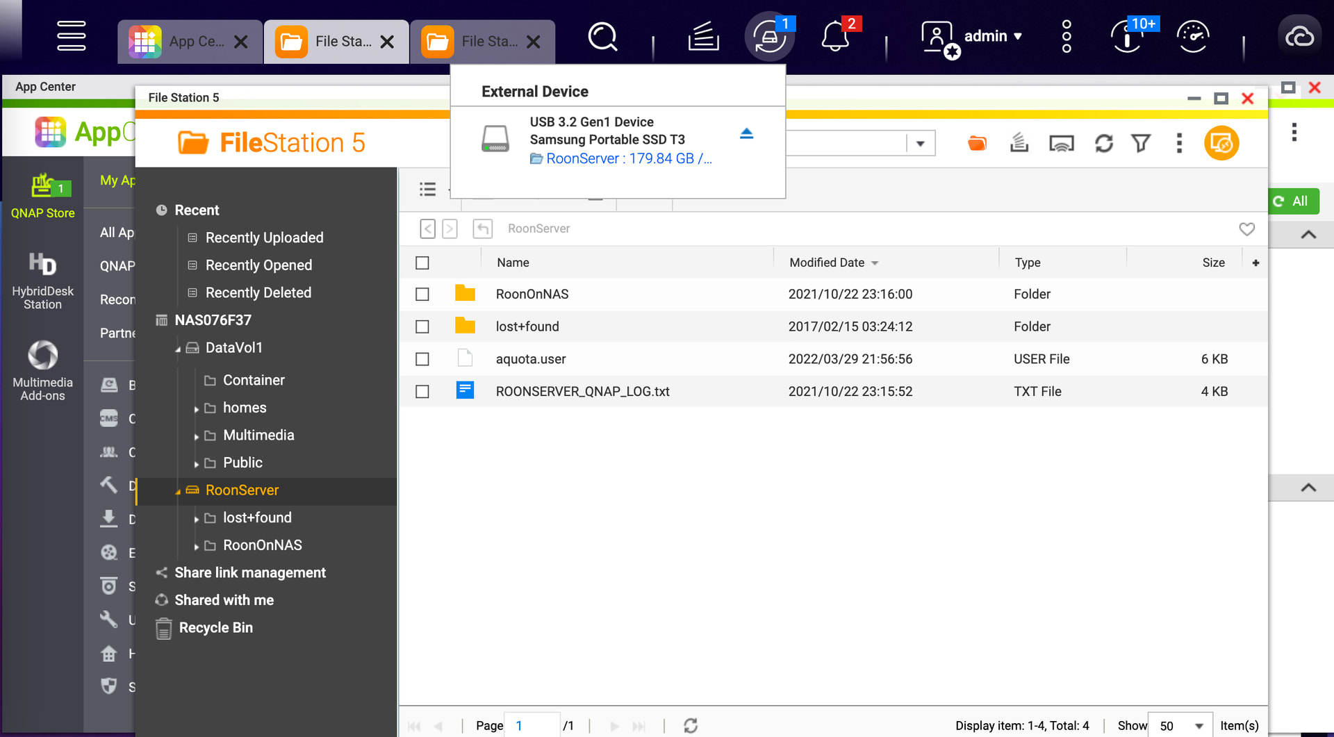

I had been running RoonServer from my QNAP NAS for many years until the most recent update rendered it inoperable. I followed Roon's article "Installing RoonServer on QNAP with Docker" and still have not been able to get it working again. When I open Roon Remote, my NAS does show up and offer to connect but when I click connect nothing happens. When I log in to my NAS and open up Roon Server in the app center, I see that the status is "stopped". I am thinking the problem could be that I had been running my Roon Server from an SSD that is plugged into the QNAP via USB. During the process of installing Container Station, I did not see any way to account for the USB drive. That is, I believe I made an error with the storage mapping, but I am unsure how to fix it.

  • USB Mapping: If you want the new Docker container to store its fresh database on your Samsung Portable SSD, the volume paths in your configuration must explicitly point to that external drive’s mount point in QTS, rather than the default container folders.
To help us correct your storage mapping for the USB drive, could you please share the exact Docker Compose (YAML) file or the configuration settings you used when setting up the container?
