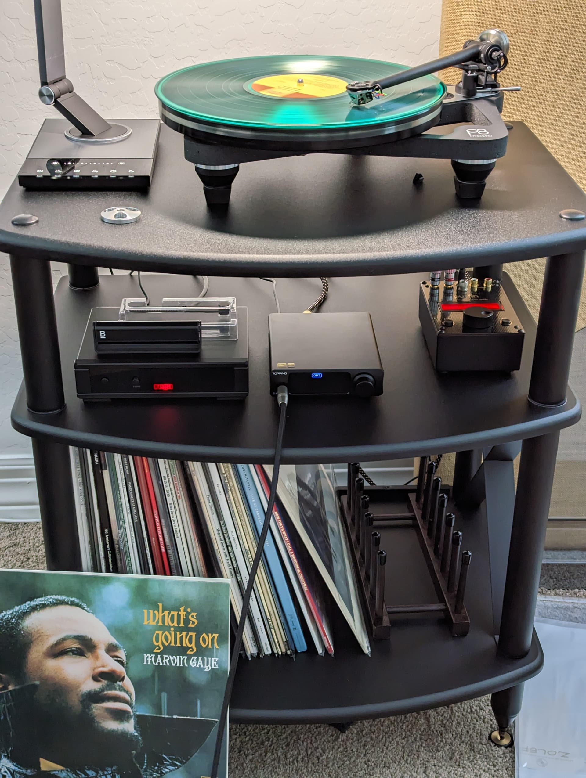

I finally got around to setting up rooPlay in my system. My use case may be a little different from other members. I have a Rega Planar 8 turntable that’s connected to a Parks Audio Puffin phono stage that’s equipped with a TOSLINK S/PDIF output. This runs to the optical input on my Gustard X18 DAC and has been my main way to listen to vinyl playback.
However, I recently built digital room correction filters using Acourate by AudioVero. These 66k tap filters make a great improvement during digital playback via Roon, so I wanted to be able to apply them during real-time vinyl playback also. To accomplish this, I just needed to add a Hifime UR23 SPDIF Optical to USB converter and rooPlay.
Now, instead of selecting the optical input on my DAC, I simply choose the rooExtend radio station. There’s a few seconds of latency from the time that I lower the tonearm to when I hear music, but I’ve experienced no issues with delayed microphonics or echo. After a couple of restarts, the solution has been stable so far. I can even group additional rooms in the house for vinyl sound everywhere. For other zones, I had to add 425 ms of latency to account for delay added by the FIR filters in my main system.
I’m still deciding what I think of the sound quality, but functionality is pretty amazing. I suspect the most difficult part of setup will be finding a Raspberry Pi 4 in the US. Hoping the supply returns to normal in 2023. Cheers.
