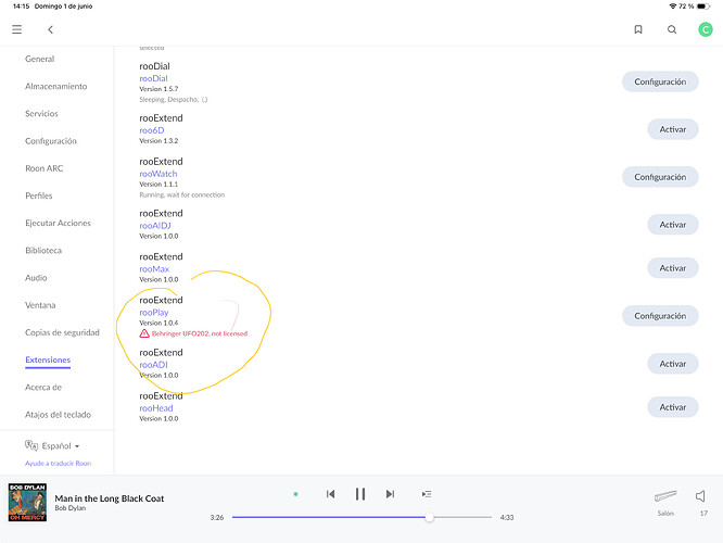

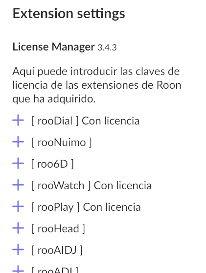

Hi @DrCWO congratulations for this great product! I’m been happily using it for several months, but after an unexpected reboot of my raspberry Pi all my roo licenses disappeared, I successfully reenter rooWatch and rooDial but I can not do the same with RooPlay even though i’m sure the license is correct. Any idea? Thanks in advance

No worries, I managed myself to work it out (I don’t know how…) I just restarted (three times) my raspberry Pi and my ROCK and the license appear back again. Thanks anyway!!
