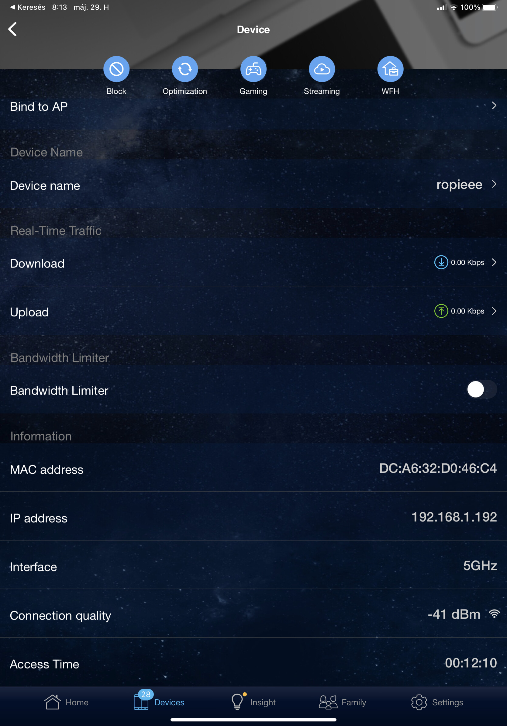

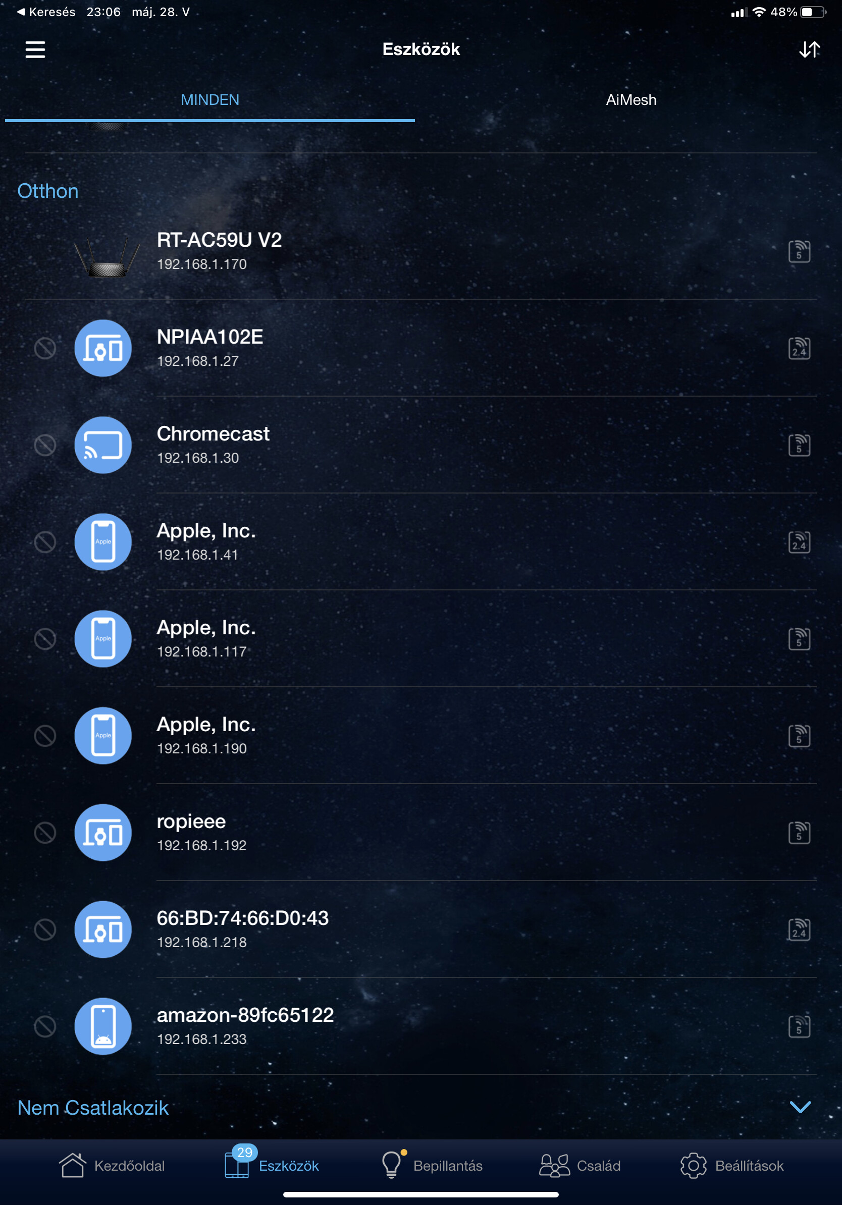

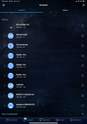

i am not an expert, so I could only check my Asus router device search list as follows:
Another view, clicking on ropiee device:

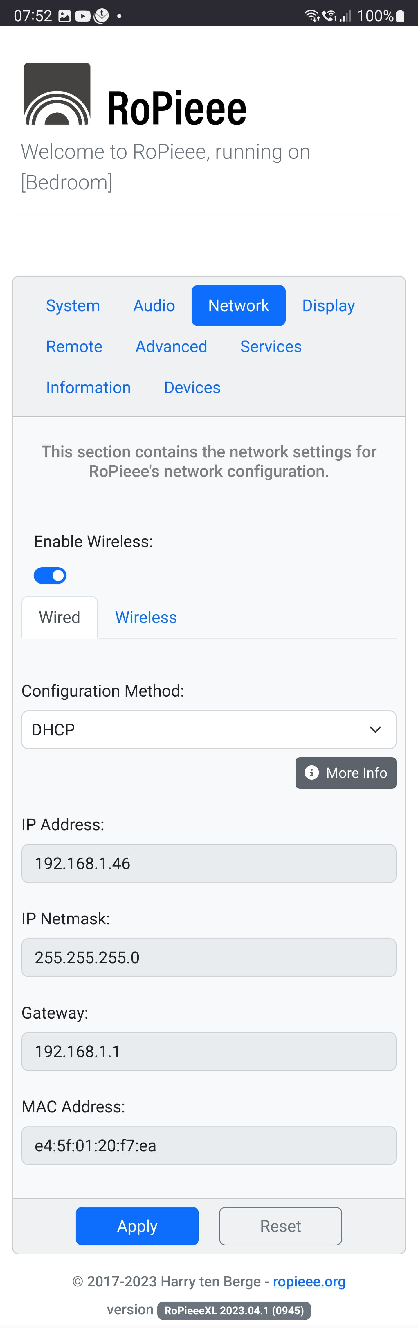

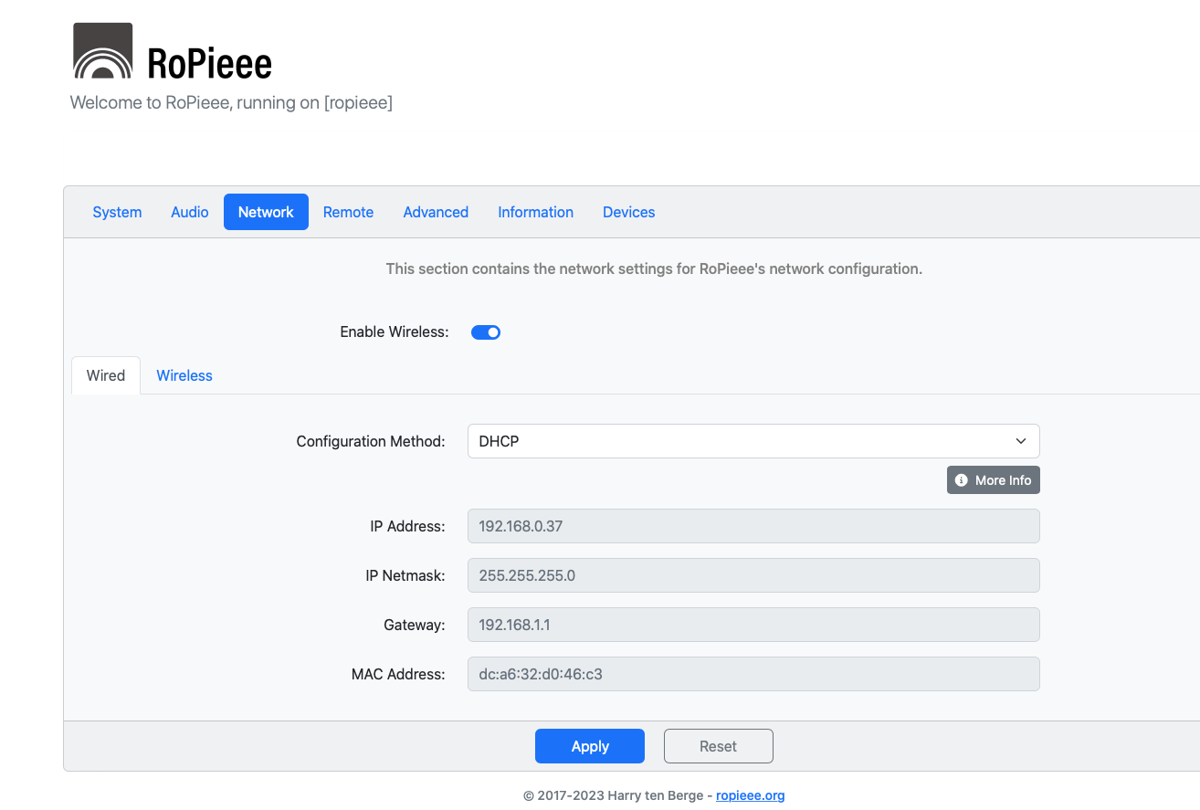

If you log into your RPi via a browser with the wired IP address, then go to Network, Wired/Wireless, there’s a “More info” button. What comes up if you click on that?
Here’s what shows up on mine. The wireless IP address is different to the wired IP Address:

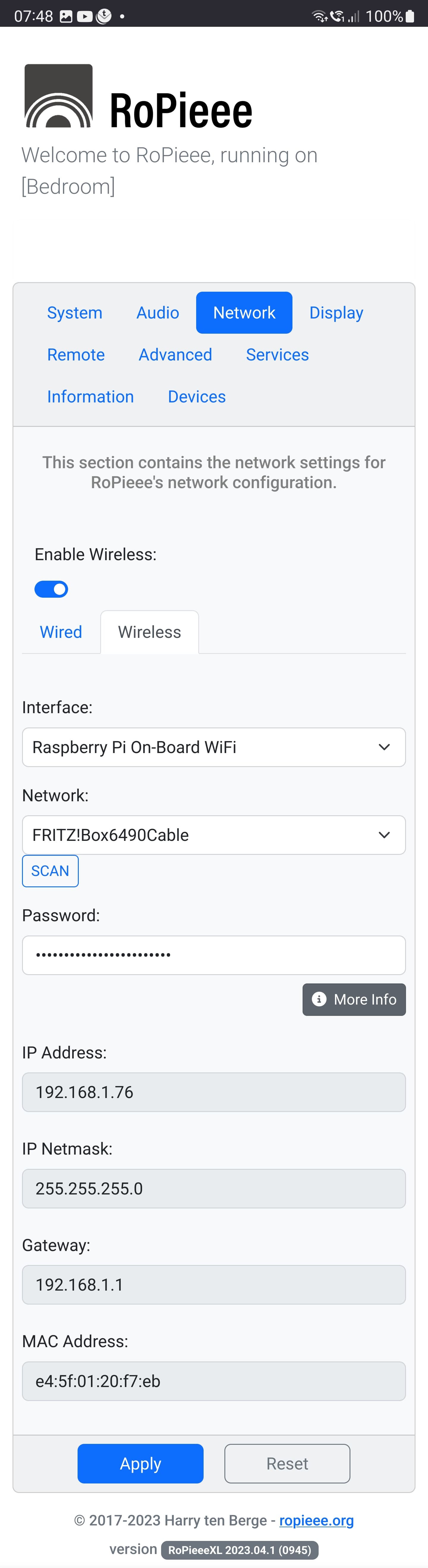

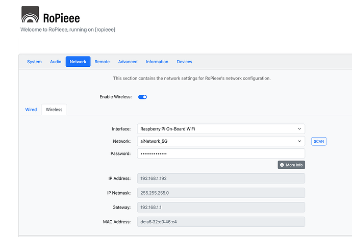

With wireless, you have selected the correct network, provided the password and then clicked Configure to complete the process?
Why are they on different subnets?
That would explain visibility issues…
yes, I did the configuring again, as you have suggested
If they are on different subnets, what should I do?
Before you change anything go to the Settings/general page in Roon and see what IP your core is using.
All endpoints and remotes need to be on the same subnet as the core.
You should be able to adjust this in your router.
