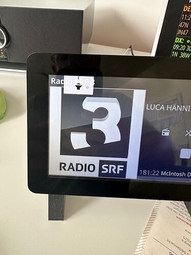

RoPiee Volume Slider on Pi Display 2 displayed vertically (RoPieee 2025.06.1 (2548) [STABLE])
See picture below, how do I set the position of the volume slider horizontally?
Using pi4 and new Raspberry Pi Display 2 and standard image from ropieee.org.

I’d say how did you get it to display vertically? :rofl:

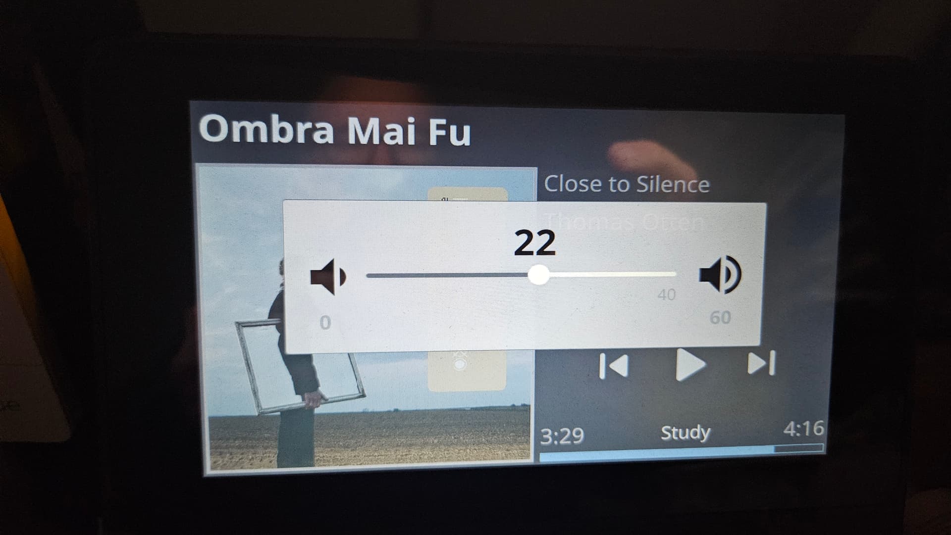

Never seen that before, it’s meant to look like the below. Assume you’ve rebooted?
Hi James, yes I have rebooted. It has to do with the touch matrix on the display. Background display is correct, but Touch foreground id missaligned -90 degree.
Using RP4 and the new Raspi Display 2. Can not see how to change.

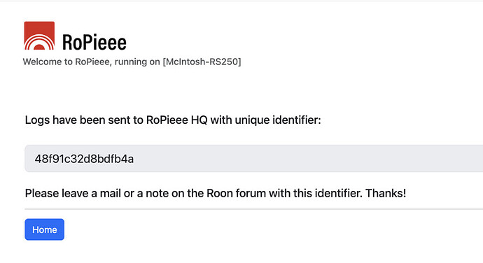

@spockfish asked you to send feedback - go to the Advanced tab of the RoPieee web interface and click the Send Feedback button at the bottom of the screen. Then quote the feedback reference number here for him to follow up…
see here:
48f91c32d8bdfb4a
Kind regards
Peter
