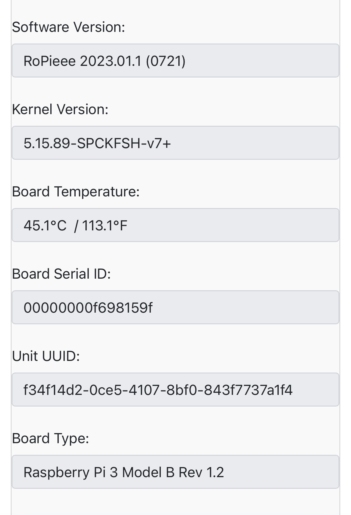

Hi, I’m using the latest Ropieee build on a Pi3 and Hofiberry Amp2 (see picture on details). I’m trying to get Airplay to work with no luck. Anyone have ideas?

Could it be that I mistakenly downloaded standard Ropieee and not XL? Can you tell from the picture with details about the installation? Thank you.

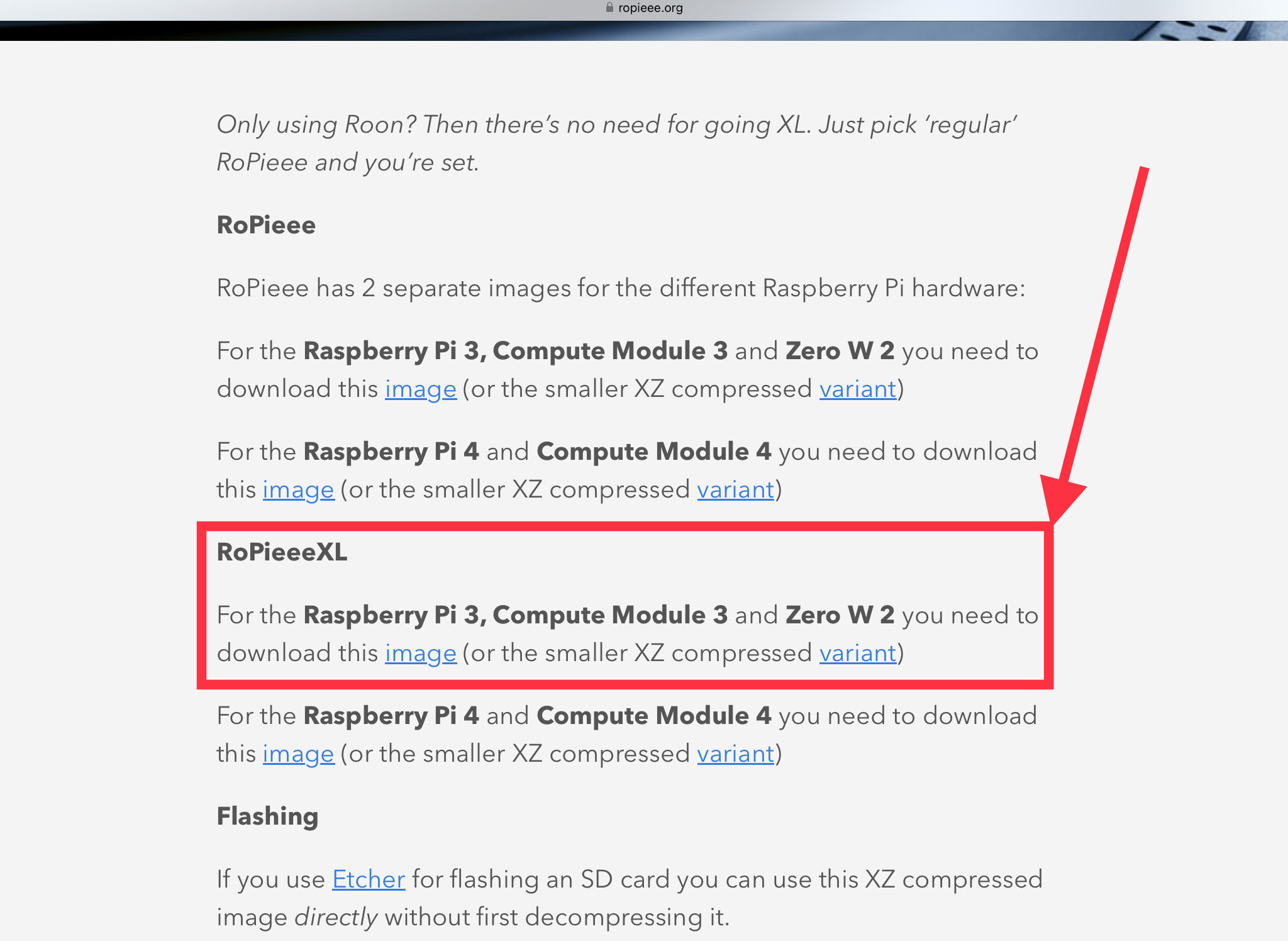

Download it from here
In thought I did so that! That’s why I’m asking whether you can tell from the picture of the configuration page I gave above.
You installed RoPieee not RoPieeeXL
Ah crap. Doh! :roll_eyes::confounded:
