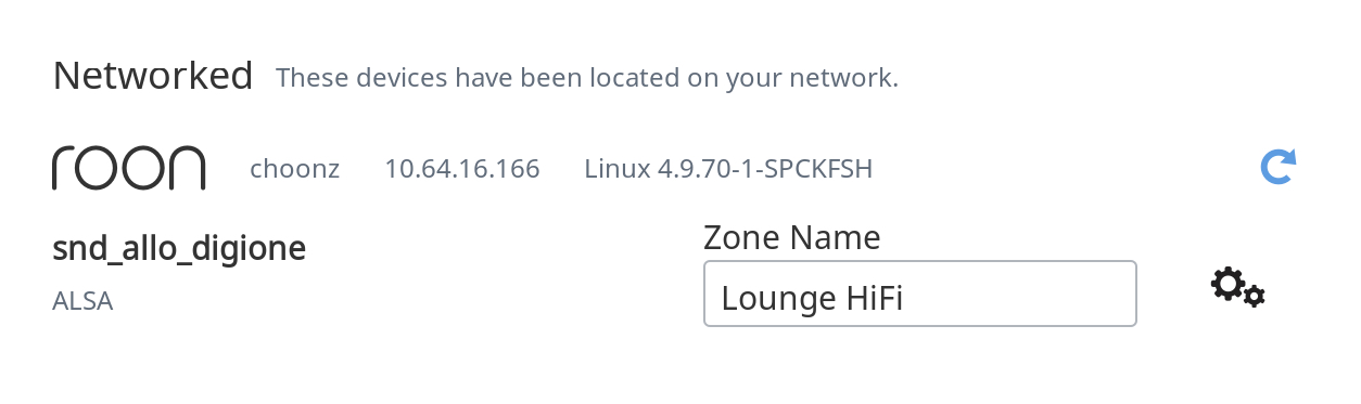

My zone is called Lounge HiFi and it’s consistent on the Pi and inRoon:
I already had the extension authorized but now I removed that authorization. There are no discovered Roon extensions:

I presume that you can play audio out, that the display is the only problem? I assume that you have tried restarting the Roon exension, and your Roon Core, yes? For sure the display will not work if the extension isn’t visible and authorized.
Hi Nathan,
Yes, audio works, and yes to all those various restarts.
