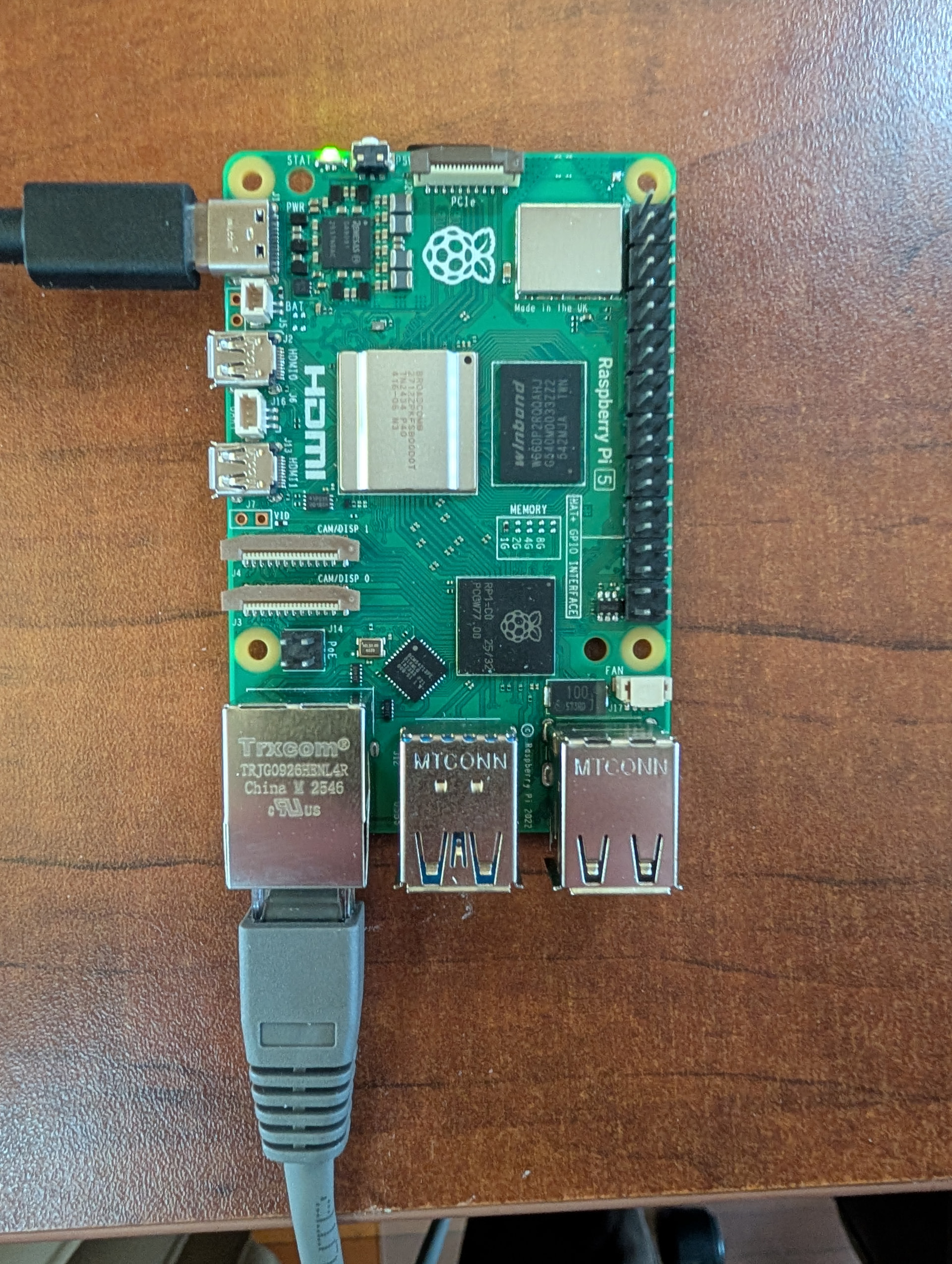

  • Connected Raspberry pi 5 to my network with cable
  • Flashed the latest Ropieee image to a micro SD card (ropieee_pi5-2026.4.0-stable.20260410.3474.bin) with the Balena Etcher and plugged the card into the RPI 5.
  • Powered up Raspberry Pi 5 (with the official Raspberry Pi 5 power converter)
  • I see the indicator light blink from red to green
Waited an hour and the image doesn’t appear to load correctly as it never gets to the slow red/green blink stage and I cant access it at the link (http://ropieee.local). The indicator does slowly blink to red from green, but on a much longer cycle than every second or so). Also, I don’t see the ethernet connector lights flashing (like an installation I have on a Raspberry Pi 4).

When power is applied, the led by the power connector turns on red for about 3 seconds and then turns steady green for about a minute, then turns red for about 3 seconds and then back to green. This pattern repeats. As far as I can tell, the leds on the ethernet connector never turn on.

No, just power and ethernet are connected

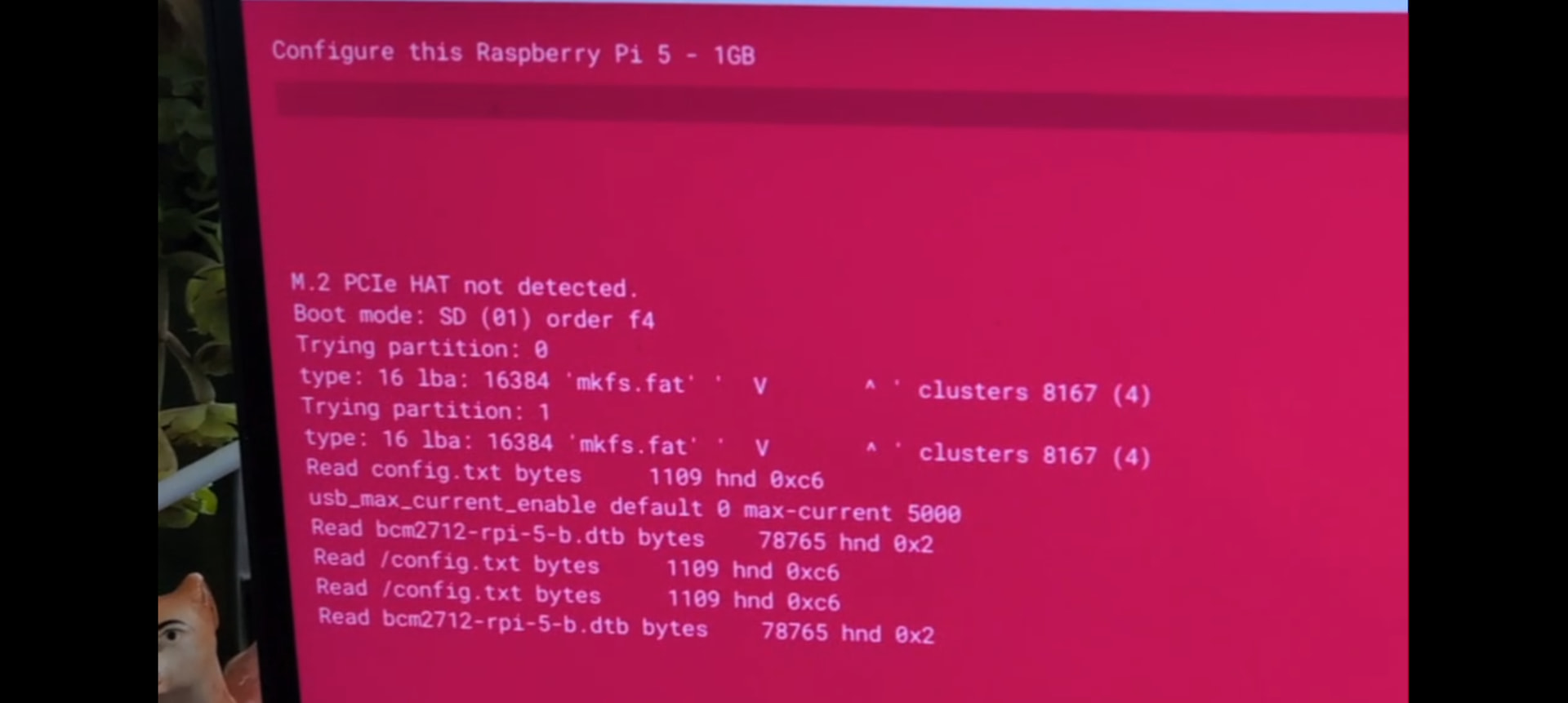

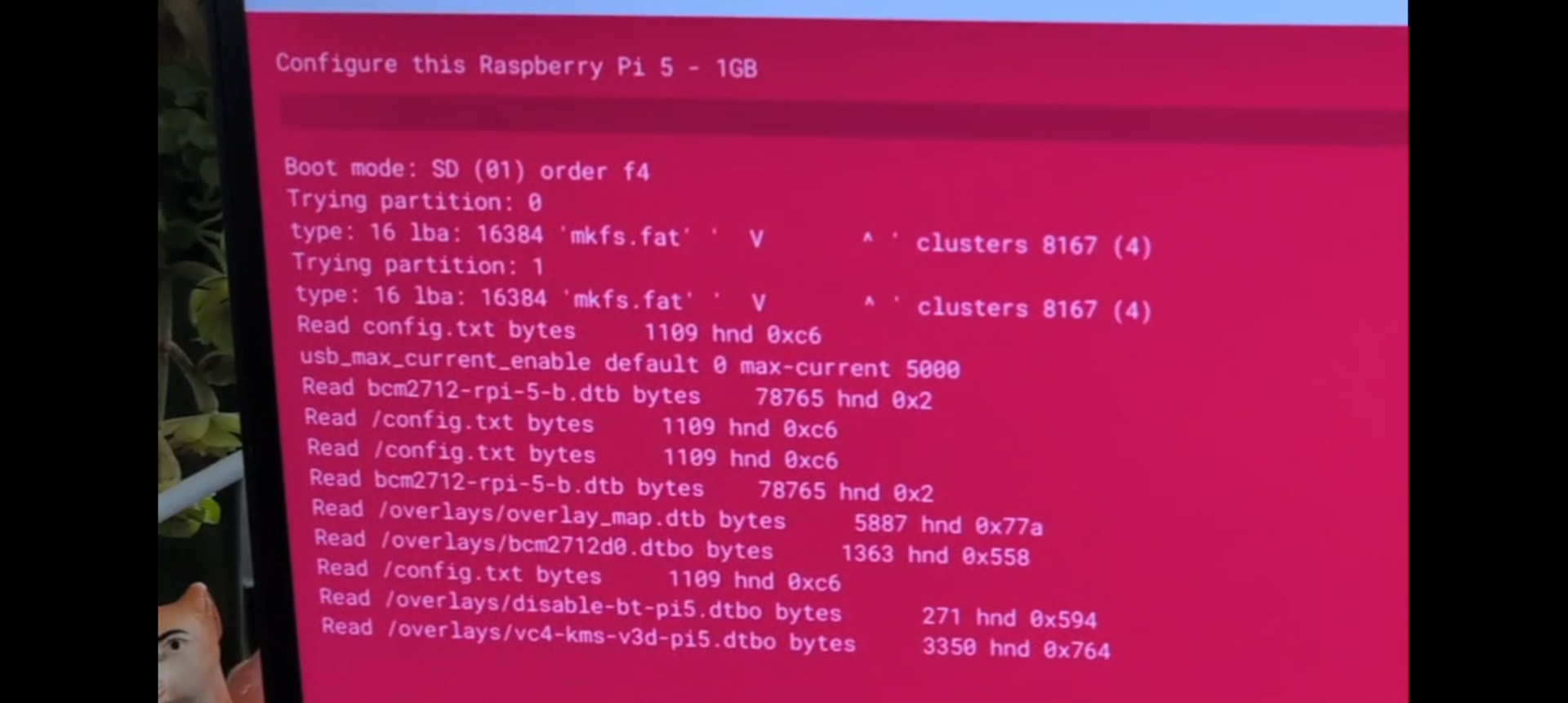

I got the cable and took a couple of screen shots as the text was scrolling up at power up. I got everything that came up in two screen shots that overlap contents. After that screen finished, the monitor was just dark except for a U-Boot submarine in the upper right corner.
Can you try this image:
https://image.ropieee.io/ropieee_pi5-2026.4.0-stable.20260411.3479.bin
