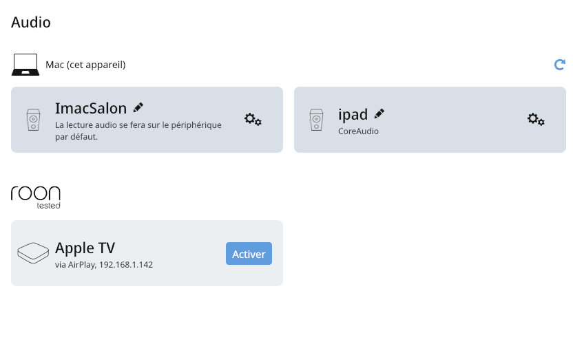

I captured on my IMAC traffic on the LAN and i can see MDNS multicast traffic from the Ropiee so i suppose Roppie seems to advertised itself to the network and Roon should detect it. Rooncore is running on MACOSX Catalina.
Roon detects AppleTV properly but i dont use it for music.

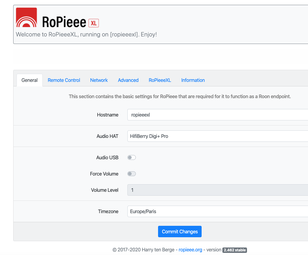

Can you screen shot the ropieee general tab in the GUI?
Here it is !

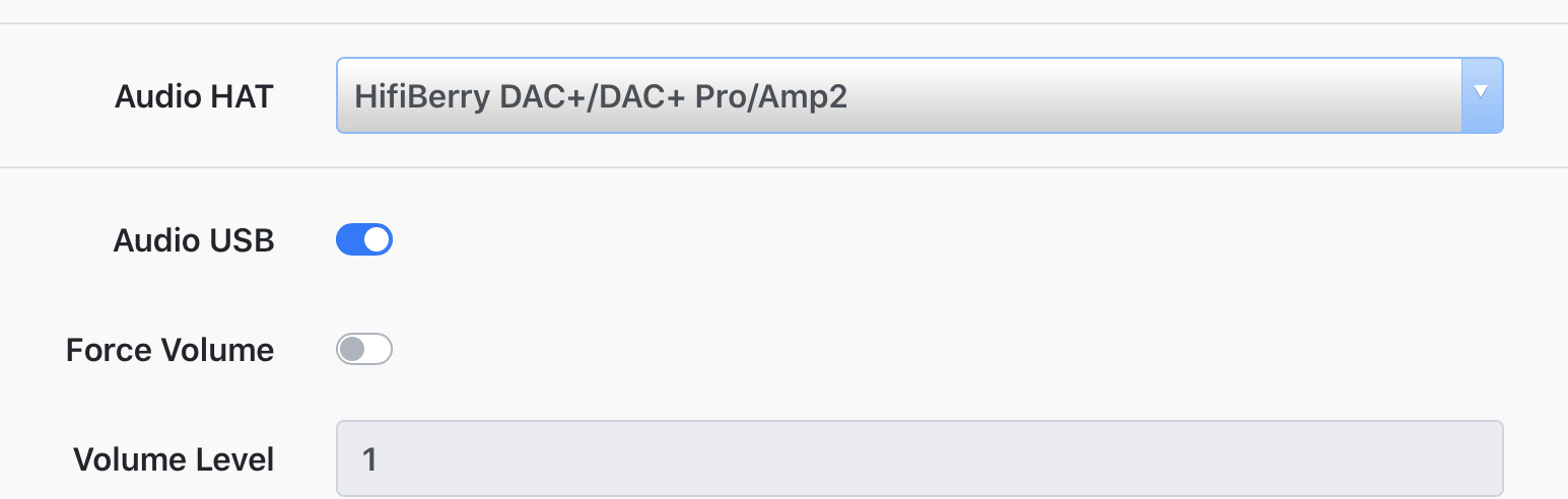

I think you have the wrong hat try this one digi+ is an amp hat iirc
Yeah, the Digi+ Pro is a coax/toslink HAT.
Probably doesn’t want ‘Audio USB’ enabled.
Usb enabled should still work, in case you want more than one dac option like a dragonfly or other usb to attach for some reason Like a headphone rig
It is a HIFIBERRY DIGI+ PRO, i double checked with 1 coax/toslink connections so i think i choosed the right audio HAT in the GUI
https://www.hifiberry.com/shop/boards/hifiberry-digi-pro/
Sorry for the typo i confirm i have a HIFIBERRY DIGI+ PRO :wink: in my Rasp3 and it is workding fine with my dietpi (with rool) SD card

It doesn’t show up in Settings==>Audio?
Here is mine Enabled. Note, I renamed the Host Name to Selene.

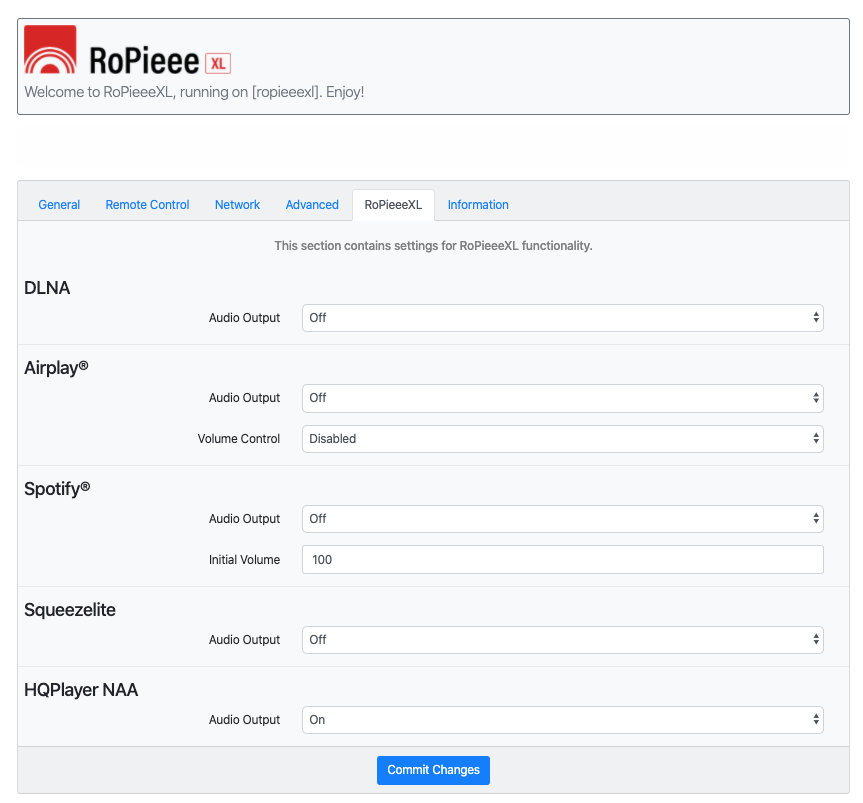

What does your Ropieee XL section say -
I don’t understand this comment.

In my case there is nothing in room in audio section.
Sorry not to be clear, it seems i have the same config than you which is RASP + Hifiberry Digi+ Pro plugged into rasp motherboard
Here is my RopieeeXL config
I would try reinstalling Ropieee and reseat the HAT. It sounds like for some reason Ropieee maybe not seeing the hat so Roon does not. You installed the OS with the HAT already connected to the pi I take it?
You only need to configure it in the main settings for Roon, which you already did looking at you images. Did you apply it and reboot as it prompts you after doing this? Any changes in Ropieee need to be saved and device rebooted to take affect. The other options under Ropieee XL for Spotify etc have no effect on the Roon side it just tells Ropieee which DAC to use for as you could use a 2nd DAC via usb for those.
