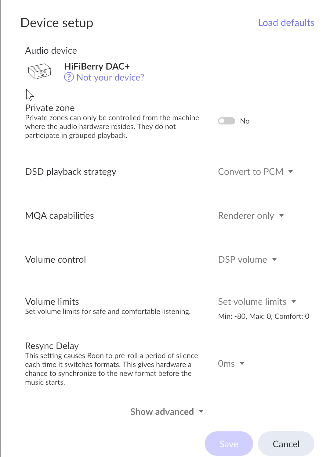

Roon Settings - I am suspicious of the disconnect between the audio device here and the selection in HiFiBerry. But that doesn’t seem like it would impact the optical output. Seems like it should either be active or not.

Could you share the advanced setting in your Roon device setup?

Here are my settings:
