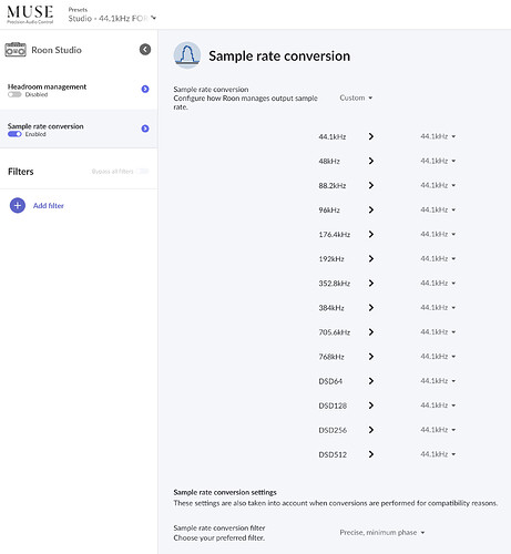

I decided to not invest for now, but create Muse presets with forced SR conversion within the Roon ecosystem. One for every Master SR I use in my DAWs. Does the trick nicely so far.
