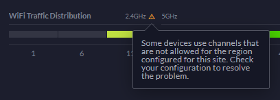

A few days ago I noticed this warning on the UniFi dashboard
grafik
When checking the 2.4GHz connected client list I saw that the RaspDAC client (=RoPieee) is connected with Channel 0 which I never saw before.

Update regarding the OT: The Channel 0 problem seems not related to RoPieee… I saw some other devices (Android) displayed as “connected via Channel 0” as well… after changing the AP to a specific channel RoPieee connected to this channel and the view in my UniFi management was correct (before that I was using an Auto setting which should select the channel with the least interference)
