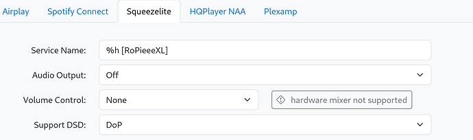

Even if Squuzebox supported DSD it would be perfect for me :slight_smile: Why didn’t I discover this earlier, I wouldn’t buy a HAT for my Raspberry Pi :wink:
It does:
Do you see the last option? :wink:
Ok, but this will be work by UPnP Bridge? Right now I connect RP to Router by wire data are pushed to my Yamaha by Bridge
No. Squeezebox is meant to be used in cooperation with LMS (the server side component). In that setup you can use DSD. With the UPnP Bridge you ‘bridge’ Roon to UPnP, by using Roon’s native support of the SlimProto protocol. However, it does not support the protocol extensions that makes it possible to use DSD over SlimProto, these days.
