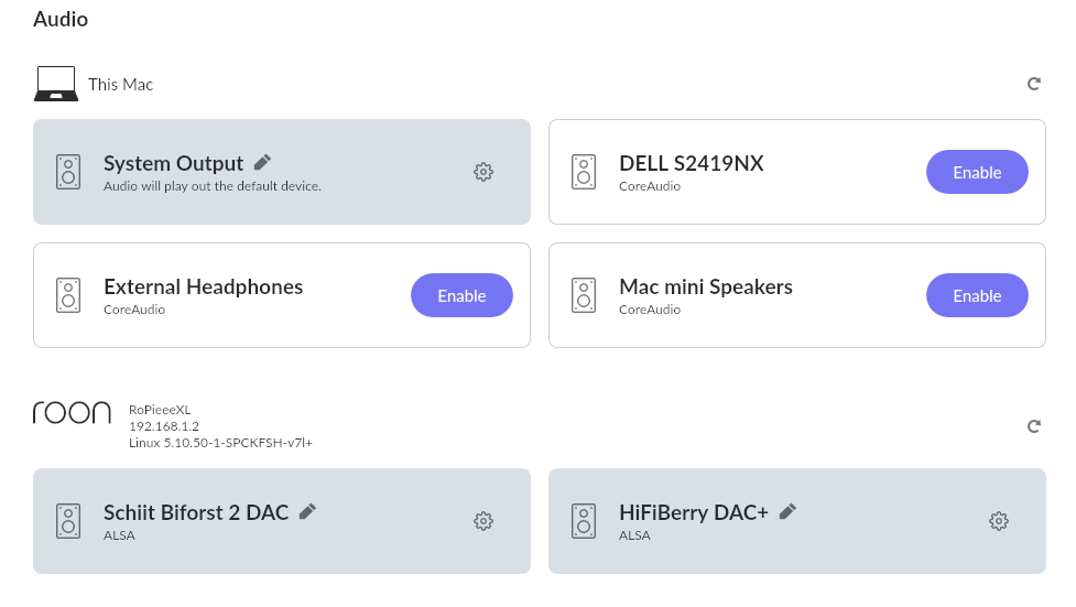

Hi all,
I got a Schiit Bifrost 2 today and connected it to my RPi4 via USB running RopieeeXL. I enabled USB Audio in the RopieeeXL configuration panel and have restarted both devices several times. I don’t see the Bifrost USB Dac showing in Roon anywhere and I’m not getting any sound output. I do also have a RPi Hat (HifiBerry XLR DAC) which I’ve been using for a year, but can’t get the Bifrost to work. Thoughts?
  1. The device itself certainly works – my macbook recognizes it directly and outputs sound through it
  2. Have trialed a few different USB cables without any luck
Here’s what my devices page looks like:
Thanks in advance!

Do I need to get rid of the spaces in my SSID, or just re-setup with a fresh flash?
I really appreciate your help – I would have never thought about an SSID…
No I suggest a reflash, but make sure you download the latest RoPieee image.
Working on that now – will report back!
I would have never in a million years thought it was my SSID – I may have tried a reflash eventually :wink:
Thanks so much for your help.
Hmm – well since reflashing and getting it going again it’s cutting in and out every minute or two – the whole RPi/Ropieee with the Bifrost and HifiBerry will just disappear out of Roon then pop back in without me doing anything about 30 seconds later.

Great, it’s up and running now. I’ll let you know how it works out. Thank you so much for all of your help and for the great software you’ve created and distributed free. I sent a small donation your way so you can have dinner on me. Cheers.
Hi again, wanted to check in and say that since the beta update everything has been rock solid and I haven’t had a single issue with the DAC or the wifi dropping out.
