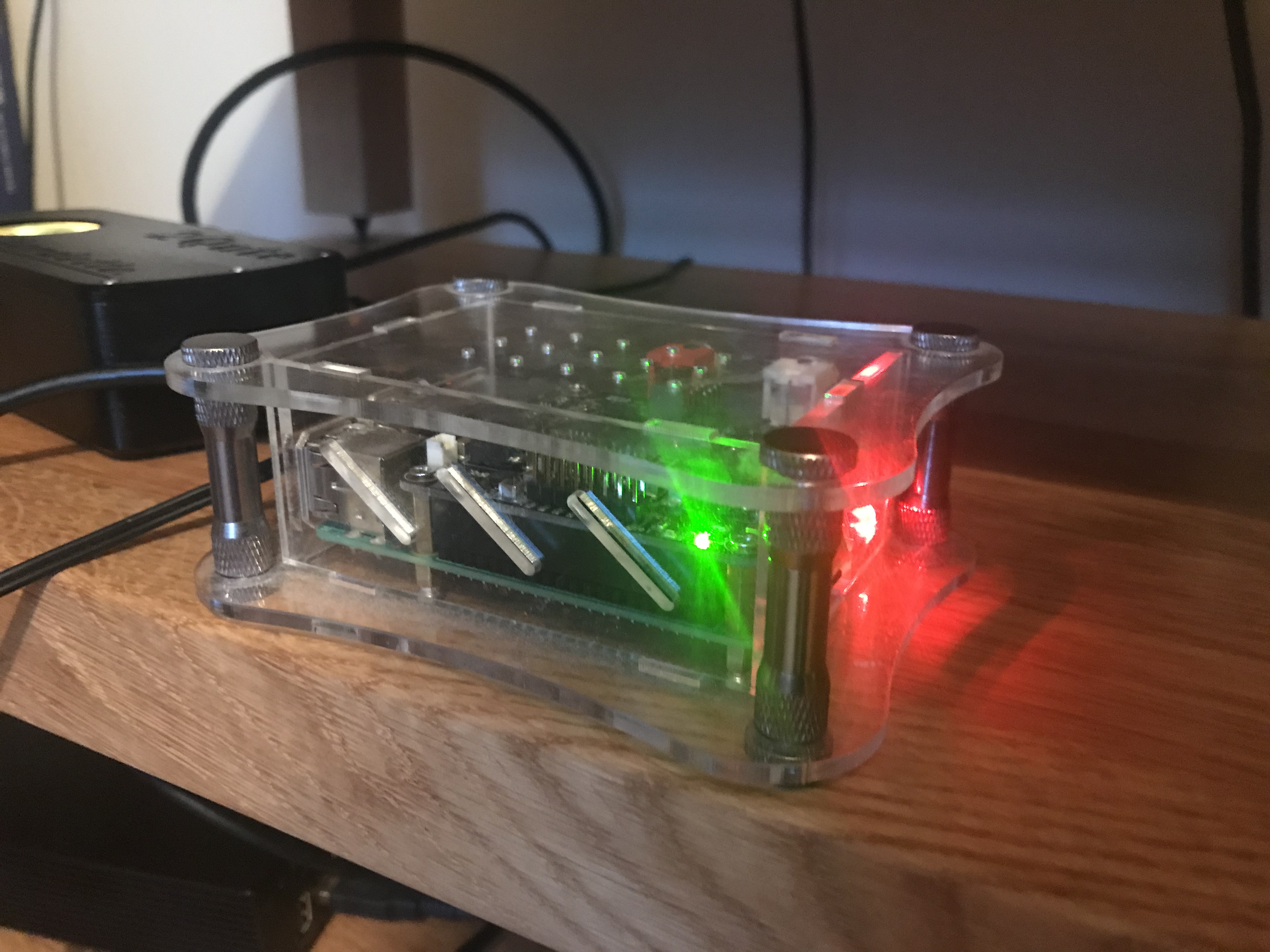

So I transferred to the bedroom zone , wireless rpi3/boss/ropieee. But whenI got upstairs and turned on the amp the zone was no longer visible. I couldn’t access Ropieee on the network, and the 2nd green led had stopped flashing, it was just solid colour. Powering on/off didn’t help, remained solid colour.
This morning I have reformatted (FAT32) and reflashed the microsd card, plugged in a Ethernet cable and tried rebooting. But I’m getting nothing, just one green led now, the 2nd isn’t coming on, certainly no fast flashing to indicate installation. I have tried with a different card, same result. I’m at a loss as to what to do now, If anyone has any suggestions that would be great?

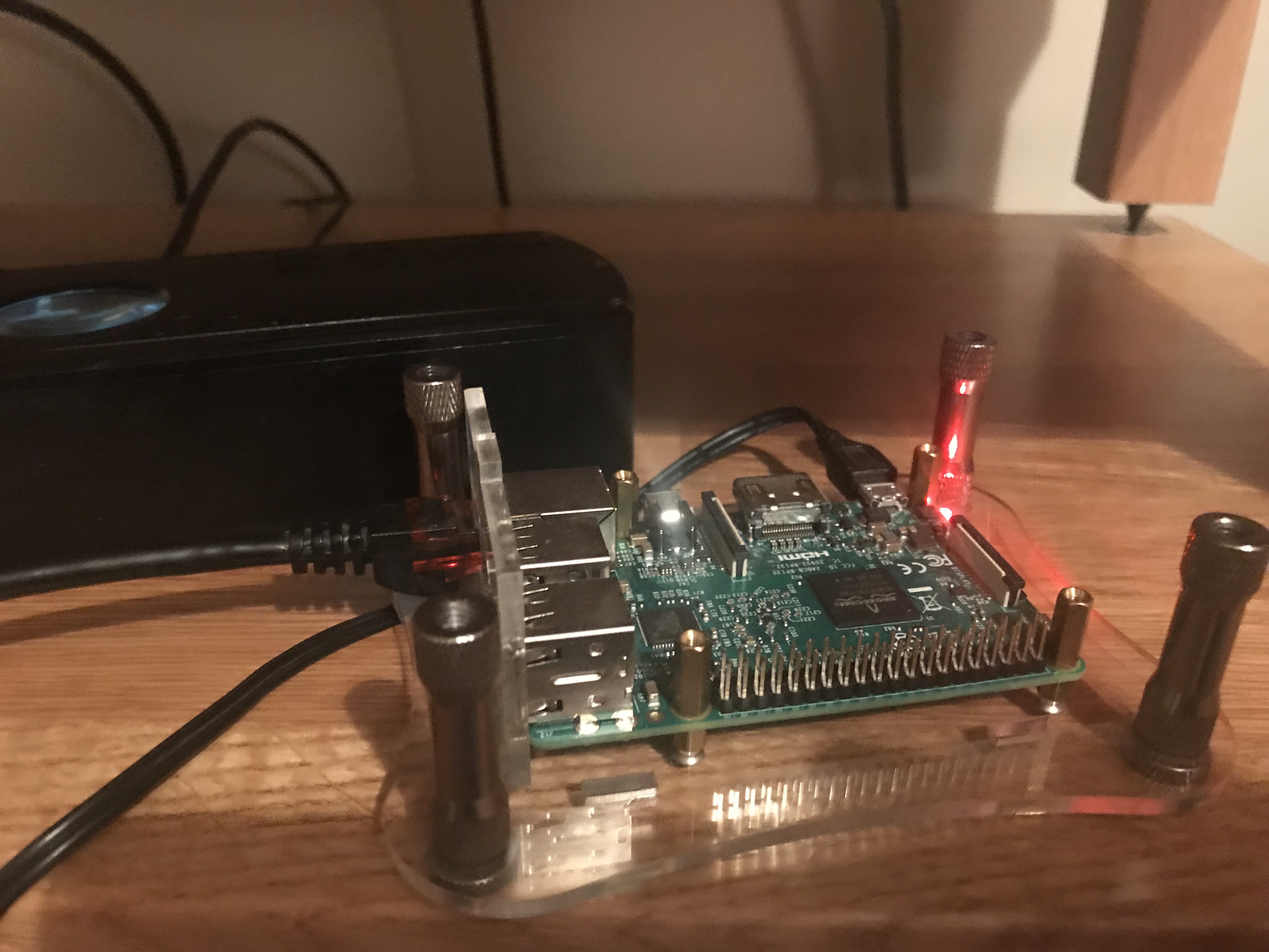

So I’ve bought a new 16gd Sandisk microsd, flashed latest Ropieee using etcher, put into RPi (w allo Boss) and turned on. No flashing lights, one green at front and red where power on. No light on Ethernet.
Has it died? Do Pi’s die, and if so why?!

can you remove the Allo Boss and try again? it sure sounds like it died :frowning:
Hmm, no joy…just power light.
