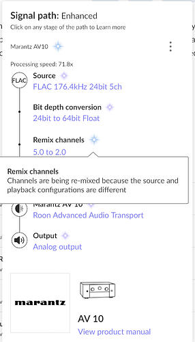

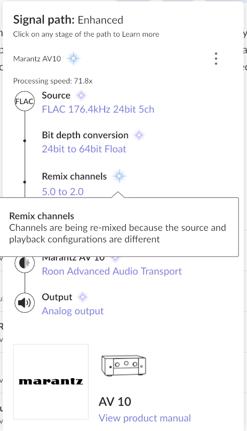

Finally figured out how to get SACD into roon. I copied the 5 channel input but when it plays through my Marantz AV10 is shows as two channel. See below. How can I configure to obtain 5 channel sound? Thank you.

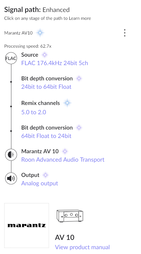

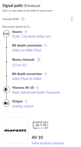

It says source and playback configurations are different. How would I change these to match so that I get 5 channel.
You are sending the music stream to the Marantz using RAAT (Roon Ready). It is likely that this transport only supports two channel audio (This is true of the vast majority of network enabled AV Receivers and Amplifiers - including all HEOS devices). This is why Roon is defaulting to a two channel setup and probably not letting you change it. Roon is limited by the capabilities of the endpoint device with respect to the chosen server to endpoint transport.
If you wish to achieve a multichannel transport, you will have to connect your Marantz AV10 to your Roon Server machine using HDMI. You should, then, be able to configure the HDMI endpoint zone to use a 5.1 channel setup.
Alternatively, if your Roon Server machine does not have HDMI or is too far removed from your Marantz to be able to use it, there are a very few network players that support 8 channel RAAT transports. The Eversolo series starting with the DMP-A6 come to mind (from memory of other reports on these forums).
You also extracted the files to 176.4khz pcm instead of DSD.
Keep in mind, sending native DSD streams via HDMI to your AVR is possible but by no means directly from a device running roon server or ROCK. You’d need to enable DSD to PCM conversion in roon here.
But as said before, there are a few devices like the DMP-A6 accepting multichannel PCM and DSD via RAAT/Ethernet, sending these natively to AVRs via HDMI.
