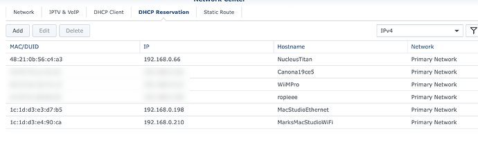

Right. What does the next tab over look like? (DHCP Reservation)
@DDPS - thanks. I wasn’t able to edit the names in the DHCP Client tab (only ‘DHCP Reservation’), though…
And I now have both in Roon:
Great. And fyi, you can refer to those by name rather than IP address anywhere on your network now. as in: \\MacStudioEthernet\RoonBackups.
That way, if you ever get a new device or want to point to a new location, you don’t have to touch any end-user software; you just update the mapping there in your router software.
Many thanks, again, @DDPS!

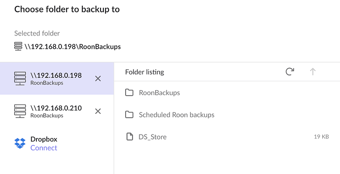

Should I be doing that (name not IP address) in Roon’s Settings > Backup > Select Folder > ‘Choose Folder to backup to’ etc?
I see. Yes. Of course.
Would you expect that page in the Synology RT6600ax SRM only to allow edits (in this case to change names) in the ‘DHCP Reservation’ tab?
Yes, and that is the sort of thing I do as well!
Yes.
Great. Thanks, @DDPS; have changed.

  1. Consolidate your backup share. Roon currently has several overlapping backup targets saved, the old \\192.168.0.210, a \\192.168.0.198, your new \\MacStudioEthernet, and a \\MarksMacStudioWiFi one. The single scheduled backup that failed in this window (July 15, 14:01 PDT, QuotaExceeded) was pointed at the WiFi share, which is the unstable one DDPS flagged. I'd remove every backup location in Settings → Backups except \\MacStudioEthernet\RoonBackups, and repoint the scheduled job there too. That eliminates both the WiFi-address instability and the stale entries in one go.
  2. Retire the old "Scheduled Roon backups" folder. That's the one still hitting the retention/prune limit, your main RoonBackups folder is pruning healthily ("found 9 backups… deleting 0 excessive"), but the old scheduled folder keeps tripping QuotaExceeded. Point the scheduled backup at a fresh, empty folder on the Ethernet share and let it start clean.
