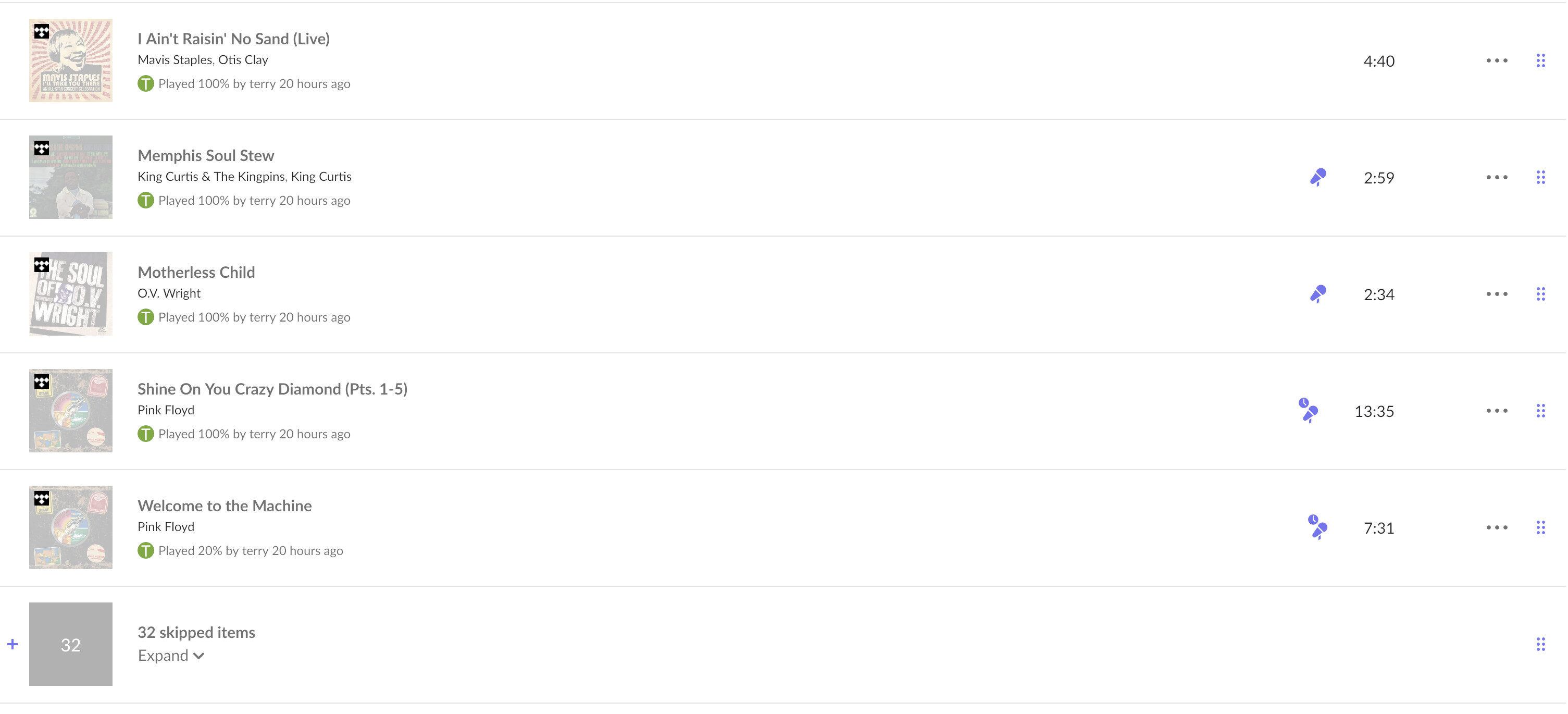

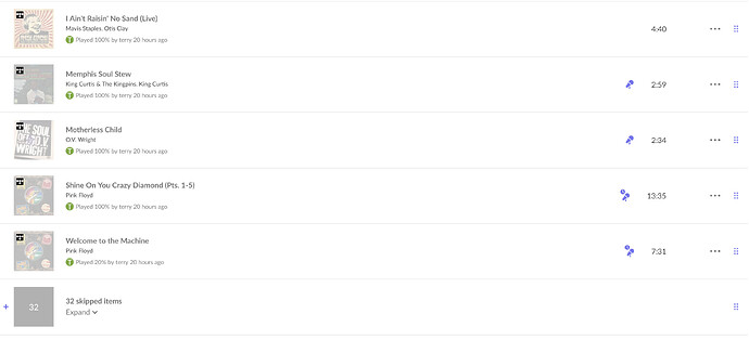

i recently submitted a ticket for a similar problem, and was assured the matter would be worked on…
i’ve now had a long series of oddly selected repeating songs. There was a series of 32+ Pink Floyd songs that were - inexplicably - played after my Memphis Soul songs.

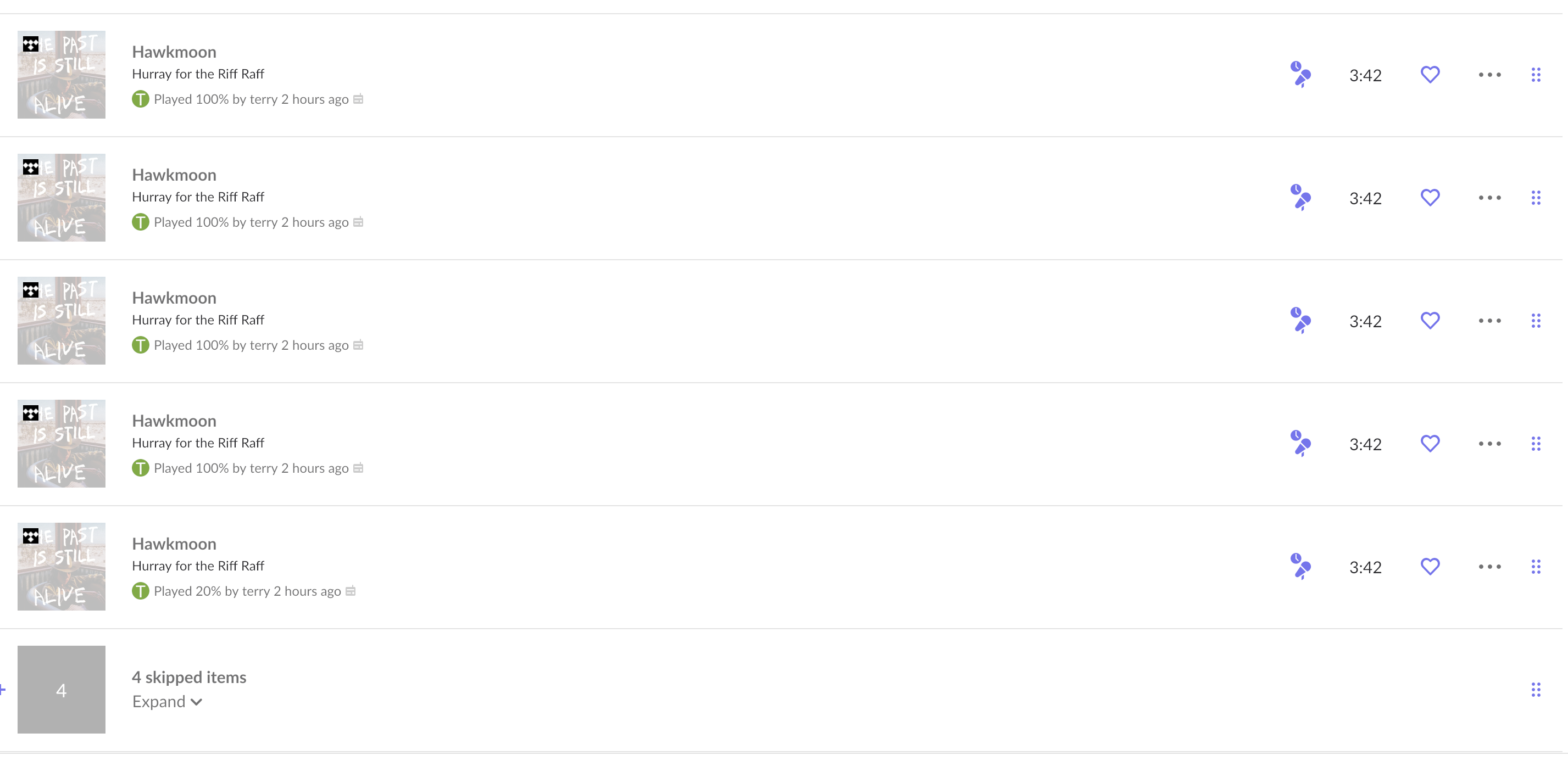

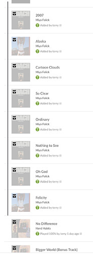

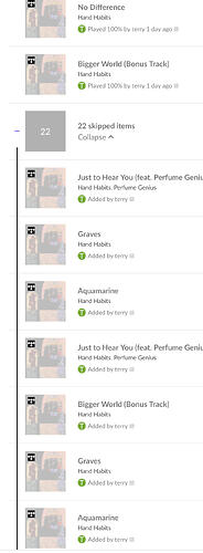

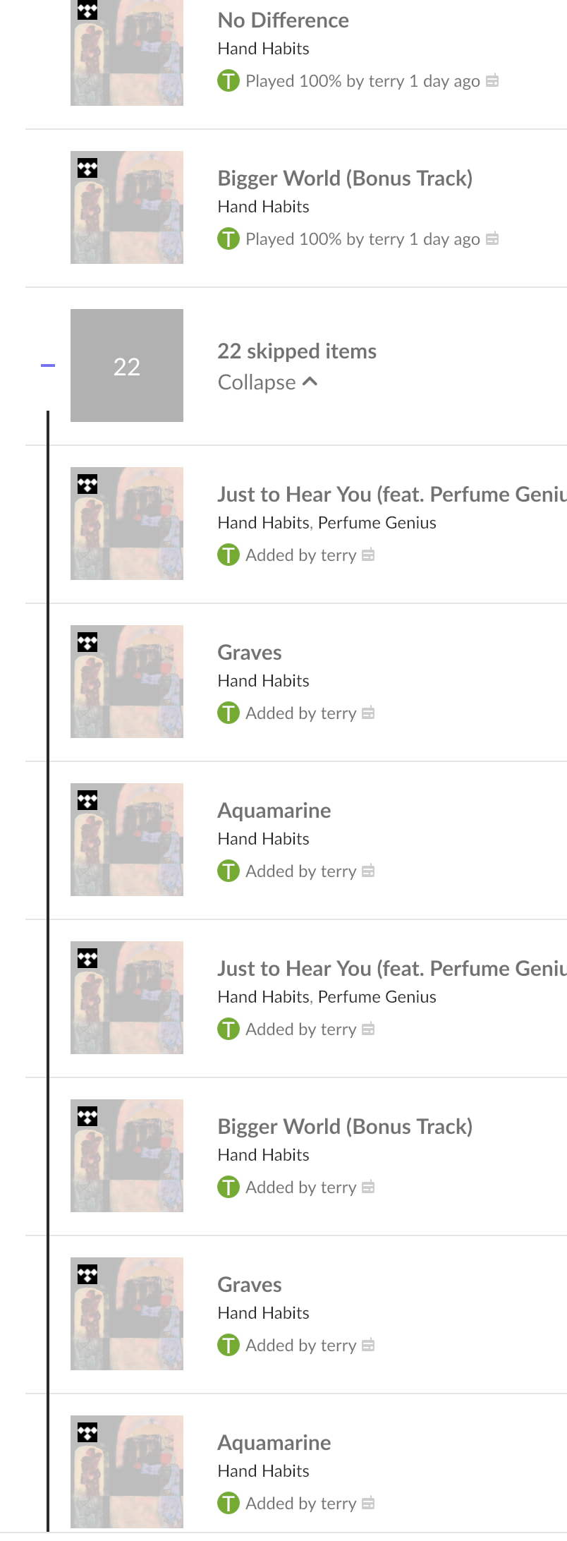

this has happened a few times in the last few days. i do not have exact dates and times, but i believe these screenshots were captured yesterday afternoon. (this is just the most recent two instances…and i can’t capture the entire length of the items i kept skpping)

We can clearly see the underlying issue is tied to Roon Radio. Roon Radio seeded a “swim” session, and the recommendation graph kept returning the same small pool of closely-related tracks.
Your skips register as feedback calls to the cloud service (I can see the POST …/feedback events fire right when you skip), and “I don’t like this” registers as [banned] skips, but the next-item picks kept landing back in the same neighborhood.
There are also a couple of session-health warnings worth noting: failed to init swim session: FailedSeedNotFound and reinitializing because session was lost, which suggests the Radio session occasionally drops and re-seeds from the most-recent track, which can restart the same cluster.
