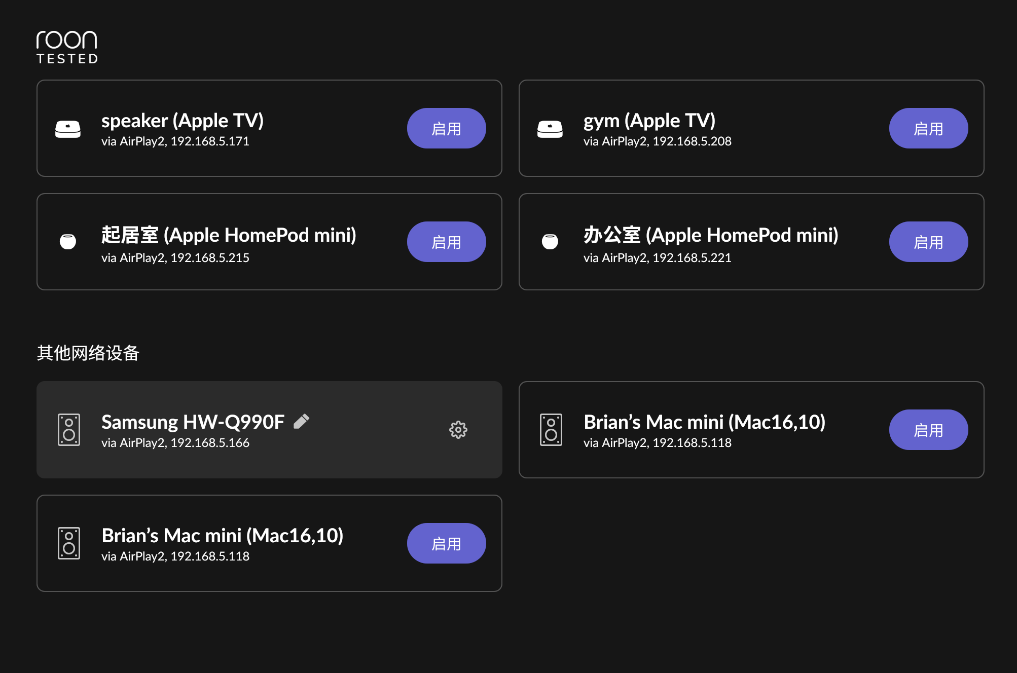

The soundbar works perfectly as a Roon Ready device when the Core is on macOS.
However, when the Core is on Windows 11 or NAS (Host Mode), the soundbar is NOT discovered via RAAT (only AirPlay appears).
Troubleshooting:
- Firewall/Antivirus disabled on Windows.
- NAS Network set to Host Mode.
- Soundbar factory reset and updated.
Since it works on Mac, the hardware is fine. This is a specific firmware protocol discovery bug with Windows/Linux Cores. Please investigate.

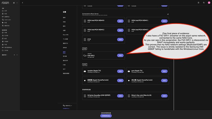

Simple flat network setup: 1. Router: Standard ISP Modem/Router combo. 2. Roon Core: Connected directly to the router via Ethernet cable. 3. Samsung Soundbar: Connected to the same router via Wi-Fi (5GHz). All devices are on the same subnet. No managed switches, and no mesh nodes.

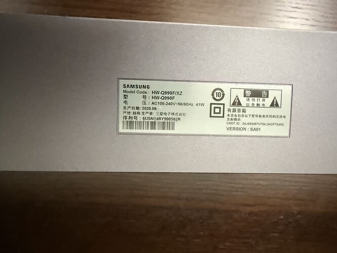

Here is the photo of the product label with the Serial Number.

After performing extensive troubleshooting (checking logs and testing different Cores), I decided to do a complete reboot of my entire network infrastructure (router, switches, and the NAS host).
Surprisingly, after the full network restart, my Roon Core immediately identified the Samsung HW-Q990F as a Roon Ready device via RAAT.
It appears to have been a transient network glitch or a “zombie” multicast state in my network equipment that was specifically blocking the discovery of the Samsung soundbar, even though other endpoints (like my FiiO) were working fine.
Everything is working perfectly now. You can go ahead and close this ticket.
