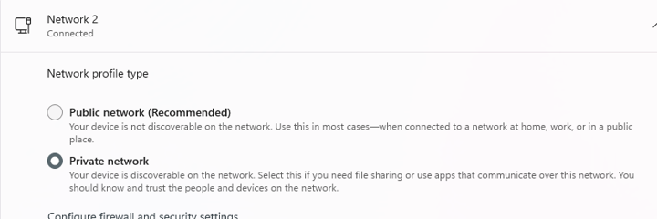

I would also add these exceptions to any Antivirus or other Firewall blocking applications you may have and ensure that you connected to your network via a Private network, not a Public one, see this guide for more information.

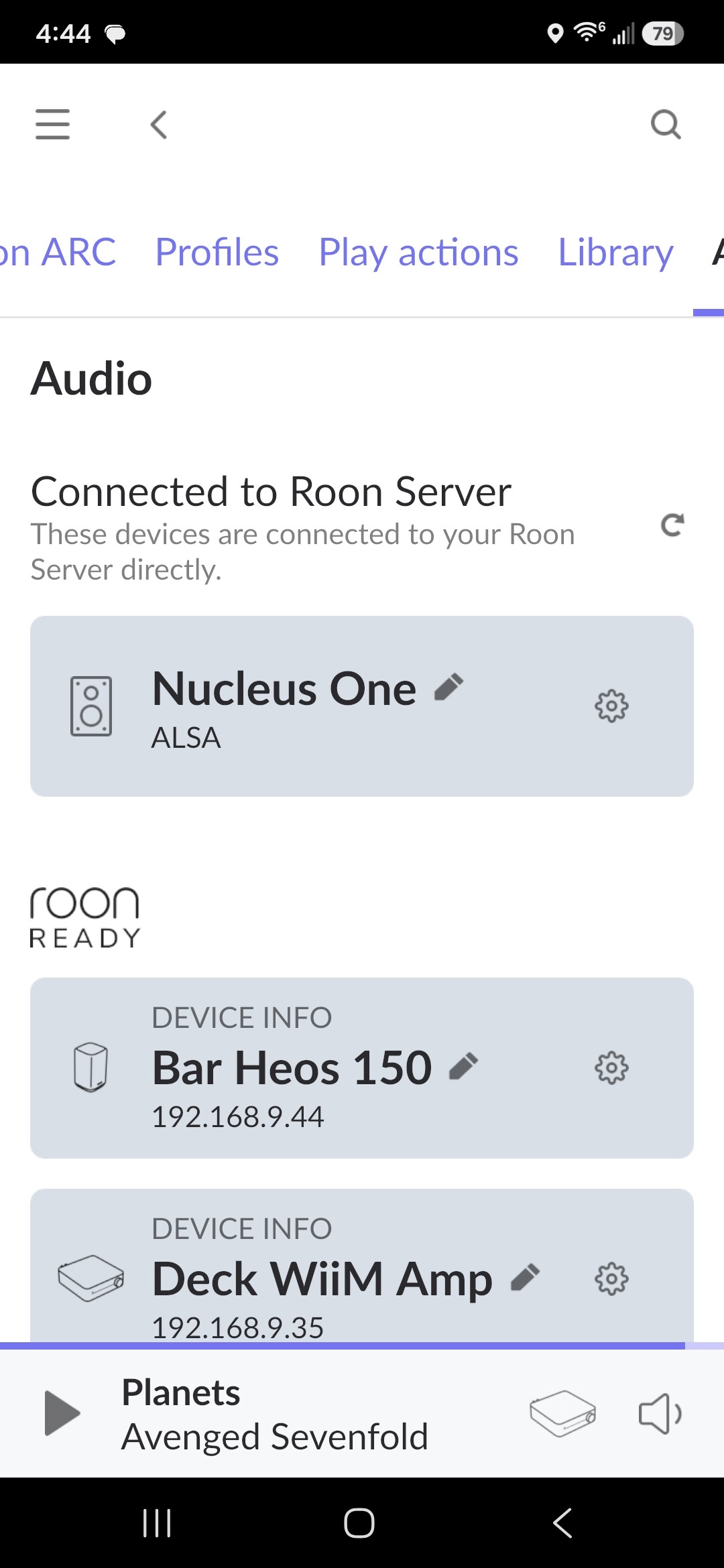

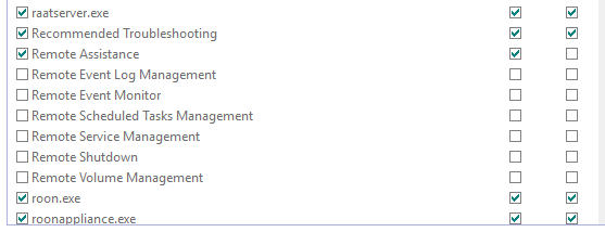

Here are my network and firewall exception settings…still not working. I was able to use my phone to access my Roon library ever since I started using Roon and the Nucleus One, until about two weeks ago when my phone disappeared from the available devices on the Roon app on my phone.

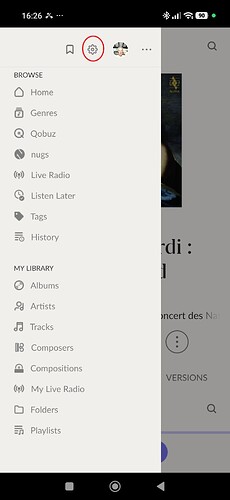

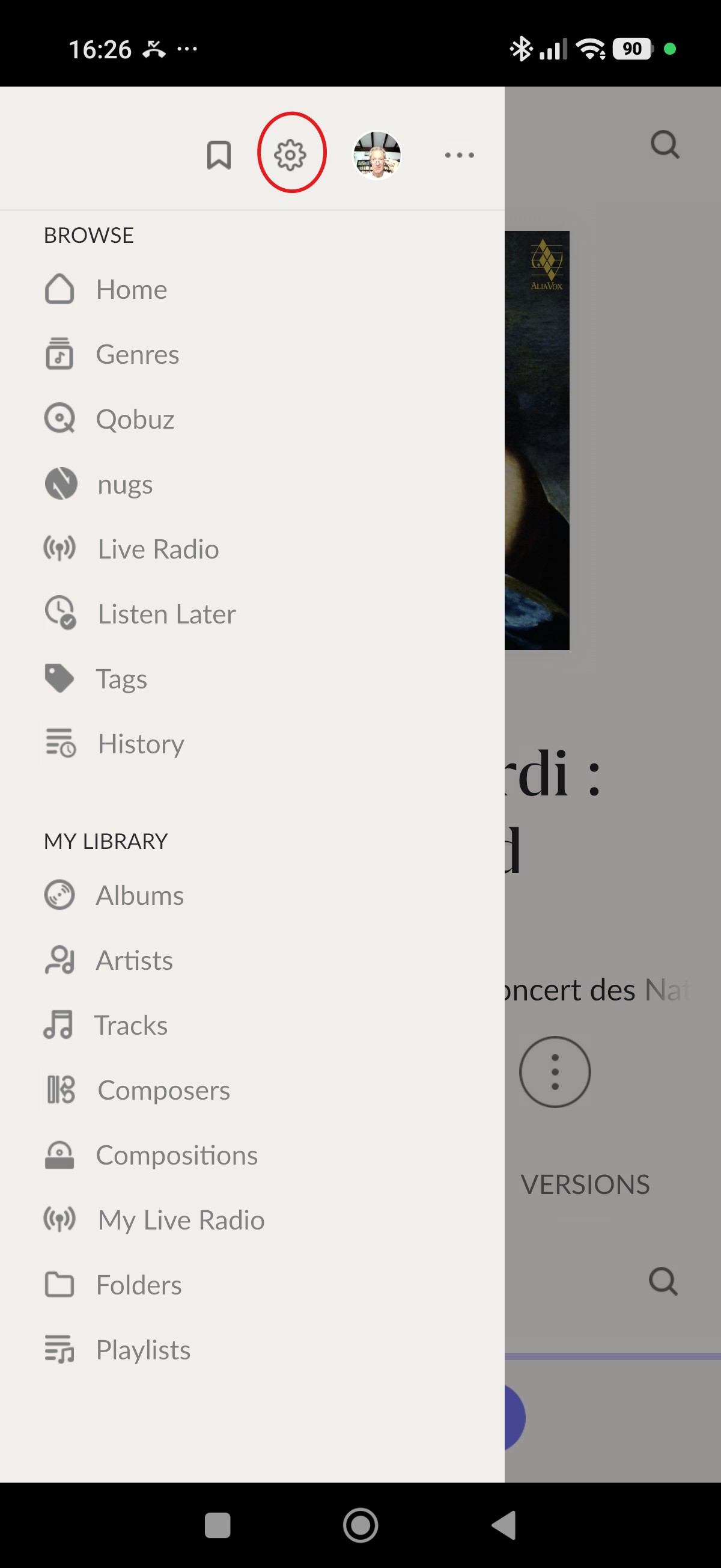

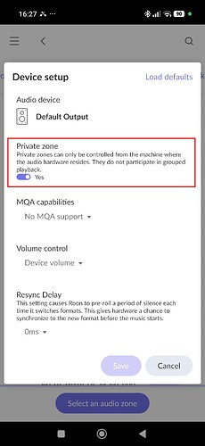

On your phone’s Roon app, open the Settings with the :gear:icon:

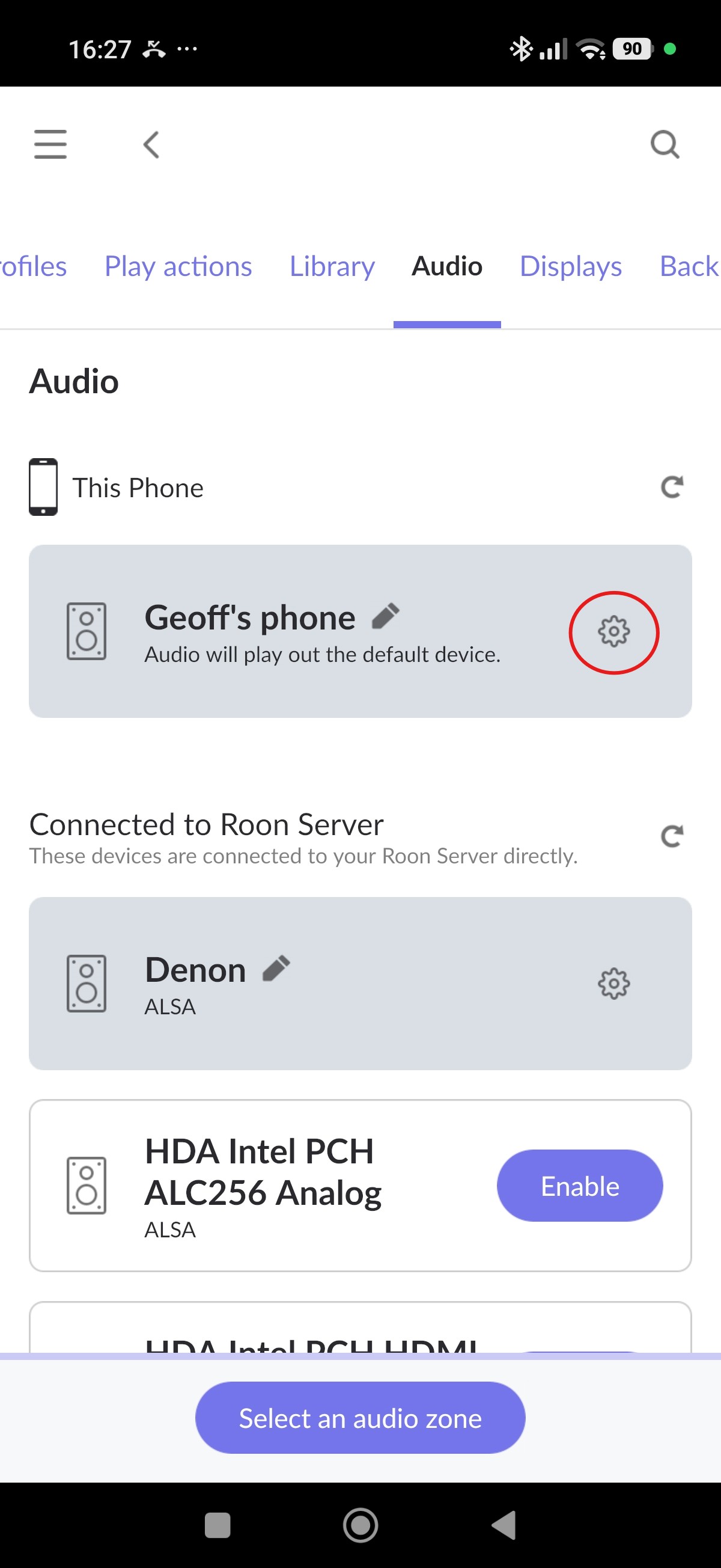

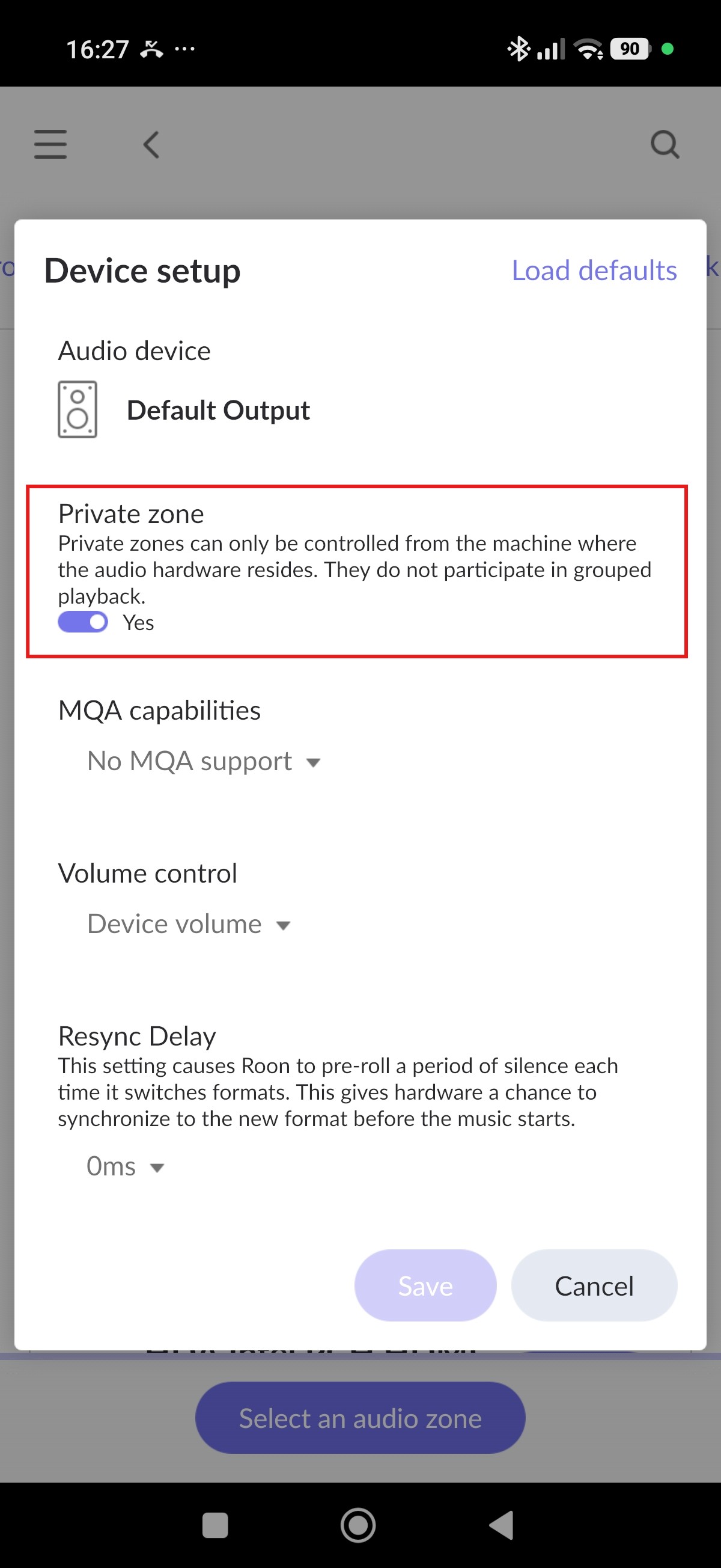

Scroll the Settings options horizontally and open the Audio settings, then open the phone’s Audio settings using the :gear: icon and choosing Device setup:
That’s where the Private zone setting is…

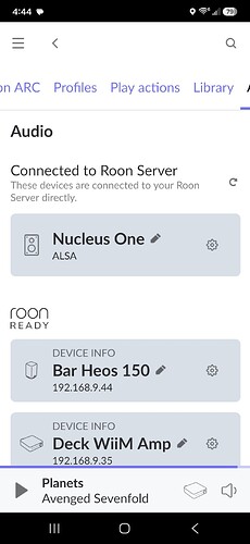

The problem is more fundamental - my phone doesn’t appear as a device in the Roon app Audio settings.
It will only appear in the app on the actual device.

Sorry, I missed the part about looking on the app on the phone…In any event, my phone does not appear as a device under Audio in the app on my phone.
