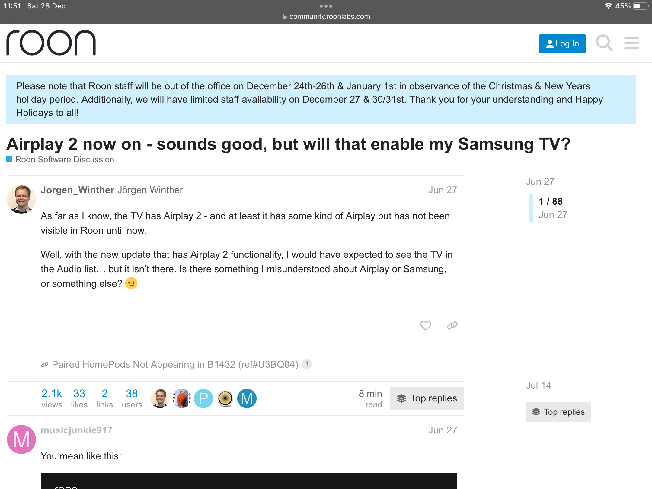

My Samsung The Sero “smart” tv is listed as a network device in Roon (via Airplay2) and I am able to enable it. AirPlay gives a passcode and the tv connects, but does not play any music and the tv keeps regenerating passcodes, which I cannot enter anymore in Roon. I can see a signal path, but only the first time I fill in the passcode and press play, but no sound and the signal path (data) disappears.
This should be a known problem, as I found many references to this unsolved problem. (User: Jörgen Winther, Alan_Tuszynski, Svein-Ole_Sorensen, Andres_Roepke etc.)
