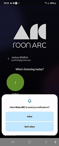

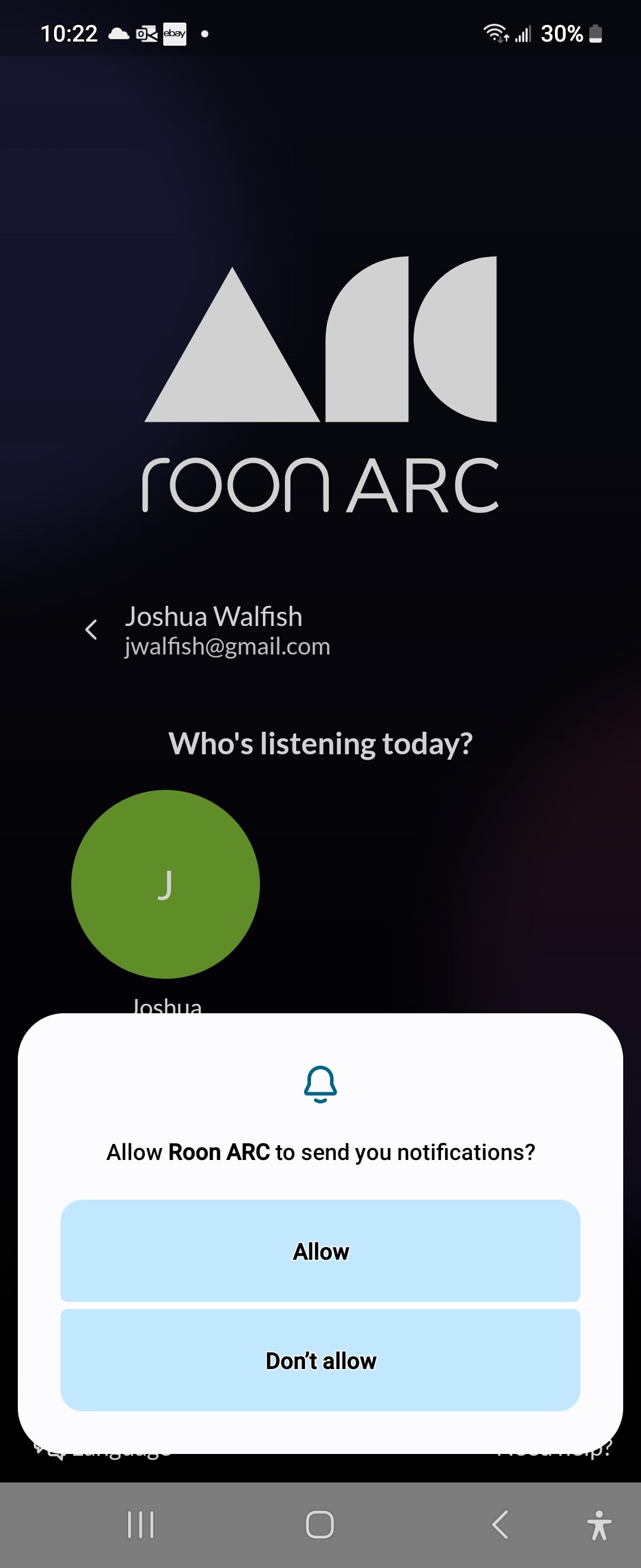

Thank you. I’ve installed both. ARC still hangs at this screen.
