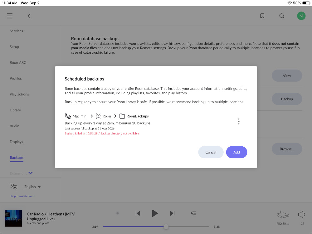

· Setup a USB drive (FAT32) on MacMini running Ubuntu 26.04.1 LTS. Configured Roon Backup to use USB folder for backup location. "Backup Now" works without issue to the designated folder on USB drive. However, scheduled backs fail ever time:
Backup failed at 10:51:28 / Backup directory not available
If you attempt to Force backup now within the Schedule backup it will also fail.
· Linksys Atlas 6 router Ethernet connected. Mac Mini (Ubuntu) with Roon Server, Ethernet connected

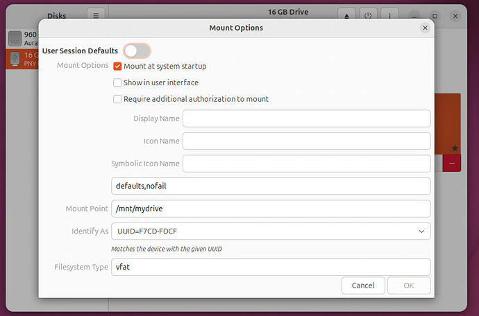

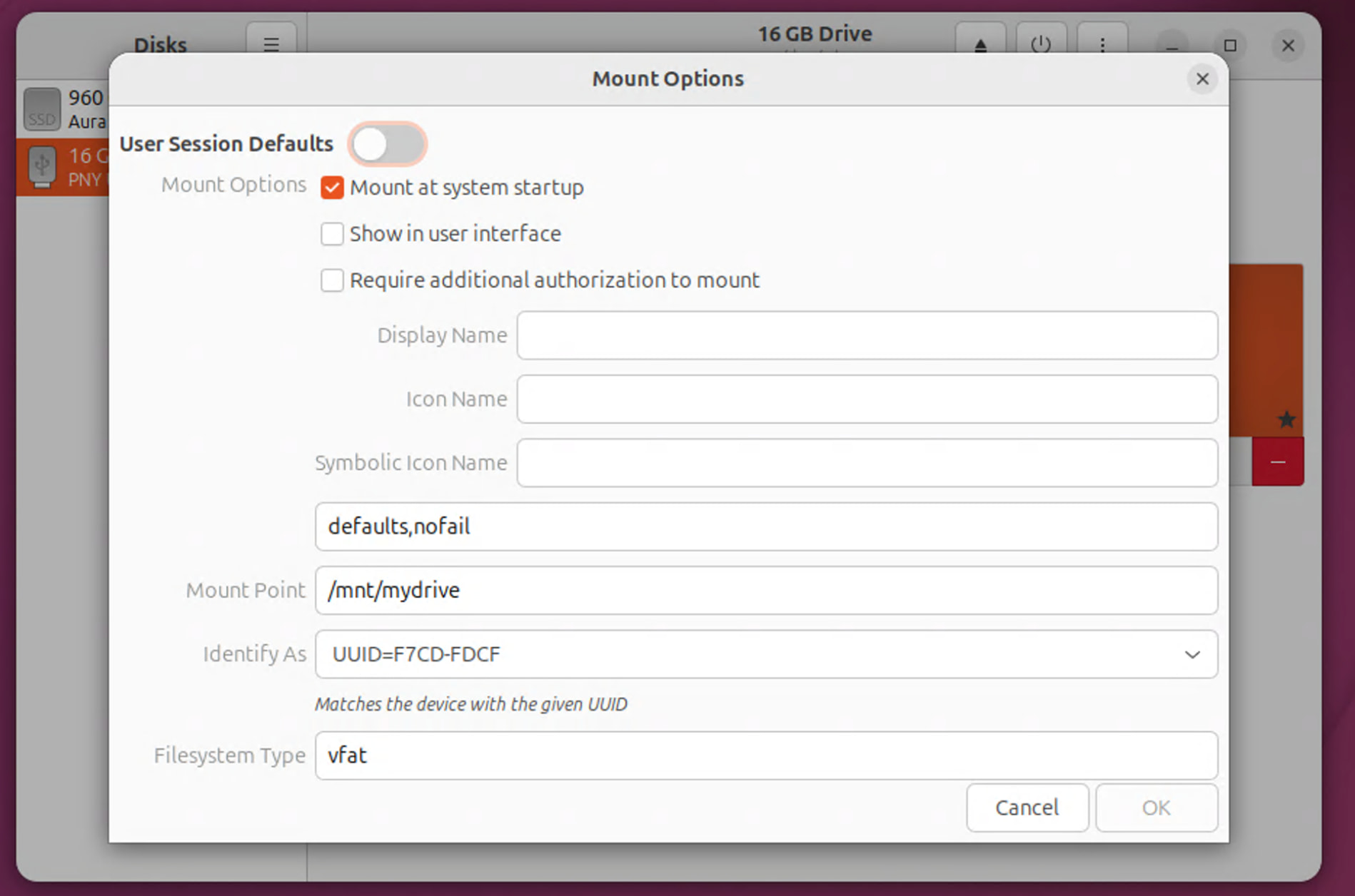

If you’d rather not hand-edit /etc/fstab in the future, GNOME Disks writes the same entry for you: select the drive, open the gear menu → Edit Mount Options, turn User Session Defaults off, tick Mount at system startup, and set the mount point (screenshot below). Same result, no terminal.
