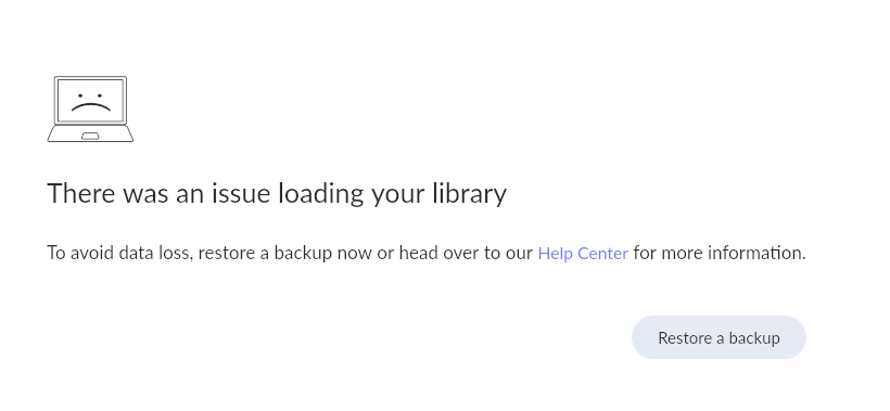

· Scheduled ROCK database backup fails. ROCK: Version 2.1 (build 271) production - Server: Version 2.65 (build 1653) production - Manual backup attempt also fails. After failure, Roon client shows: There was an issue loading your library. Only way to get client working again is to re-boot ROCK server. This lasts for a day or so and then again client displays same "There was an issue loading your library". Another re-boot and same issues above repeat.

Renamed old folder as suggested and re-started server. Let it run for almost 8 hours and attempted new backup. As soon as backup started, Roon remote displayed: “Uh oh, something’s not right” Make sure Roon server is turned on…. Roon remote then displayed: “Waiting for your Roon server”. After several minutes, I restarted the server and the remote responded again. Still cannot perform a backup, and since I do not have a backup there is nothing to restore. Anything else I can try?

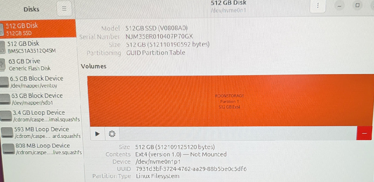

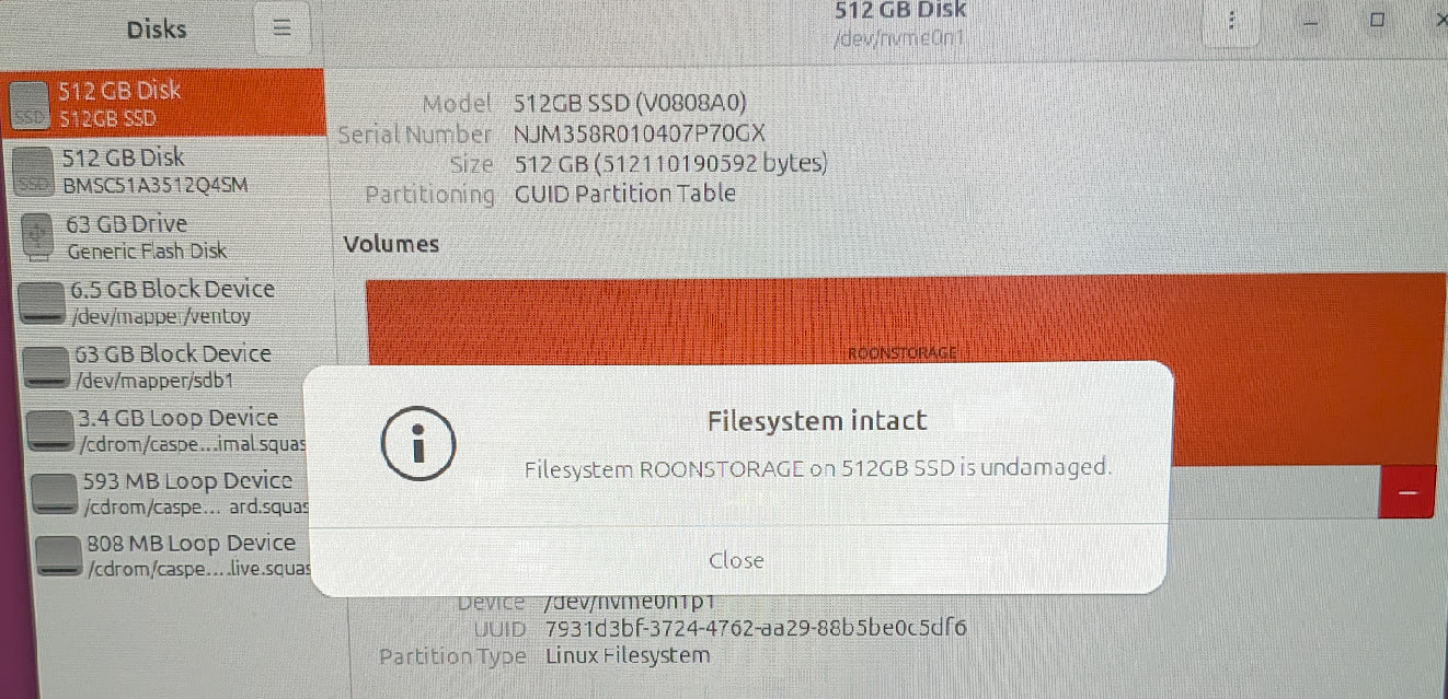

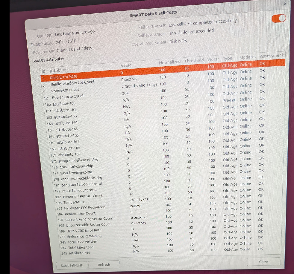

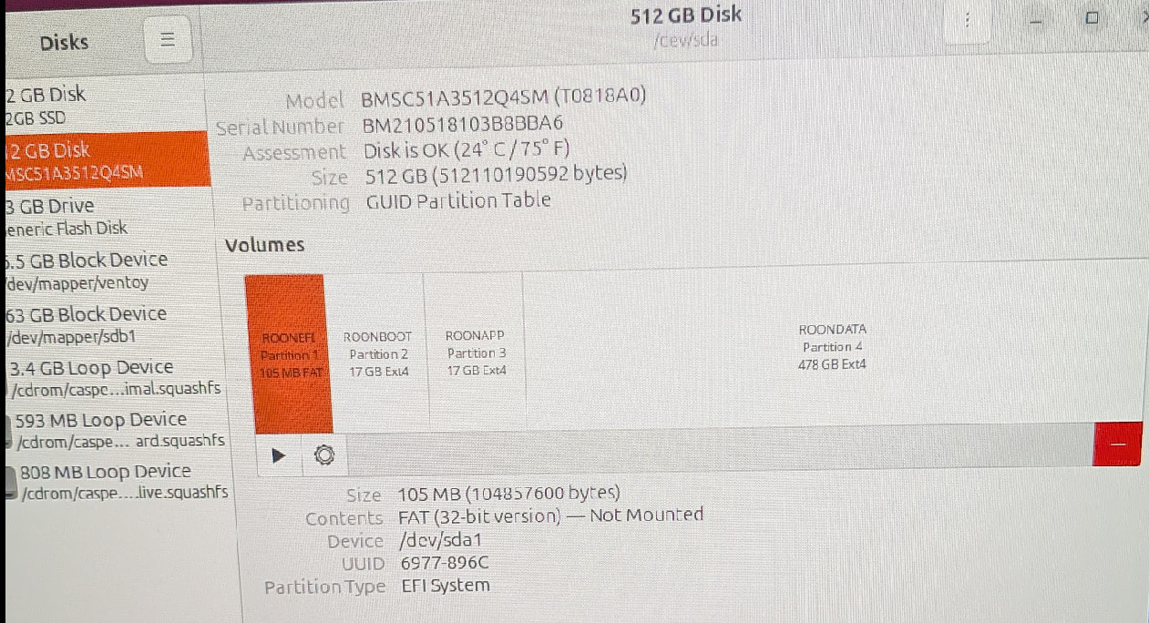

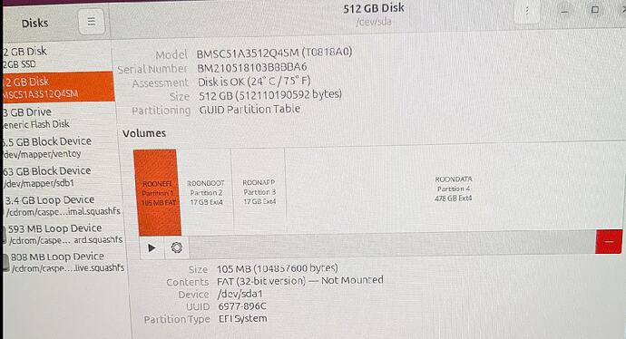

Hi,
I followed Method 1 above. Disk appears to be okay from the test results. I have uploaded 4 screenshots from the “Disks” screen. It looks like Roon OS/boot is on the 512GB SSD and the 512 NVME is formatted as Roon storage. Let me know if you see any issues. Sorry for the blurry screenshots. Computer is a Beelink Mini S w/16GB memory.

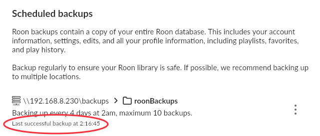

I just was going through the options, and I looked at the Backups section and it looks like the backup ran overnight? Not sure what changed…
Thanks
Hey @mfc,
Thanks for the update! From a fresh server diagnostic report, we see the backup subsystem initializes cleanly on startup ([broker/backups] initializing) and the network share at \192.168.8.230\backups mounts successfully over CIFS. There are no backup errors, failures, or abort events anywhere in the fresh report. The backup appears to have been working normally throughout the last few days.
Overall, things look stable. No backup errors, no database loading failures, no server crashes in this log set. Let us know how the next few days go :+1:
