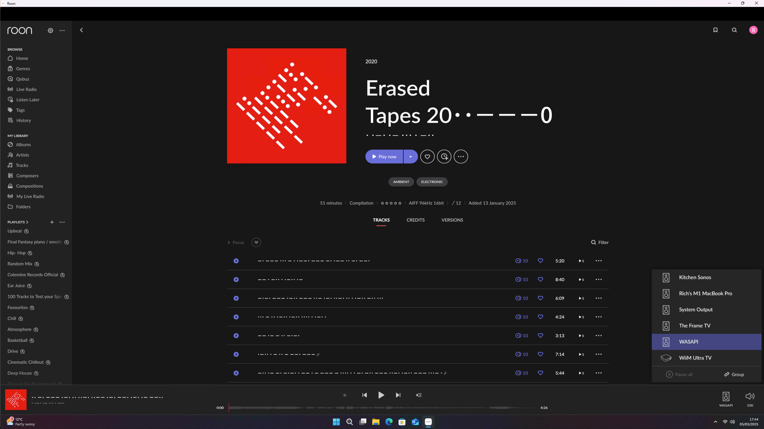

I have an i7 Comet Lake NUC (i7-10710U) Windows 11 PC that I am running Roon Server on as a headless unit. I have a Schiit Modi+ USB DAC connected directly to the NUC via USB. The NUC is connected to an Eero mesh network via WiFi but the Modi+ should be the default audio zone. However, it doesn't show as an audio zone on any Roon remote endpoint device (MacBook Pro, iPad, iPhone) in Roon unless I physically connected (via HDMI to a screen) the NUC first. If I remote into the NUC using Microsoft Remote Desktop, it changes the audio zone and the Modi+ is no longer available on any Roon endpoint until I reconnect physically with HDMI again. Selecting WASAPI or System Output on any Roon endpoint brings up either the error "Too Many Failures" or does not play at all. The Modi+ is the default audio device in Windows and all other audio outputs are disabled in Control Panel / Settings. I basically cannot use Roon Server in a headless way. Note too that I still do use remoting into the machine to burn CD's and add music from other sources so a complete 'set & forget' system where once the Modi+ is enabled leave it alone will not work for me.

Hey all, @noris & @BlackJack thanks for your replies! I really appreciate your help! This was solved in two ways. 1. with the HDMI dummy plug you suggested and the other with ensuring Remote Desktop had audio device sharing turned on. This then ensured it defaulted to the DAC (which was the default) and that the GPU defaulted to the dummy plug as the video output and didnt shift to the virtual screen.
