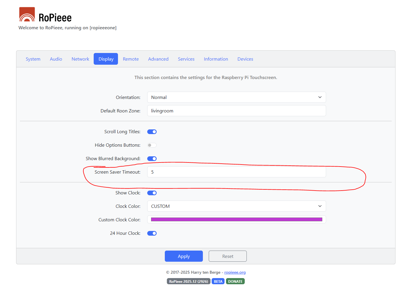

I just setup an RPi5 as a Roon display only (not connected to the DAC/streamer). The display correctly turns on when music starts from that zone, but after music stops the display stays on, the screensaver does not engage.
Any help to diagnose the issue would be appreciated.

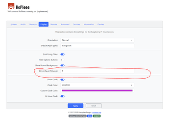

Have you tried changing the timeout on the Ropieee WebUI “display” tab?

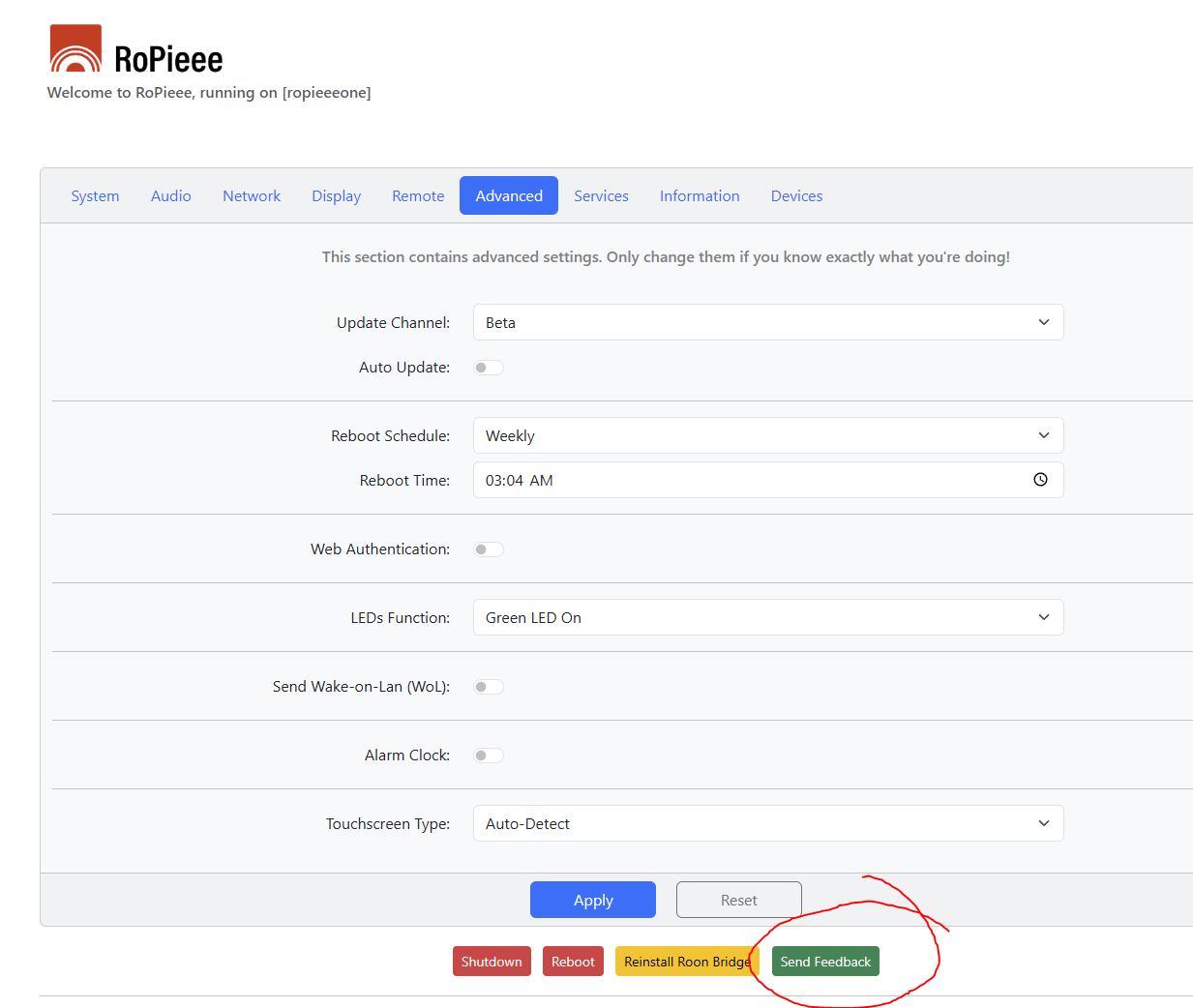

If so you might also try sending feedback to Harry so he can review it?
From the Ropieee webUI advanced tab.
Thank you for the help! It seems to work with a shorter timeout… or it just decided to work today for no reason. If the problem recurs I will send feedback.
