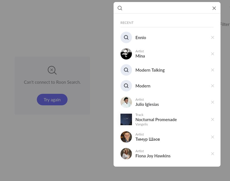

· I am experiencing problems with the Search function. When attemting to find an artist or an album Roon says "Searching for..." and after a while - "Can't connect to Roon Search". Prevoiusly searched items in the "Recent" list are loading fine, but any new search attempt fails.
Besides, many album and artists images appear as grey squares or empty circles.
My music library is stored on Synology NAS. Roon server is running on the same NAS, another copy (not at the same time) - on a PC with Windows 11. The search problem persists with either Roon server activated. I stopped and restarted the Roon servers, restored from a backup, even rebuilt from scratch the database for one of the servers.
