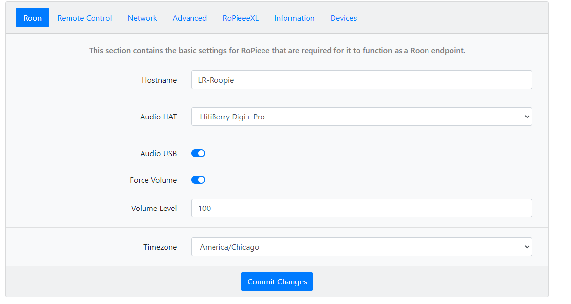

Kind of newbie here, using Raspberry Pi 3 Model B Plus Rev 1.3 with a HiFi berry Digi + Pro HAT, running RoPieeee XL ver 3.020, connected to a NAD M32 using the SPDIF digital output from the HAT. I would like to try the USB audio output instead, but I do not seem to be able to make it work. I suspect there are changes to the RoPieee software but I do not know what they are. Can someone please help? Thanks.
I’m not at home to find it for you, but in the RoPieeeXL software, find the place where you turn on the USB selection. I think it’s under the Roon heading. Then save. You might need to reboot.

This might not be a great idea as the Pi3 shares the same bus with Ethernet so is apparently quite noisey. Jim is correct that in the Web interface you can turn off the hat output and set it to USB.

As far as I can tell, the USB Audio is already on.
Set the Hat to blank (or no hat) and restart the Pi.
I think mine is set to no hat, as I think the Hat overrides the usb audio.
Mike
It does not. USB works out of the box, independent of HAT settings.

I had the same issue. I set Ropieee to ā€œNo HATā€, restarted, then went to the Roon audio settings, where the USB output appeared and could be enabled. Then if you turn the HAT back on, both outputs appear separately in Roon. And can play different music at the same time. Not sure if this is what it’s meant to do, but cool!
