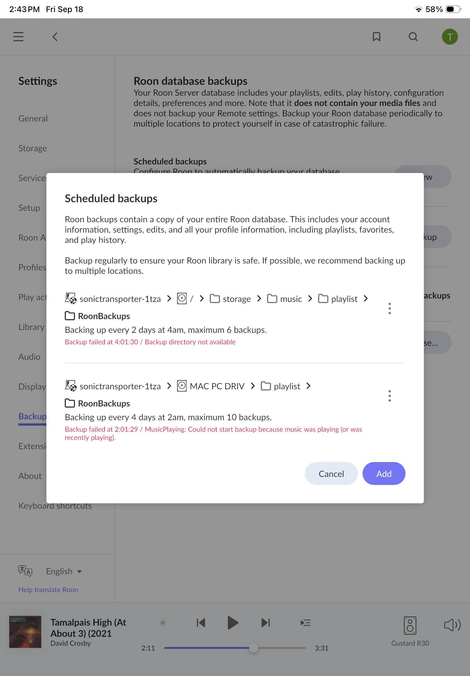

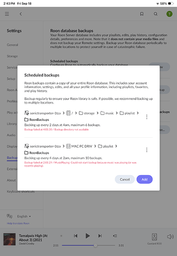

Below is a copy of my issues. My Sonictransporter internal storage drive error and now my external drive music playing message when I am sleeping and not playing ant music in roon. Only success is manually requesting backup.
Hey @tksteingraber, thanks for the screenshot, the timestamps let us pinpoint both failures in your Roon Server logs.
Internal storage: the scheduled backup is pointed at /storage/music/playlist/RoonBackups, but on your sonicTransporter the internal drive is mounted as InternalStorage, so Roon can’t find that folder. It isn’t a drive fault. Please delete that scheduled backup and add a new one, choosing the InternalStorage drive in the folder browser rather than going through “/”. We’d also suggest keeping the external drive as your main backup, since a copy on the same device won’t help if the sonicTransporter itself fails.
External drive: at 2:01 AM on 9/18, Roon Radio was still playing to your Signature Rendu SE. It had kept going on its own after your queue ended around 10:30 PM, and it didn’t stop until about 2:09 AM. Roon won’t start a backup while music is playing, so the message was accurate. The good news is that the next night’s scheduled backup to your Seagate drive (9/19 at 2:00 AM) completed successfully. To avoid this in the future, you can pause or stop playback before bed, turn off Roon Radio under Settings → Playback, or move the backup to a time when you’re sure nothing will be playing.
Let us know once the internal storage backup is re-added and we’ll confirm the next run in the logs.

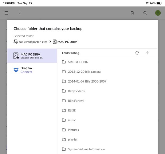

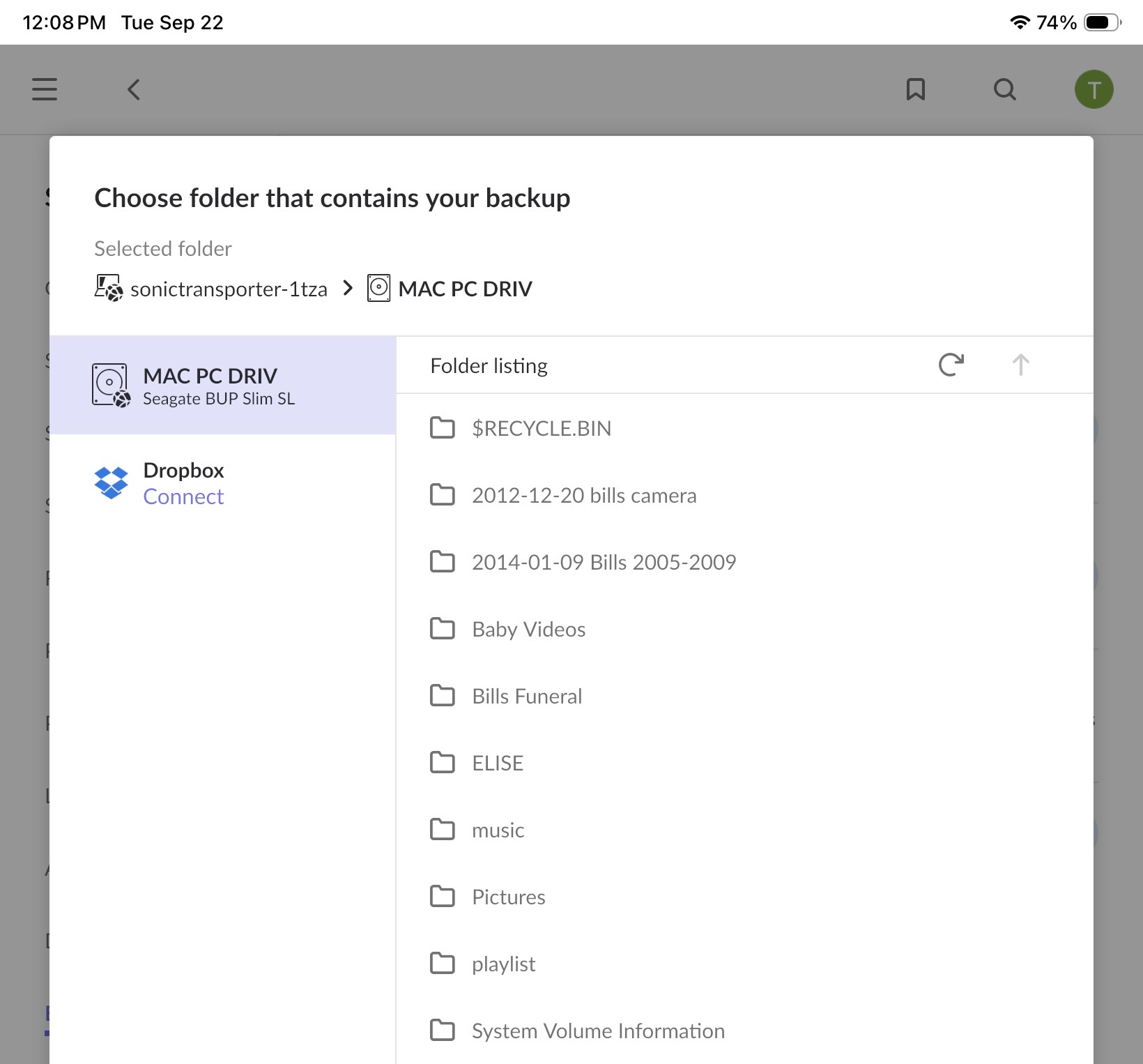

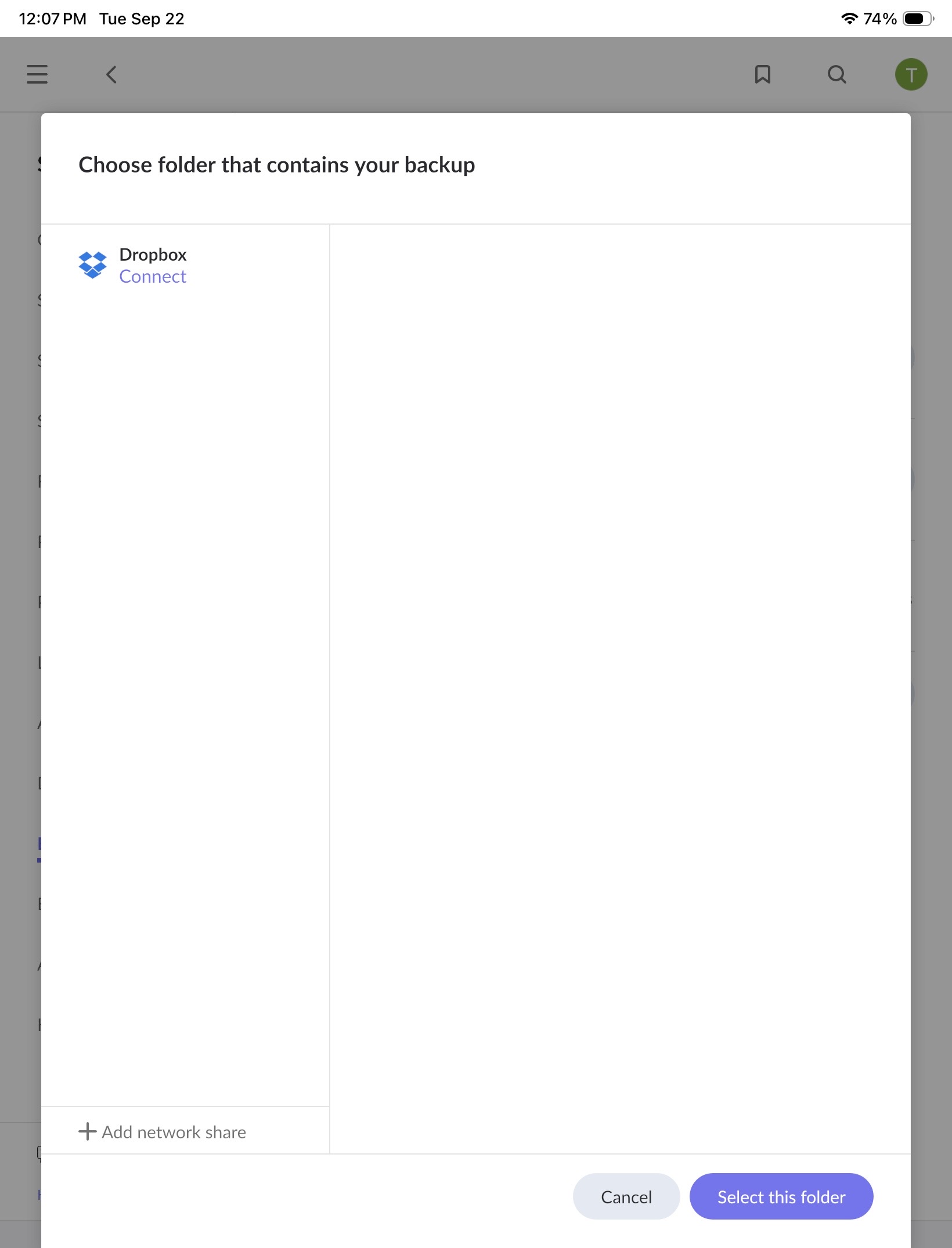

I have not been able to set up the Sonictransporter internal drive as a backup. It does not display when I browse in Roon. Only Dropbox displays and when my external Seagate drive is plugged in it displays as a choice but no internal Sonictransporter drive path.
Any insight on how to get the internal drive to display?

Here are some screen shots of my issue.
Hey @tksteingraber, thanks for the screenshots and the clarification about the overnight playback.
Backups are not recommended in locations that Roon is watching under Settings > Storage, because Roon can end up scanning the backup itself and that can cause problems. On a lot of systems, the entire drive is added as a watched location, so the backup folder may not show up the way you expect.
We also see that you plan to keep using your external drive for backups, which is a sensible approach here. Let us know if you want us to take another look at the folder setup.
