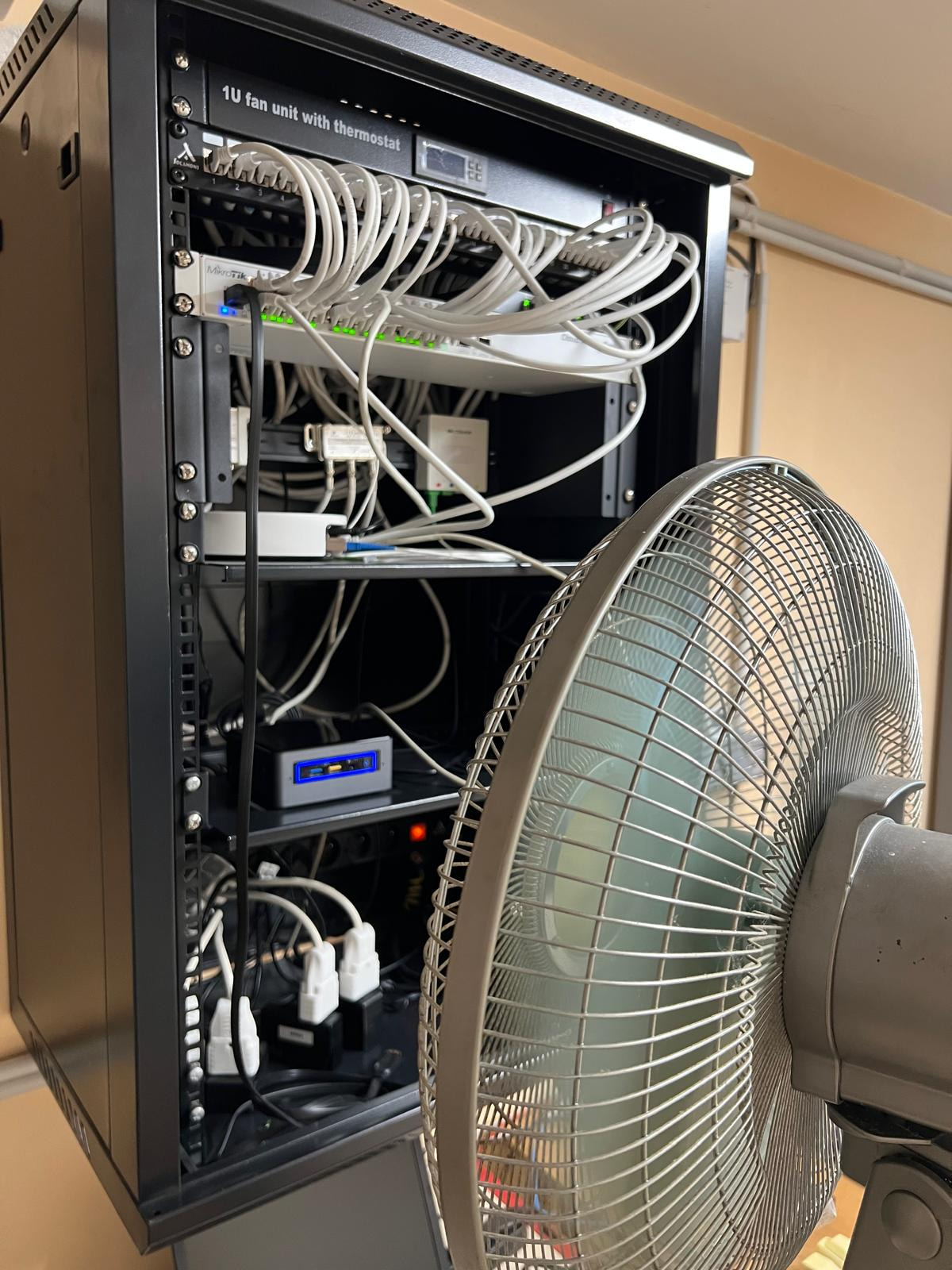

In the morning, I find my server burning hot with its fan running at full speed.
I can't access the server remotely, either through its web interface or with Roon Remote.
I have to unplug it, wait for it to cool down, and then restart it.
Fortunately, these two crashes haven't caused any damage.
The room temperature is 24°C (75°F).

Inadequate cooling solution violating intel’s specs at play? Properly built and working computers should be capable of running at nominal speed (100% load) without the thermal protection halting the CPU. Is your fan potentially defect or clogged? I believe it is also thinkable that the reason for the sever being unresponsive lies somewhere else and has nothing to do with the temps. Hard to tell from afar.
I had this happen too. I think it may have been due to having both background work and backup scheduled at the same time overnight. I’ve since taken background off a schedule and I haven’t had an overheating/crash since. I also now have some very quiet USB mini fans pointed at my fan-less case, just in case, but I doubt those would cool it as much as it was hot - it was hot enough to cook on! Mine is a NUC 7i5.

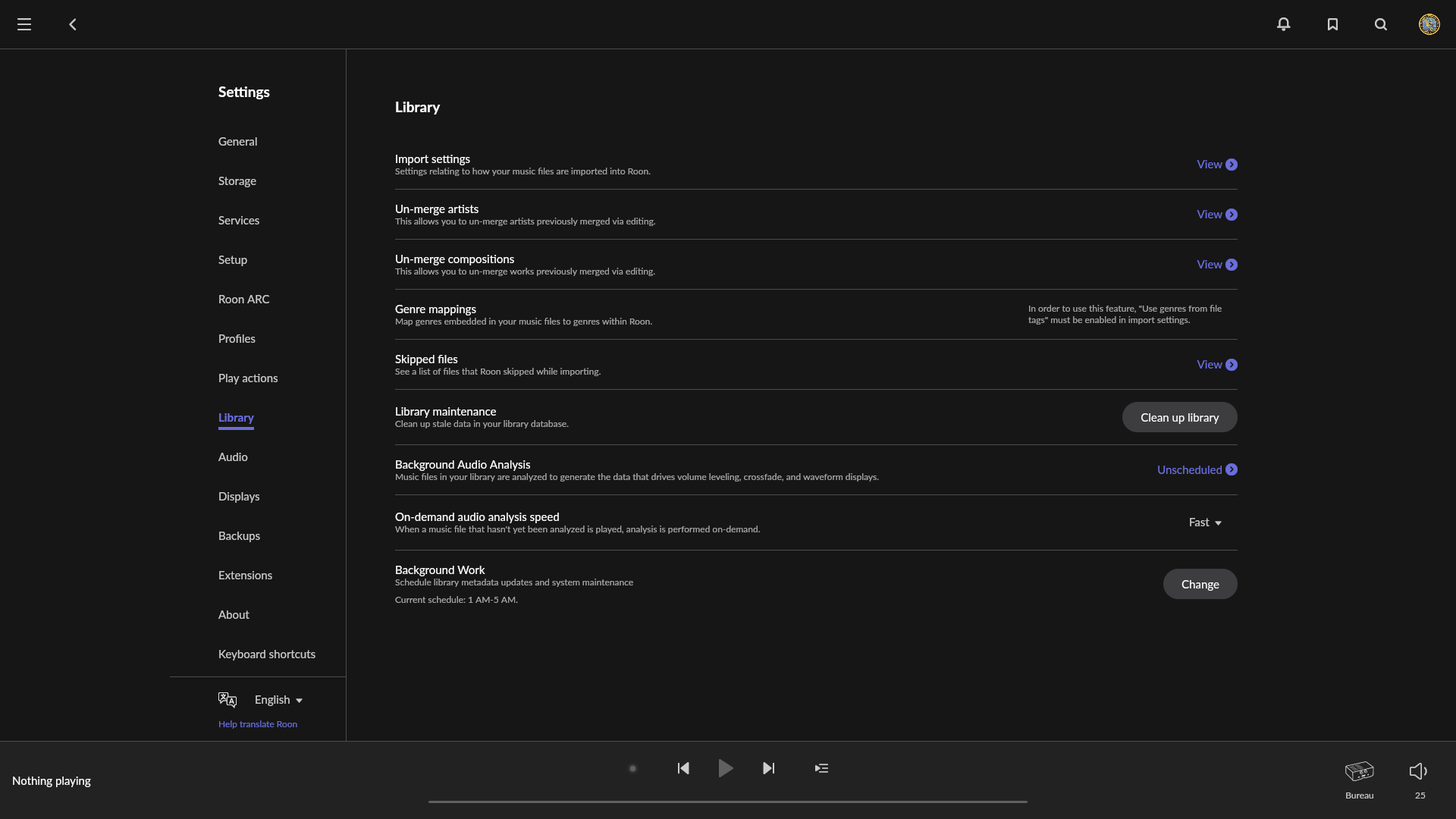

To answer your primary question: Yes, you can slow down the background work. The background tasks typically consist of metadata updates and Background Audio Analysis. You can throttle the analysis portion by navigating to Settings > Library in Roon. Look for Background Audio Analysis Speed and set it to Throttled. This limits the number of CPU cores Roon uses, which significantly reduces the processing load.

Here are my current settings regarding background processes.
