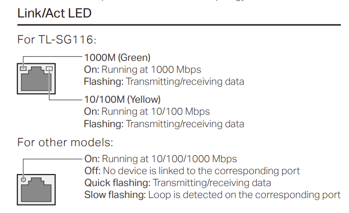

Check the ethernet port lights to see if you truly have gigabit speed, lights are typically one for connection status/speed (solid) and one for activity (flashing). There is no universally adopted standard that all OEMs follow. But, on my TP link switch green = 1000Mbps, yellow = 10/100Mbps, but colors can vary by manufacturer so check your manual.
Like this for my TPLink TL-SG116 (it also shows for other models that do not indicate speed):
