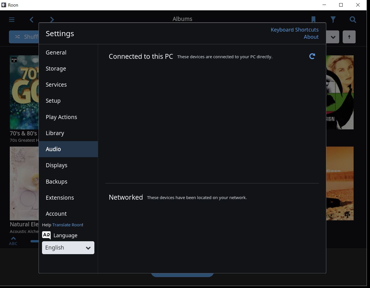

Description Of Issue
JRiver Media Center 25 works fine with CD’s ripped to FLAC - with High Rez Flacs from HD Tracks, and DSDs from several sources.
Tidal also works fine.
From a total power up (audio & pc)
after powering up system - I launch Roon - go to Setup-Audio and I see this:
By the time I close the snip tool I get this:
(and every time I’ve tried this - I get this screen for maybe 5-8 seconds) This screen only shows up after Resetting the DAC.
Before I can even really read the screen - it clears and leaves me with nothing.
Hi @Vince_Binder,
If you disable the firewall on the Core machine is there any change here?
Nope - The devices show up then disappear before I can even finish reading half the screen.
I went back and disabled all three: Domain, Private, Public - I’m not sure if the screen stayed up any longer but if it did it was only another second or two
I tried disabling the bottom 2 - screen disappeared. I close Roon, reopen - select Manage Audio Devices - and I’m right back where I was.

Moving forward, please try the following — You can generate a new RAATServer instance on your device by following these instructions, but please be aware that this will reset your Roon Settings -> Audio Tab to factory settings and I would advise making a backup of any custom DSP settings you have:
  • Make a backup of your Roon database
  • Shut down Roon on this device
  • Navigate to your Roon’s Database Location: https://kb.roonlabs.com/Database_Location
Go and look to see if you have Nahimic services running. Disable them and you should see your devices.
See this thread:
We’ll it took some futzing but deleting RATTServer (I didn’t have anything to back up) and reinstalling the OPPO driver - seems to have done the job. At least until the next time I reboot - I have a nagging suspicion that will start this whole circus over again - I’ll know in a day or two.
Thanks.
