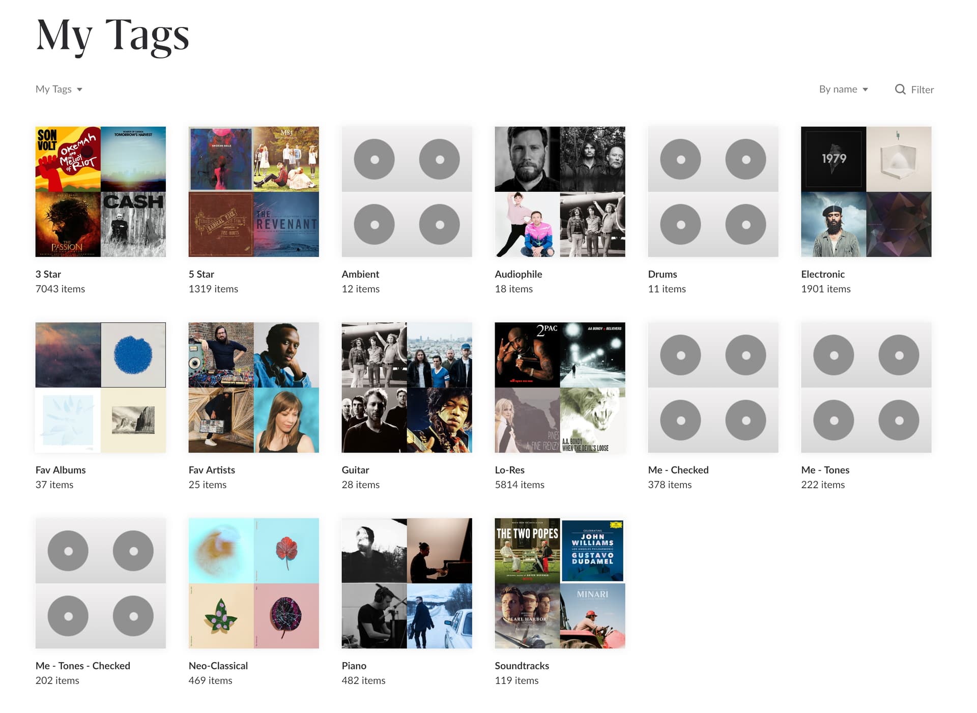

Thanks for letting us know that the DNS change helped a bit. Can you please confirm, is there anything else interesting about your library, do you have quite a large amount of albums from one/few particular artists? Do you have any more tags associated with 10,000+ tracks/albums? I am looking over the latest diagnostics package for your Roon Server and I notice a lot of library activity. Also, if you have not done so yet, please try to turn Off or set to Throttled Background and On-Demand Audio Analysis under Roon Settings → Library.
Here is what my tagging system looks like at a glance. I’d say most of my tags are assigned to albums, except the “star” tags.
