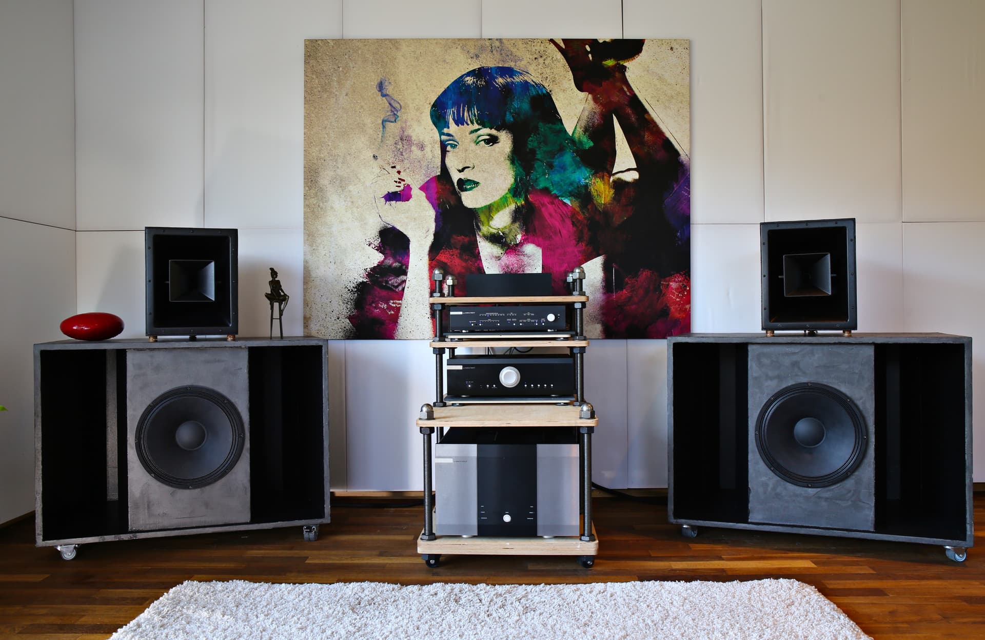

Want some dynamics? One may go for a horn system. Roon helped me to tame them (Hornblower 15 HO) and get rid of most of the typical horn colorations.
I did try complete active crossover design (with Okto dac8pro) and completely passive crossovers and ended up with the latter. The use of different Amps makes it very difficult to get the right performance (Could not afford another AMS100).
The current setup:
  • Roon Core on a MAC Mini M1
  • Roon Bridge (ropieee) with Intona USB isolator and a good linear power supply
  • Musical Fidelity M6xDAC
  • Musical Fidelity Primo
  • Musical Fidelity AMS100
  • All cables and interconnects from SUPRA, XLR
  • Drivers: Beyma 15P80FE/N replacing the used JBL 130e. Limmerhorn 870qx with the according drivers from B&C.
  • Roon DSP used with a convolution filter to tame some low frequency issues and resolve the nasal sound issues around 1800hz.
In the active crossover setup I used the Purifi Class D AMPs which are really good and replace the AMS100 in hot summer days.
Now the hornblower is dealing very well also with vocals, piano. Not to mention Symphony Orchestra level of dynamics. The target is to get rid of the convolution filter by optimizing the passive crossovers.

This truly is a great system!
But I’d urge you to rethink the passive x-over approach.
If done properly, convolution for x-over, room-, frequency- and time-domain correction will definitely outperform any passive approach.
The MF and Purify amps should be transparent enough to not exhibit audible personalities.
Anyway, enjoy!
You are right! My Problems started in the Preamp section. Using the DACs preamp did not do the trick. It sounded thin and gave me fatigue by the time. But I‘ll continue. Putting a DSP behind the preamp was painful too.

How did you implement the crossovers?
