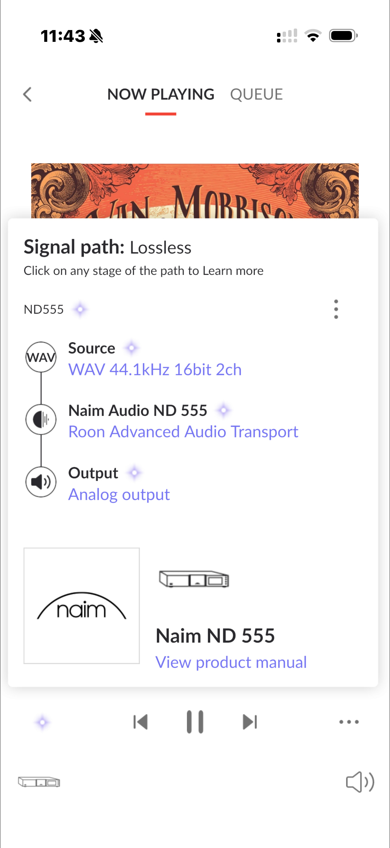

When I played music using the NDX2 I could see a detailed signal path when I clicked on the purple signal icon. This showed me what Roon was doing to process and upscale the signal. Now that I am using the DN555 the signal icon is very faint and when I click on it the signal path is much shorter - similar to the signal path when using AirPlay- and doesn’t show any processing of upscaling of the signal.
Please post a screenshot of the opened signal path
There’s nothing untoward with the signal path. The signal is bit-perfect, and there is no DSP applied, neither in Roon nor the device (that it reports.)

That Signal Path screenshot you shared looks as expected, can you please clarify where the Signal Path is missing on your end, or what is not working right? Thanks!

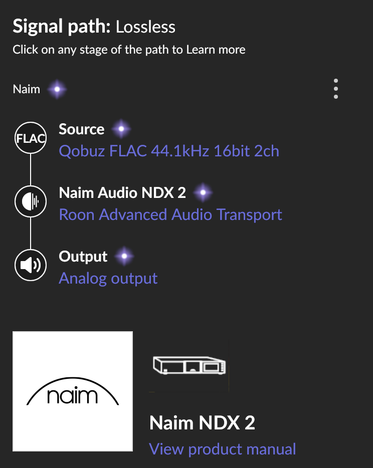

Well, do you remember what the old signal path looked like or what you had enabled? I have an NDX2 and it currently looks like this:

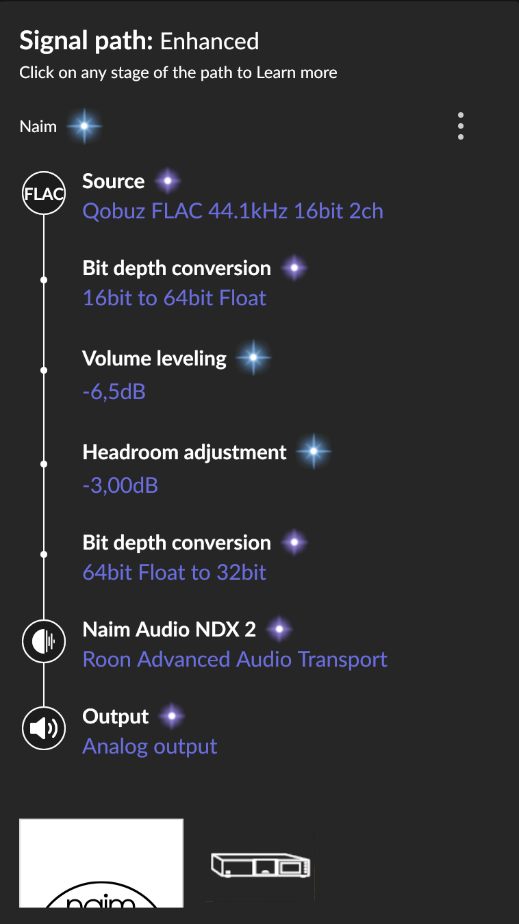

I have volume leveling enabled, and so the path has the following steps:
  1. Convert the 44.1/16 source to 64 bit, to enable volume leveling without losses
  2. Do the volume leveling
  3. Do an additional headroom adjustment (not really necessary in my case, I forgot why I left it on; it’s typically used when performing DSP operations that raise the volume. In this case, headroom adjustment adjusts it back down to avoid digital clipping.)
  4. Convert the 64 bit back to 32 bit because this is the default NDX2 input format
At the top, it says “enhanced” because DSP (volume leveling and headroom adjustment) is enabled.
If I turn off volume leveling and headroom adjustment, then it does nothing, like your ND555 path, and it says “lossless” at the top because nothing at all happens:
Like I said, the settings are device specific, so if you didn’t configure the same things for the 555 as you previously did for the NDX2, then the default is simply to do nothing.
If you don’t know what MUSE is, then I suppose the most likely thing is that on the NDX2 you had volume leveling enabled. So simply do the same for the ND555.
MUSE is the name of Roon’s DSP feature, where you can configure many other things, like the headroom management, equalizing, room correction, etc.
