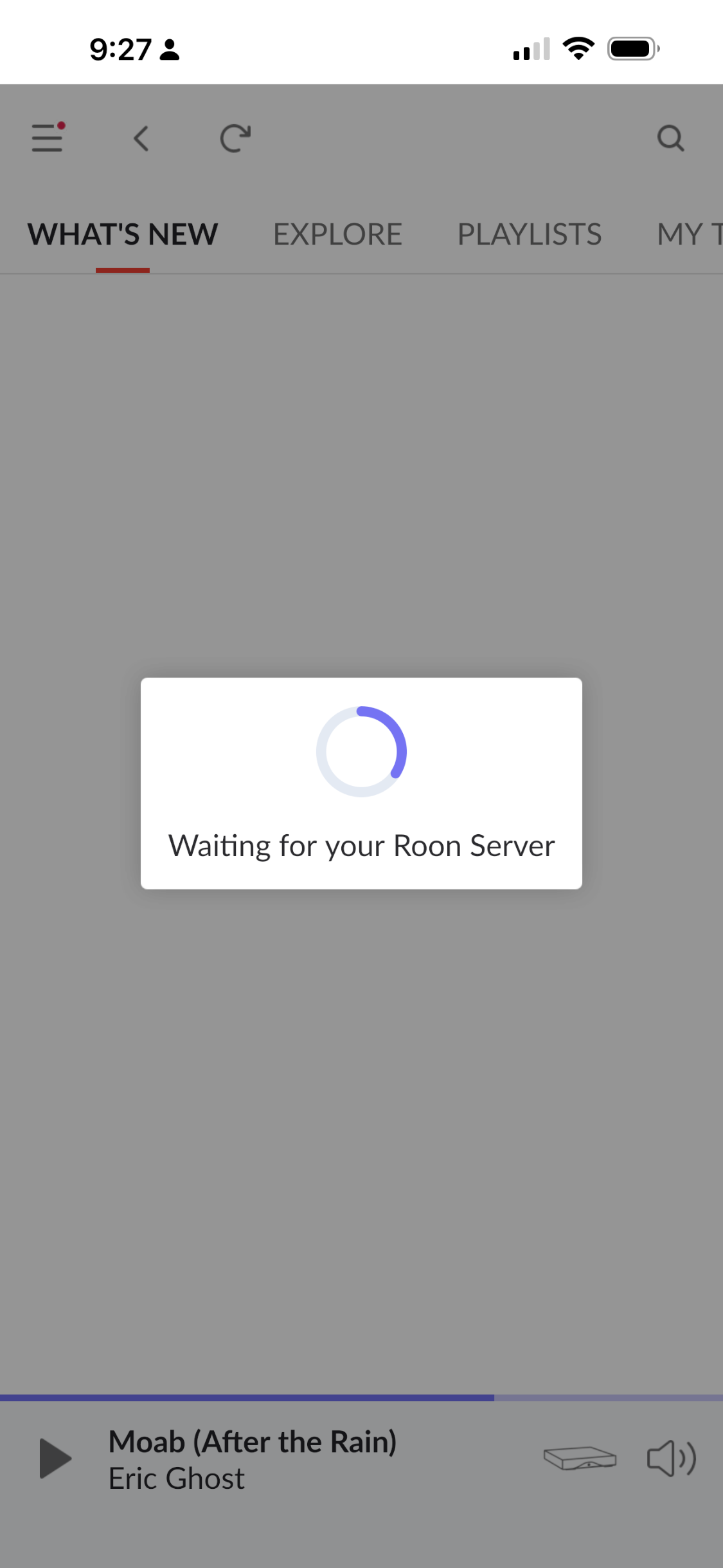

I have a Roon nucleus B. Over the last month using it from any controllers (laptop, tablet, IPhone, etc) I can usually play music to begin with but as soon as I switch to another album or song there is a lag/delay that can take 5+ minutes for the command to process.
I will see pops up such as audio is processing, this may take a minute (or something g very similar to that. I can wait 20 minutes and still nothing plays.
I have searched through any relevant forum topics with no success. I did read the issue may be router setting, so I changed it to “static” and this made no improvements.
This problem is the same whether I use Roon through a PA audio server plugged in to my DAC, streaming directly to my main system DAC (MSB streaming DAC) or streaming from a headphone amp/streamer/DAC.
All devices are plugged in to the Ethernet, so it’s not a WiFi issue.
I purchased the nucleus new about 5 yrs ago. SN 54B2039BA2A9. It wouldn’t work and crashed when I installed it. The vendor I purchased it from helped me troubleshoot it and generated a warranty ticket through Roon and the hard drive was found faulty. Roon sent me a replacement which I installed and it worked great up until about two months ago.
I’m able to stream to my devices directly with no issues using QOBUZ directly (not through Roon).
I’ve rebooted the Roon multiple times and it makes no difference.
When a track IS playing, it will pause intermittently for minutes at a time.
