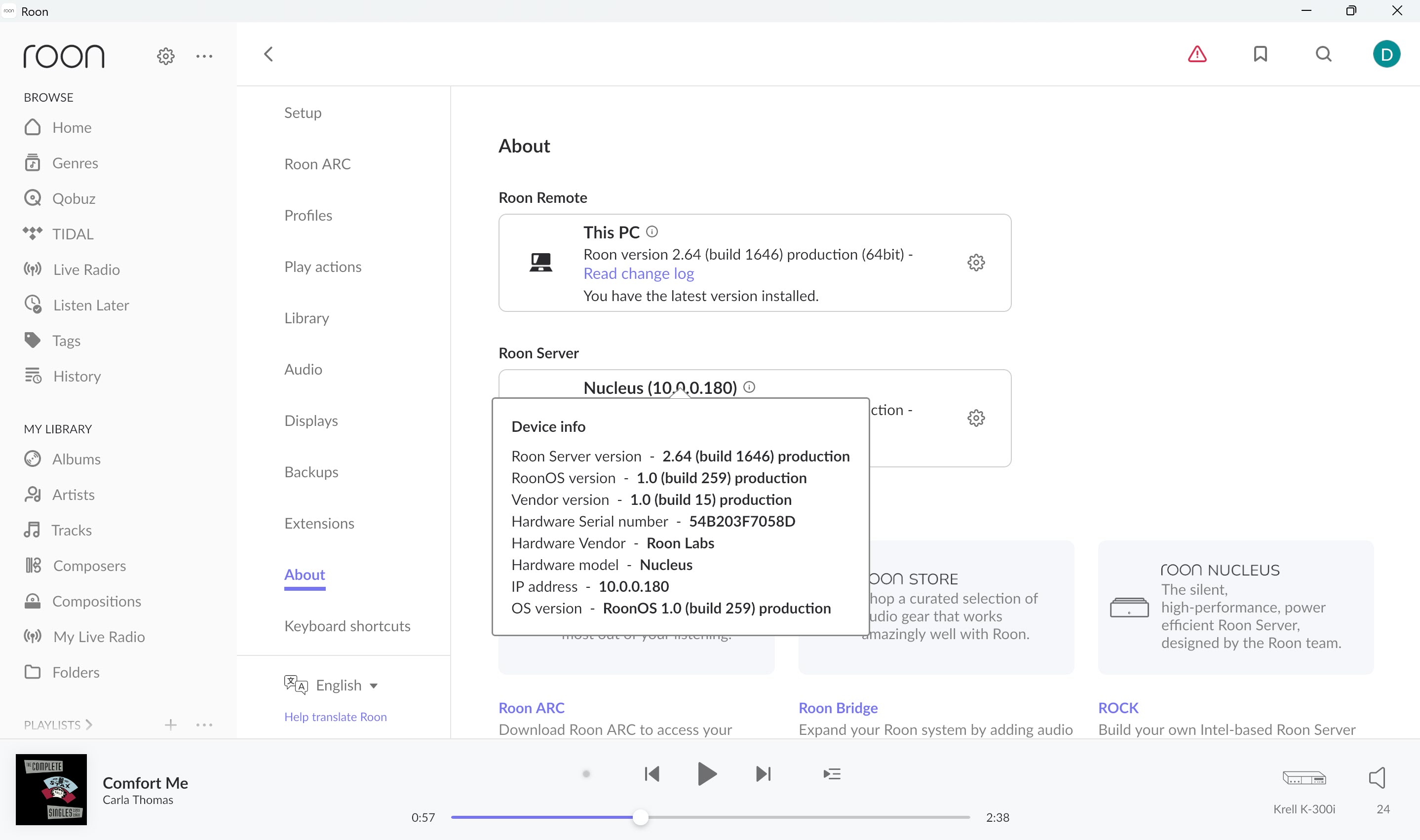

Roon version and server 2.64 (build 1646) production (64bit)

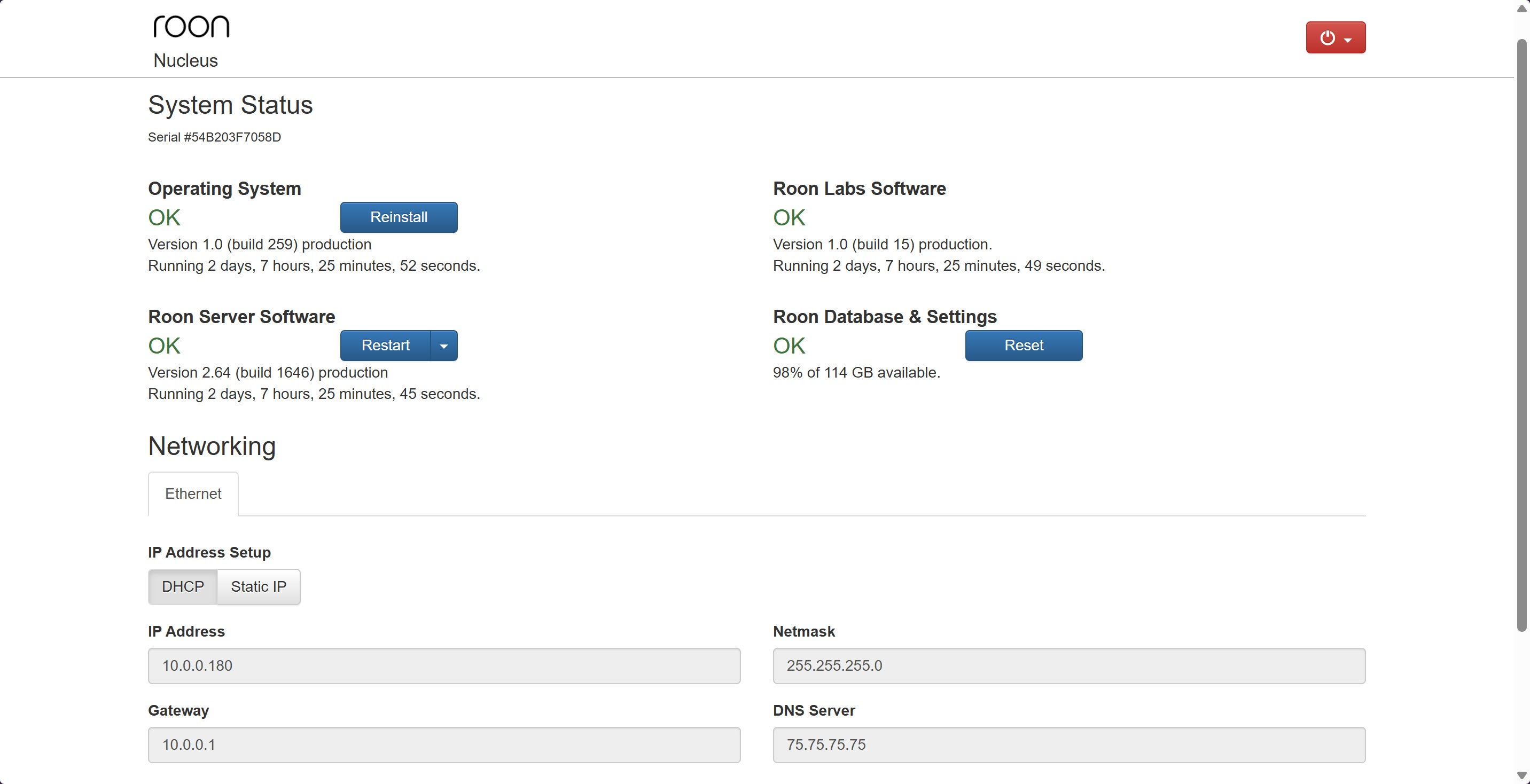

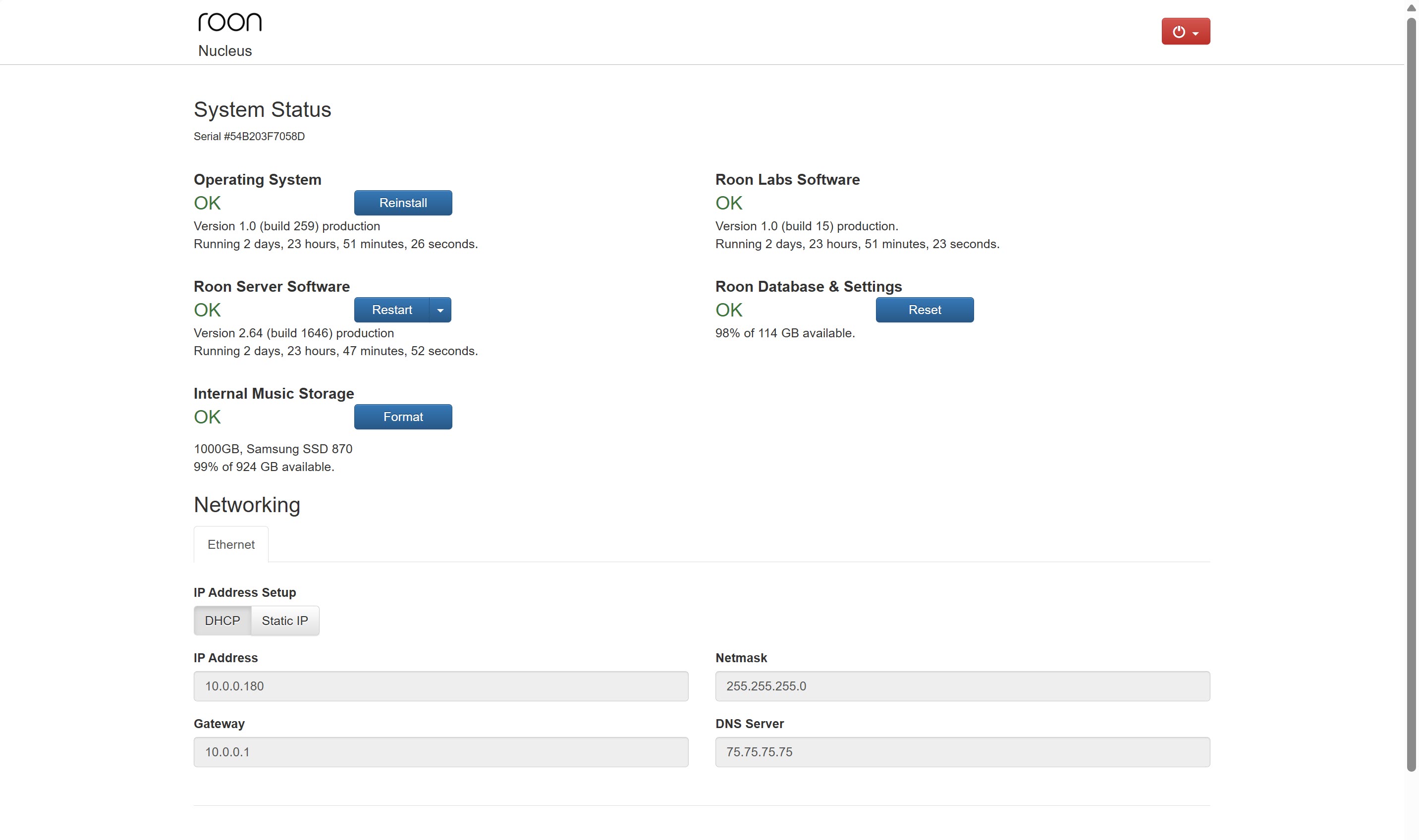

I’m not sure where I find the “network section” of the Nucleus. If these two screenshots don’t provide what you are looking for, please let me know where to find the information you need.

Additionally, such behaviour may be caused by the failed DNS path.
Here’s a step-by-step on how to change the DNS settings on your Nucleus:
Open a web browser on a device connected to the same network as your Nucleus.
  1. Enter the IP address of your Nucleus in the address bar.
  • If you don’t know the IP address:
    • Open the Roon app.
    • Go to Settings > Setup > Find Nucleus.
    • Note the IP address shown for the Nucleus.
  • Alternatively, use http://nucleus.local/ (on macOS or Windows with Bonjour installed).
  • Log into the Web Interface:
  1. Once the web page loads, you’ll see the Nucleus web administration interface.
  • Change the DNS Settings:
  • Scroll down to the Networking section.
  • If the Nucleus is using DHCP:
    • Note that you cannot directly edit DNS settings under DHCP. You will need to switch to a static IP to specify custom DNS servers.
  1. Switch to a Static IP:
  • Click on the Configure or Edit option under networking.
  • Enter the current network settings for your Nucleus (IP address, subnet mask, gateway) manually. These can often be found in your router’s settings or your current DHCP lease information.
  • Specify Custom DNS Servers:
    • Add DNS servers in the relevant fields. Common choices:
      • Google DNS: 8.8.8.8 and 8.8.4.4
      • Cloudflare DNS: 1.1.1.1 and 1.0.0.1
      • OpenDNS: 208.67.222.222 and 208.67.220.220
  • Save and Apply Changes:
  • Click Save or Apply to confirm your new settings.
Restart the Nucleus (make sure Roon Server is stopped) and let me know if you continue to experience stoppages when streaming
Please give these steps a try and let us know if the UI speeds up and the artwork populates!

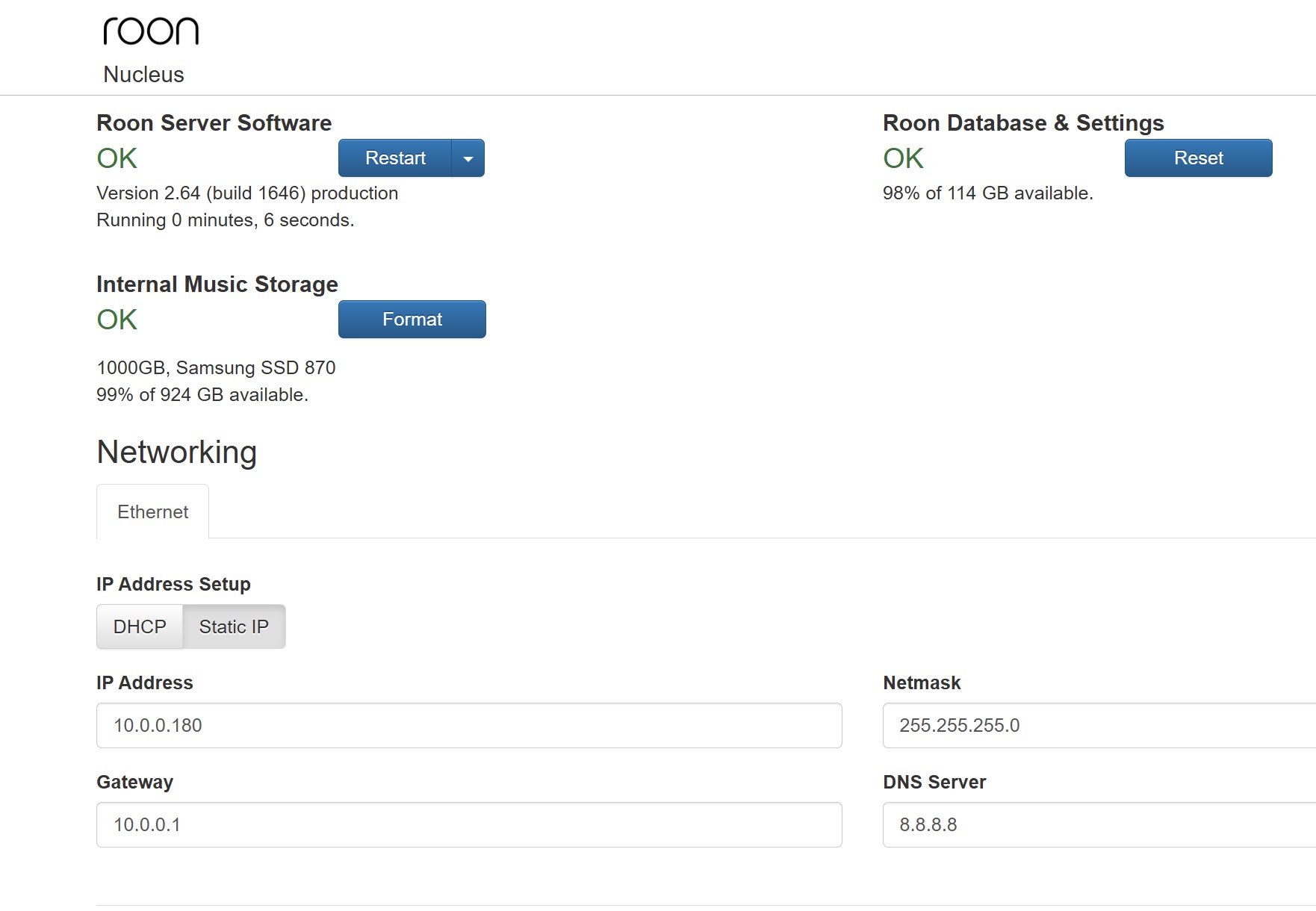

I was not exactly sure how you wanted me to handle the DNS settings. Roon was set to DHCP. I selected Static IP and set DNS to 8.8.8.8. I left IP address, gateway and netmask same as DHCP. If I should have done something different, please advise. (screenshots attached).
Things seems to improve and I tried briefly across my Windows laptop, iPhone and iPad. I’ll give it a solid run through tonight. Thank you again.

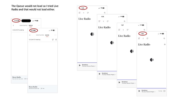

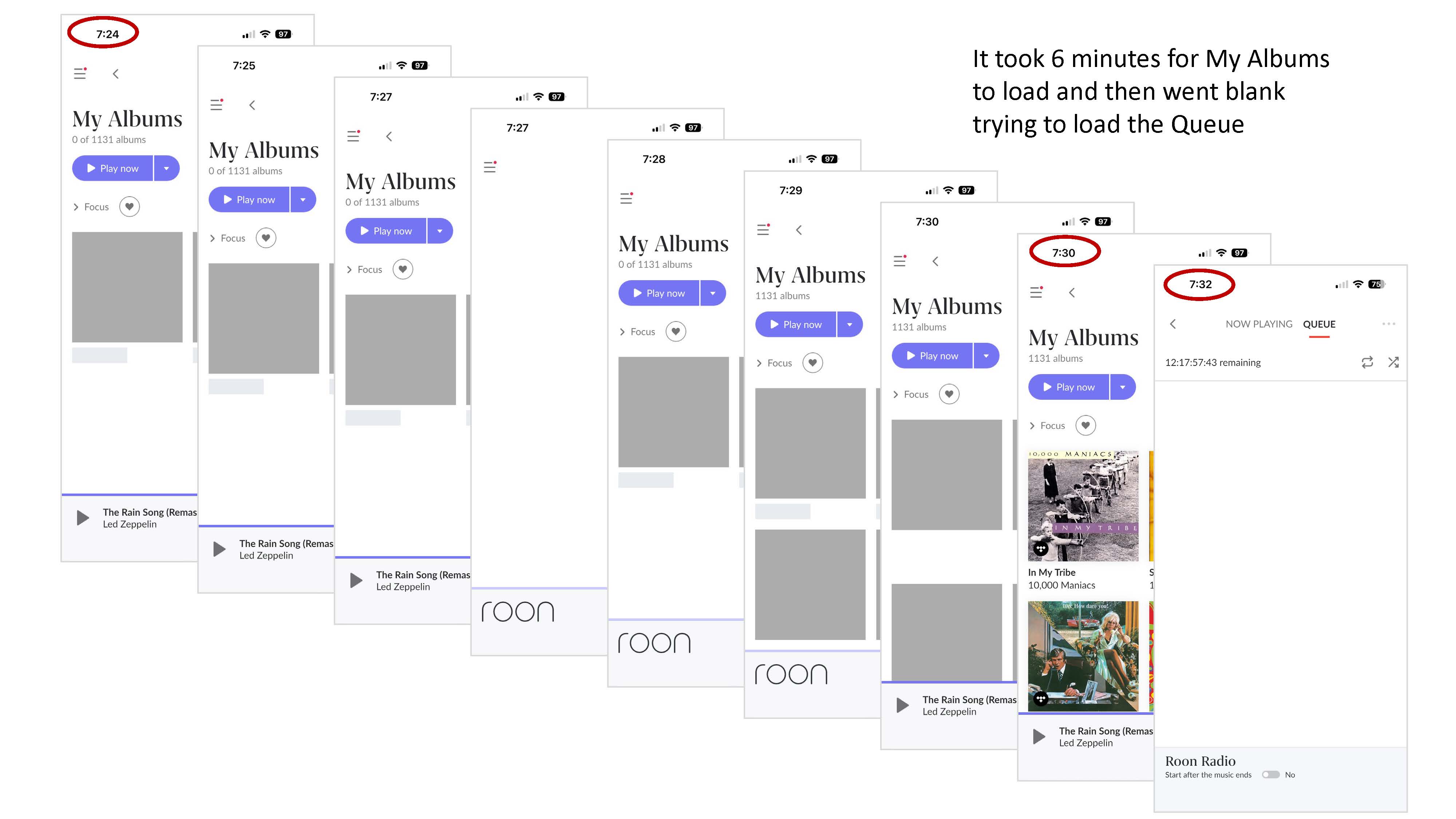

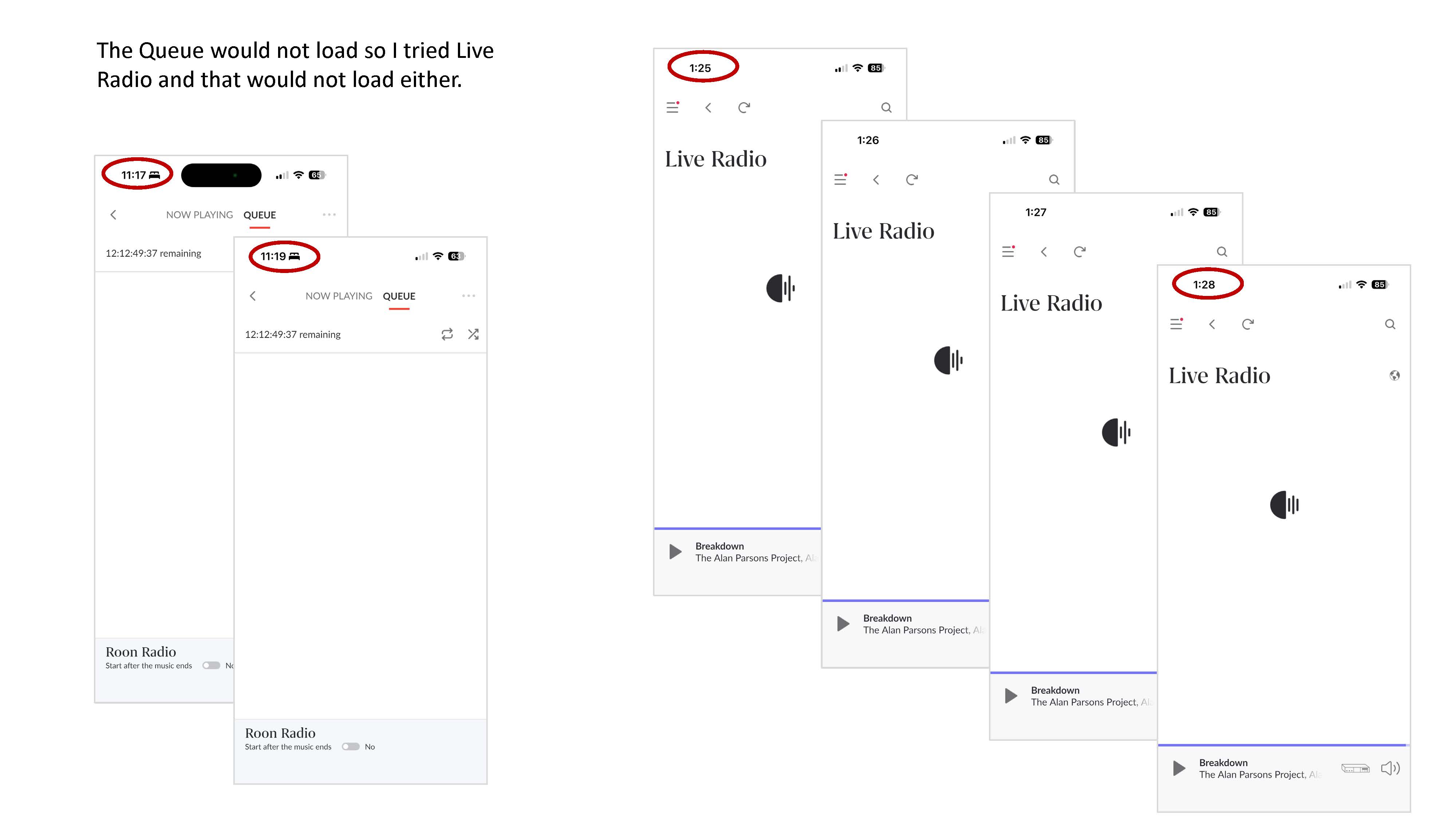

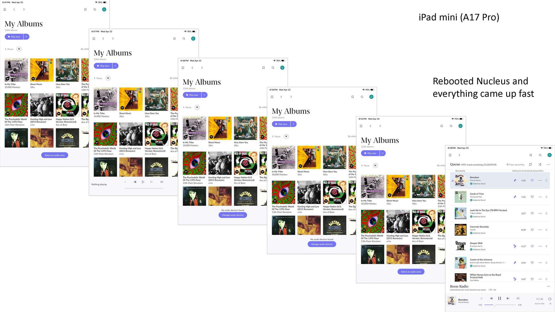

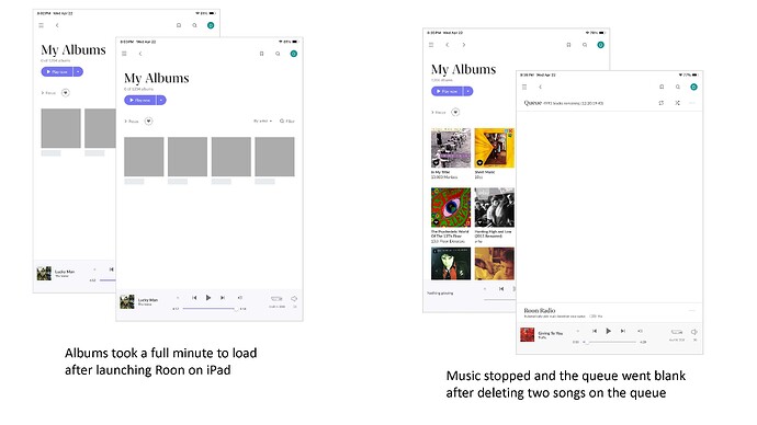

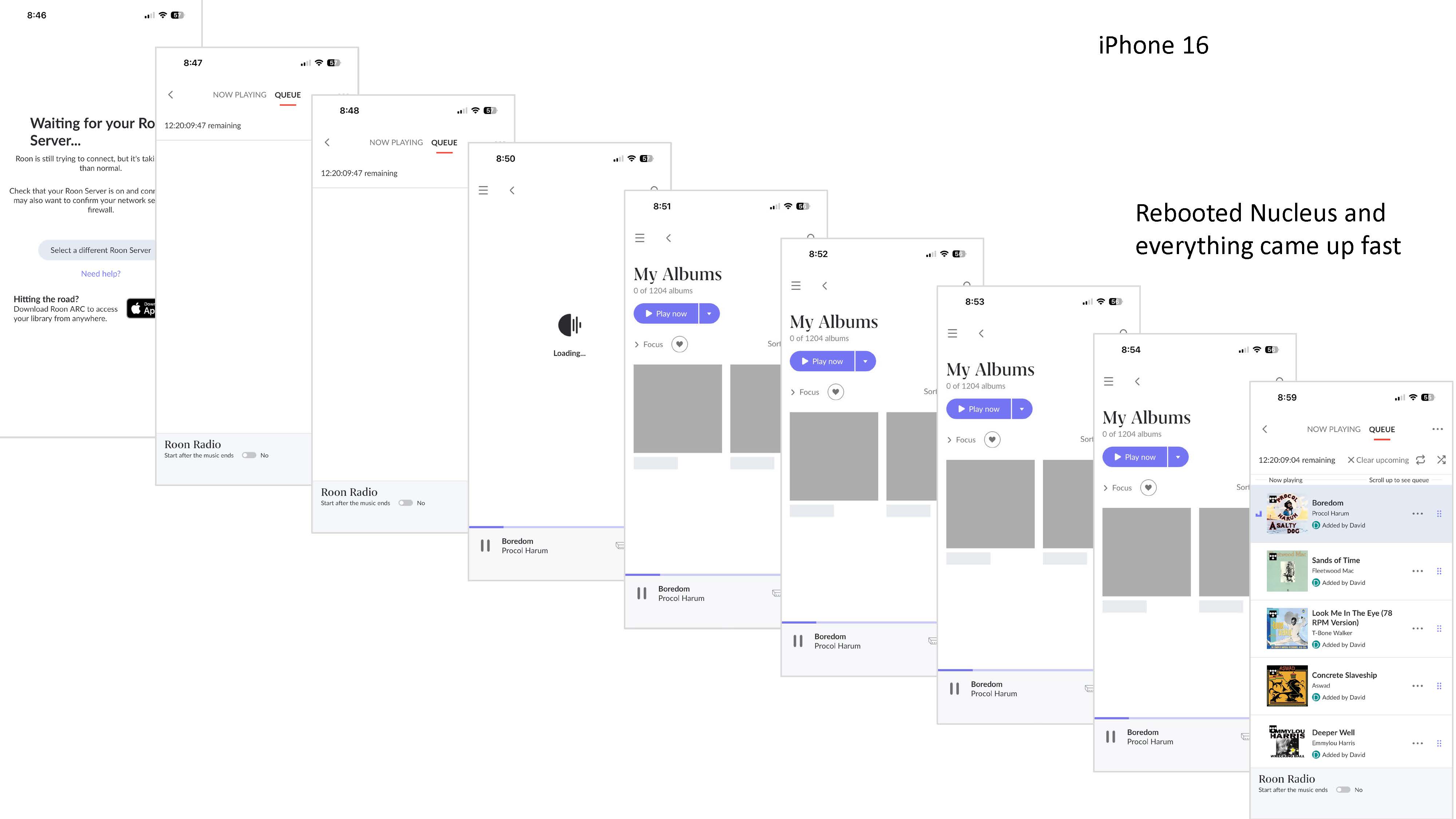

I’m still having performance issues. Here’s a chronology from the evening of April 22:
1.I launched Roon on my iPad and the albums took more than a minute to load.
2.I went to the queue and deleted two songs and the music stopped playing. This happened two times.
3.I toggled from the queue to the album and got the “Waiting for Roon Server” message.
4.I went back to the queue and it took a full minute to load and finally the music played.

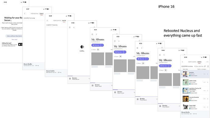

5.I launched Roon on my iPhone 16 and the music stopped. (See attached screenshots of iPhone and iPad.)
6.After waiting nearly 10 minutes, I finally rebooted the Nucleus and everything loaded fast on iPad and iPhone and I was able to delete songs from the queue without issue.

Thanks for the update and additional information. We were able to review a fresh diagnostic report from your Nucleus and observed a handful of events that could be causing the sluggishness you’re experiencing.
First, we’ve released a few optimizations with our latest Roon Software Release, are you noticing any improvements since updating your Roon Server?
With that, we’re seeing both your Krell K-300i zone and your iPhone zone had queues loaded with the maximum 8,000 tracks.
When you deleted tracks from the queue, the system also logged a TIDAL streaming warning (connection was running at 460 kbps against a 1,134 kbps minimum requirement). Then, the server dropped its connection entirely. The slowdown cascaded from there.
The performer/tracks browser took 25 full seconds to load during startup after the reboot, confirming how much work the server was doing just to manage those large queues.
The most immediate thing you can do to likely help performance is to test out using a smaller queue size, try something like 500 tracks and see how things perform.

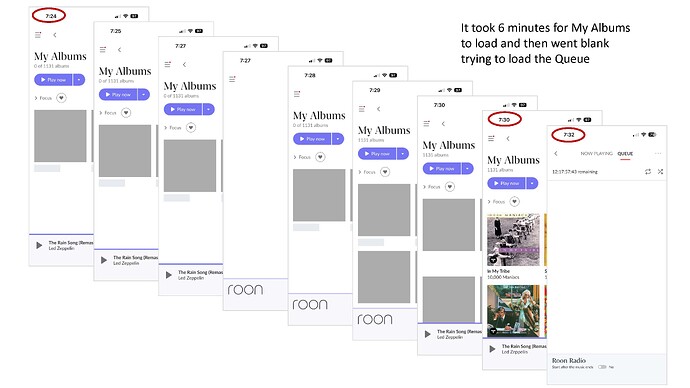

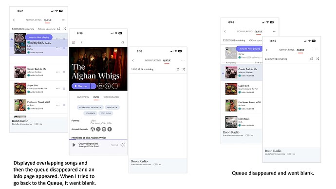

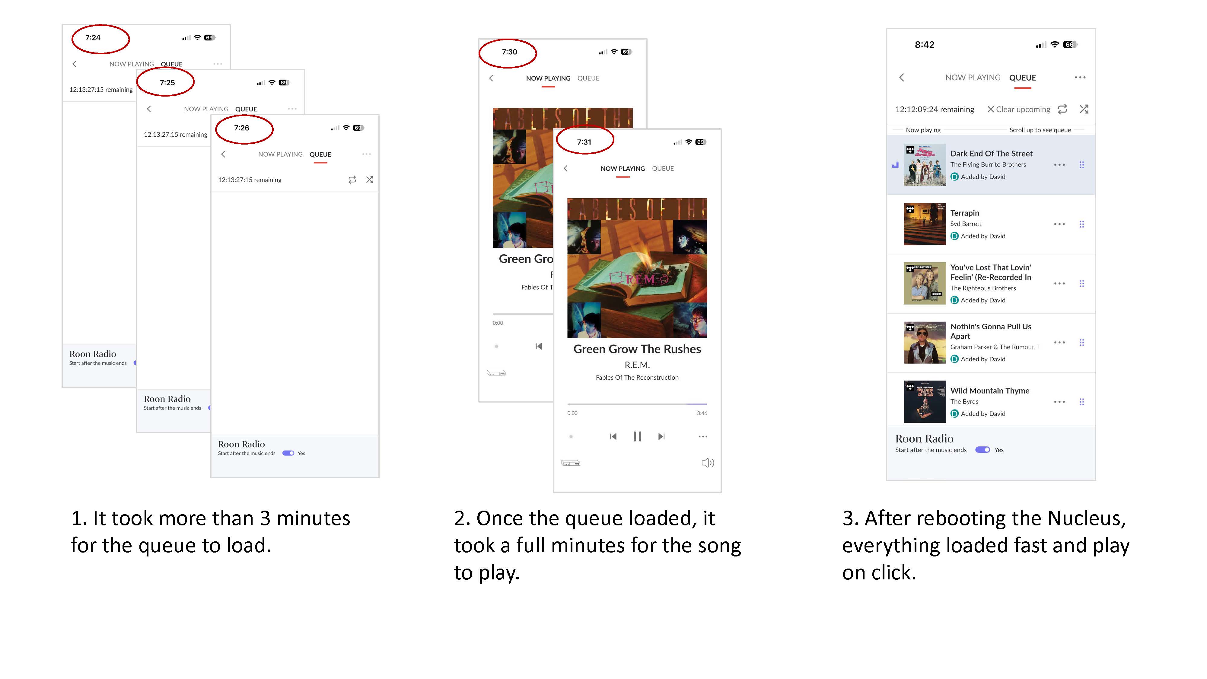

I continue to have performance issues with Roon and my Nucleus. For background, please see my prior ticket: Significant slowness in Roon on Nucleus requiring daily reboot (ref#ER25PH)
Support rctt_11-11-2
Current situation:
It take more than 3 minutes for the queue to load. I have been experiencing this ongoing.
Once the queue loads, it can take a full minute or more for the song to play.
After rebooting the Nucleus, everything loads fast and song play immediately.
I have attached screenshots with a recent example.
I don’t think I should have to reboot the nucleus daily for Roon and the Nucleus to perform.
