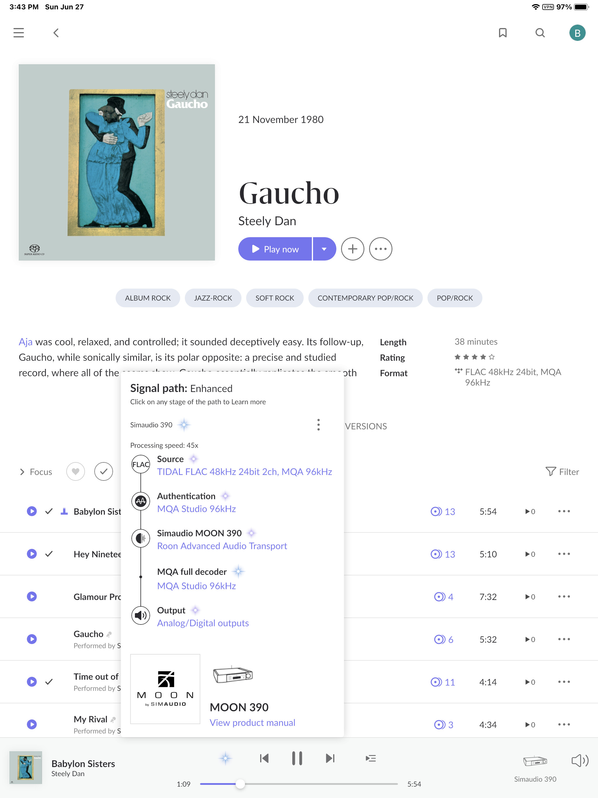

I had been using the Roon app to control the volume on my Moon 390. It had been working fine until recently when I lost the ability to control the volume of the Moon 390 using the app. Instead I get a "Volume Control is Fixed " message. I’ve gone to to device setup for the Moon 390 where it shows “device volume” for Volume control. I’ve tried unplugging Moon for 5 minutes, rebooting IMAC but I still can’t get back the ability to control the volume on my IPAD. I can control the volume of the 390 using the Mind 2 app or the Moon remote control, but I can’t get past the “Volume control is fixed” on the Roon app. The Moon 390 firmware is up to date.Any suggestions?
Please post a screen shot of the signal path when this is happening, and also the settings for this particular zone.

Thank you for providing these! A couple of further questions, are you sure you have been able to control volume through Roon previously?
I see a similar scenario with my Moon 430HAD, but i’m not certain though.
Second question is regarding your VPN-symbol top right on your iPad?
What is that used for?
And third, have you tried “Load defaults” from setting page?
I just noticed that your volume limits looks really funky? 0, 0 and 0?

Yes, I have been able to control the volume before without any issues. This is an issue that just developed about 2 weeks ago. The VPN symbol is just showing that I’m a using a Virtual Private Network app called 1.1.1.1 by Cloud Flare. I’ve been using this for years without issue. I’ve tried loading default settings for the Moon 390 but it doesn’t seem to do anything. Also the save button seems to be grayed out and not useable. Can’t make any changes to volume limits. The problem could lie here.
Greg-I have tried unplugging the unit for over 2 minutes. Unfortunately there was no change. The firmware on the 390 was updated in the past month. May be it’s contributing to the issue that I’m having.
Thanks for questions and suggestions.
A little clarification on the save button. It is greyed out until I change a setting and then it is usable. I cannot change volume limits. If I click load defaults, the Roon logo quickly flashes on the screen and then disappears. I’ve tried setting the volume control to Fixed and saving and the back to device volume and saving without any success on controlling the 390 via the Roon remote app.
