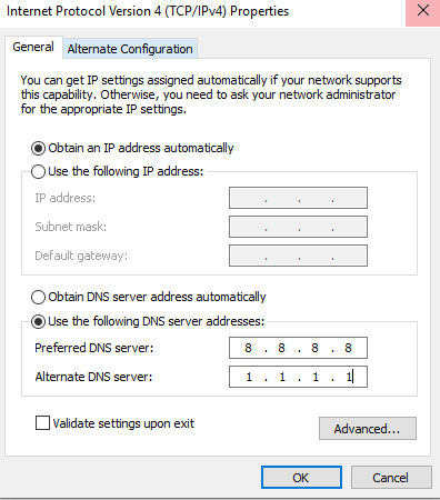

You can specify DNS servers in Windows even with DHCP set to automatic. They are separate settings. I’m using Pro, maybe you can’t in Home.
safadd
at the client.
True, but the router has a DNS setting for the DNS server it uses for name resolution on the internet. You can change this DNS on the router.
If the router provides a local DNS on the LAN, it will still communicate the router’s own IP to the clients by DHCP, and the clients will still ask the router for names. But the router will then use 8.8.8.8 (or whatever you configured) for names on the internet that it can’t resolve itself.
If the router does not provide a local DNS, it might communicate the 8.8.8.8 directly to clients by DHCP
But that would mean that the Windows machine can’t use names on the LAN anymore, so e.g. http://nucleus would stop working.
It is better to change the DNS setting on the router
