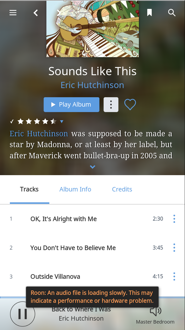

Added the airport extreme to the handle wifi and hardwired connections. The TWC modem has been switched to bridged mode. Still getting the same hiccups/pauses with the grouped pi’s. I have not notice any problem when playing a single pi. Haven’t tried two pi’s at once playing different tracks.
Below is the error notice I get in Roon. Now I’m really at a loss. I could try switching the core to a more powerful machine but the Mini already exceeds the specs.
