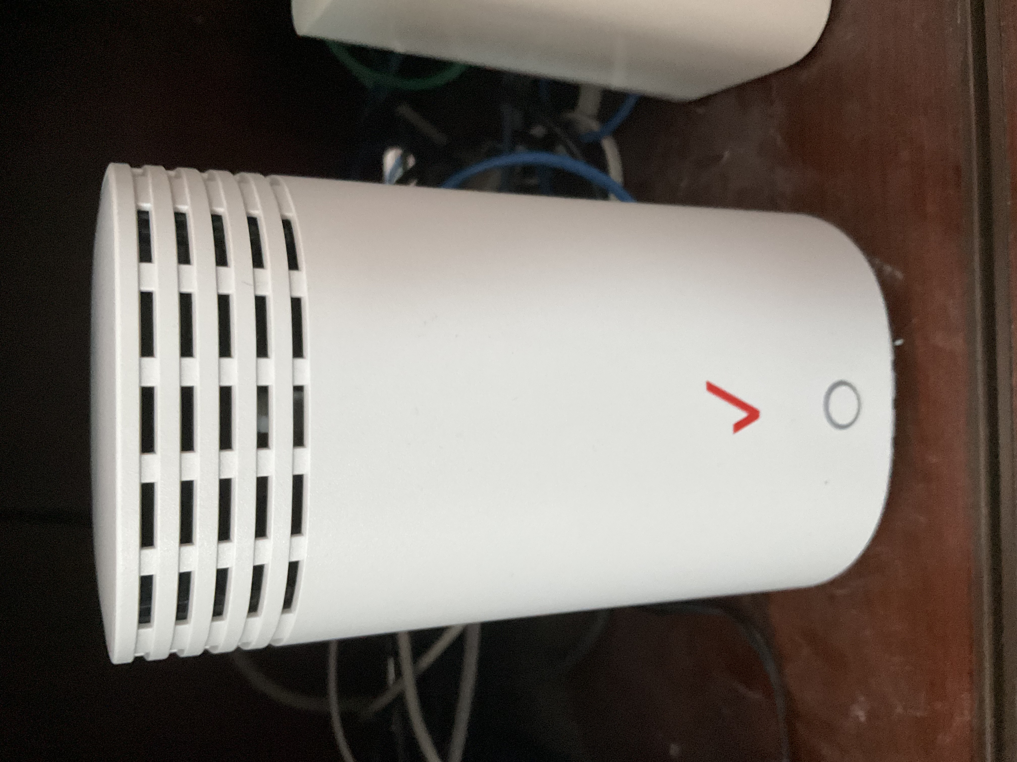

· It is a Verizon FIOS router.

I have a Cat5 wire plugged into the back of my Roon and the other end plugs into the back of the Verizon FIOS router I sent you a picture of, into the LAN 1 socket on the back of the Edison Fios footer. I didn’t use the cat 6 wire that came with the Roon because it was not long enough. Someone at your shop said a cat 5 wire was okay to use and not the problem with my initial attempts to connect the Roon to the internet. I can readily purchase a longer cat 6 wire if that is needed. My current cat 5 wire is about 10 feet long,

CAT 5e is just fine to use. Ripping Speed is usually a function of the CD Player being used and the connection method, assuming USB.
