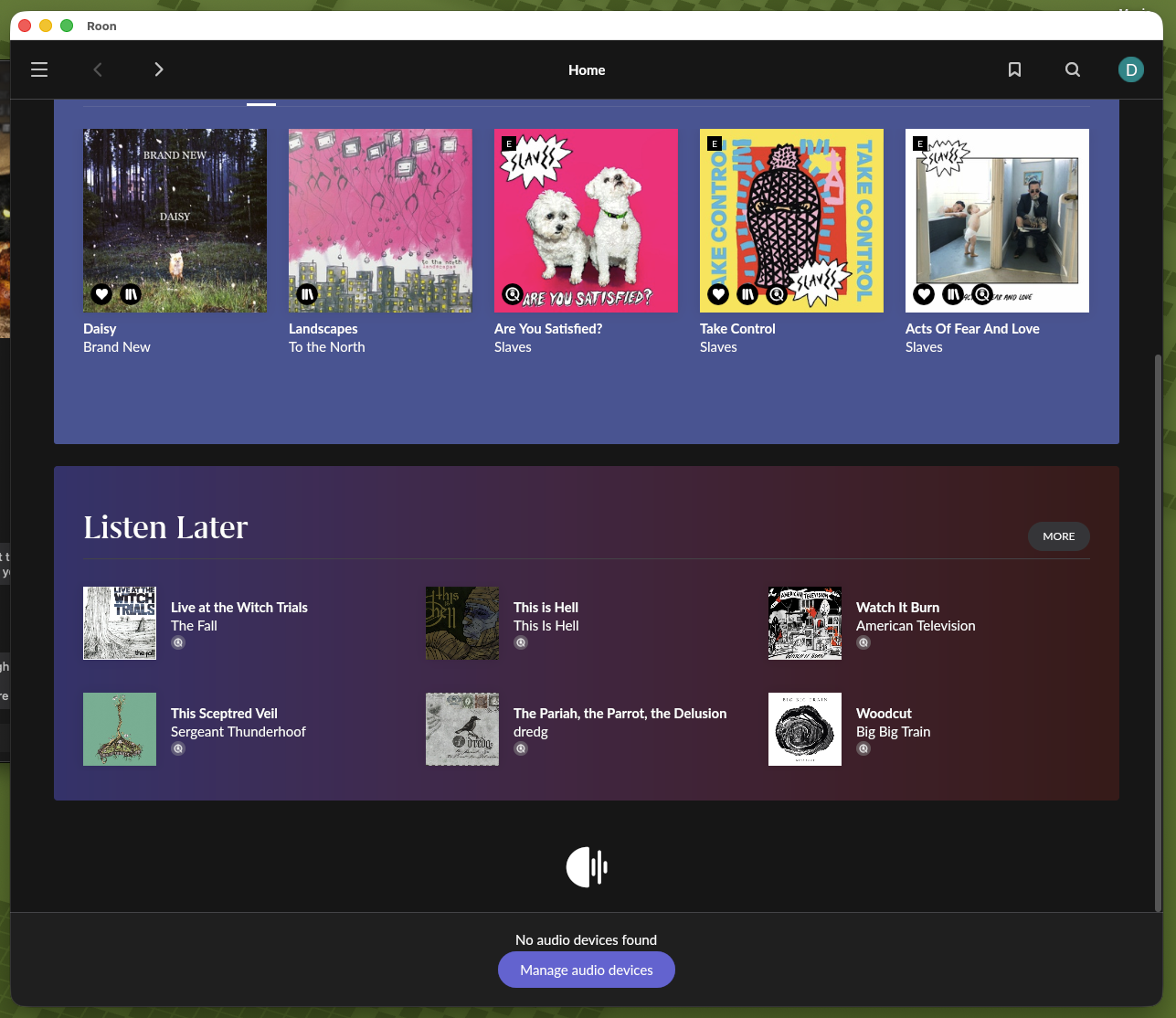

New Release section on Home page is now completely missing.
Home page loading incredibly slowly on both version 2.58 and 2.60 after genres for you section (i.e. affects Discover banner and Tidal playlists section)

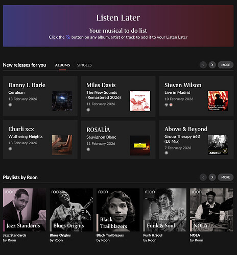

If I sit on the homepage and keep my iPad awake it eventually loads the Roon playlists, but the new releases section never shows…
hylo

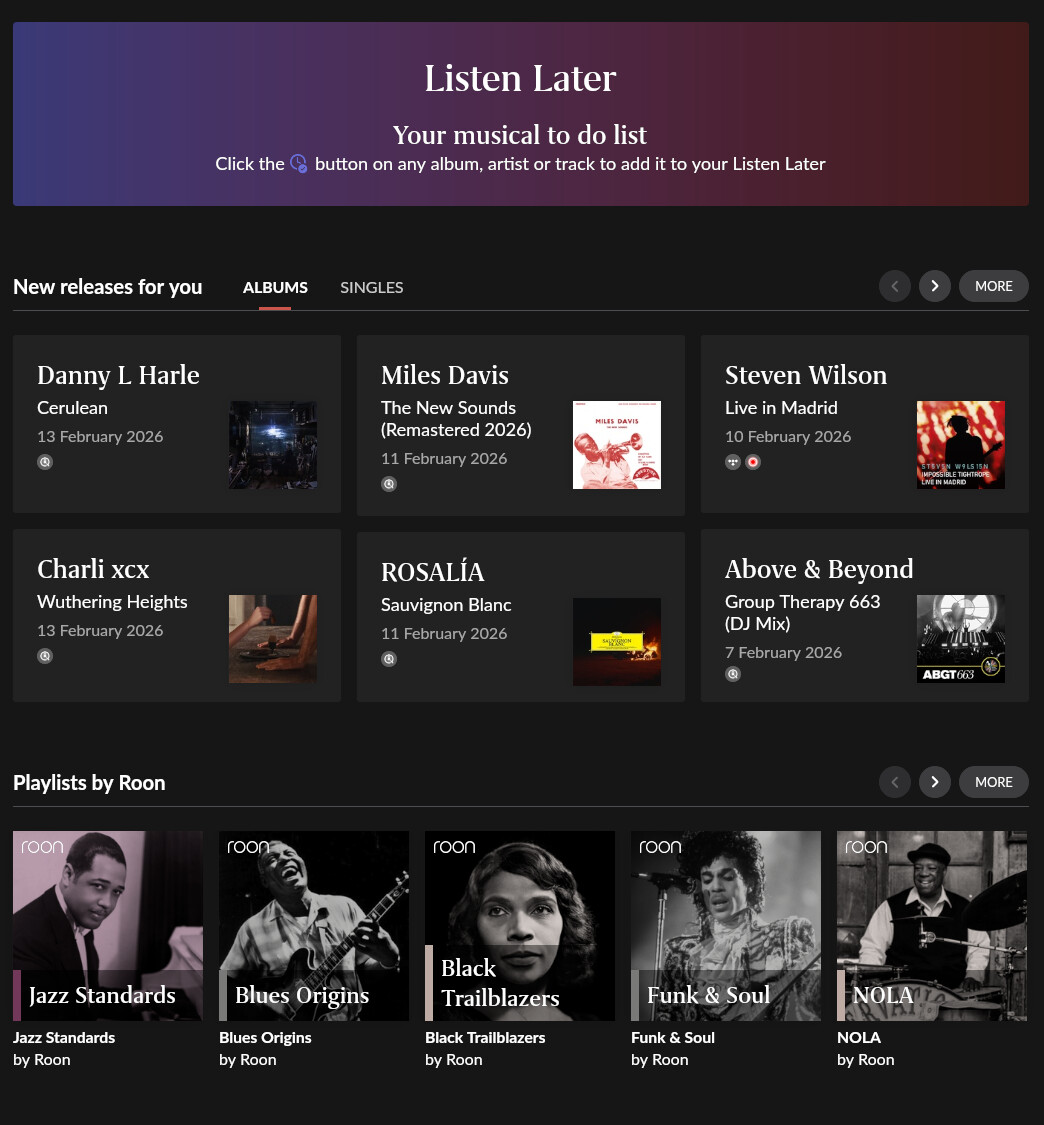

i have sign out of roon and back in and new releases show
This shows for some of us, but the other issues still persist. Massive sluggishness when loading underneath New Releases or any other information on Band pages, artist pages, etc. along with the error 526 issue for Arc.
