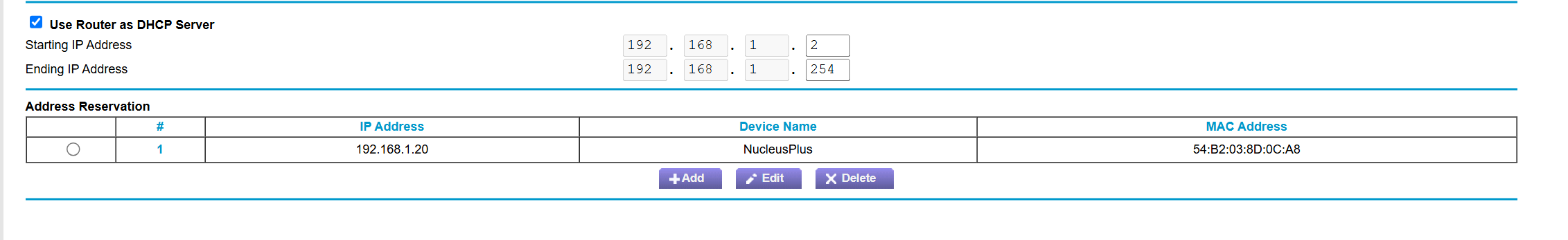

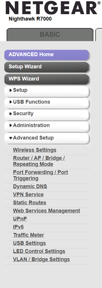

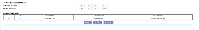

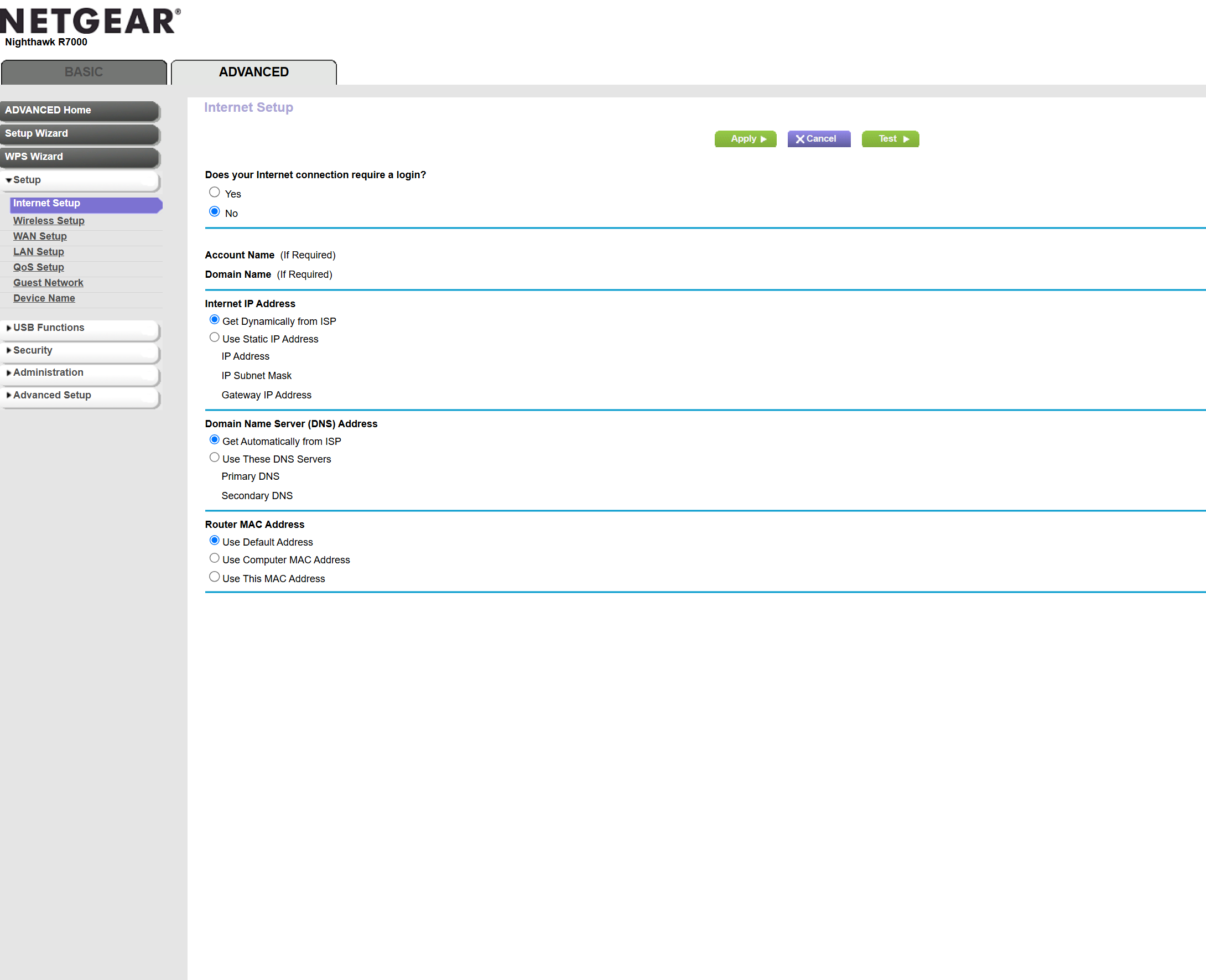

Router is Netgear Nighthawk R7000. I will need your advice on how to change those settings as I do not see where I can change the DHCP lease renewal time or assign a different DNS server. Here are some photos.

Thanks for the screenshots! You got very close when under the ‘internet setup’ screen within your router settings:
  • By default, the DNS is set to “Get Automatically from ISP.”
  • Select Use These DNS Servers
  • Enter the desired DNS server addresses. For example:
    • Google DNS: 8.8.8.8 and 8.8.4.4
    • Cloudflare DNS: 1.1.1.1 and 1.0.0.1
Reboot your router and Roon machines, and let us know the results. Thank you!
Changed primary DNS to 1.1.1.1 and secondary to 1.0.0.1. Rebooted the router, my desktop and the Nucleus+ and it made no difference.

Can you please try to set up a Reserved IP address for your Roon Remotes? According to logging, we are seeing the issue happen when your IP address for the Mac changes, let’s try to prevent it from changing with the Reserved IP to see if it helps.
I already did that over a year ago. I include a snapshot in this thread a couple of weeks ago.
Hi @MICHAEL_DENNIS,
Sorry for the long delay in responding to you. From your screenshots I see the reserved address for your Nucleus but none for your remote devices. Can you try adding reserved addresses for those?
