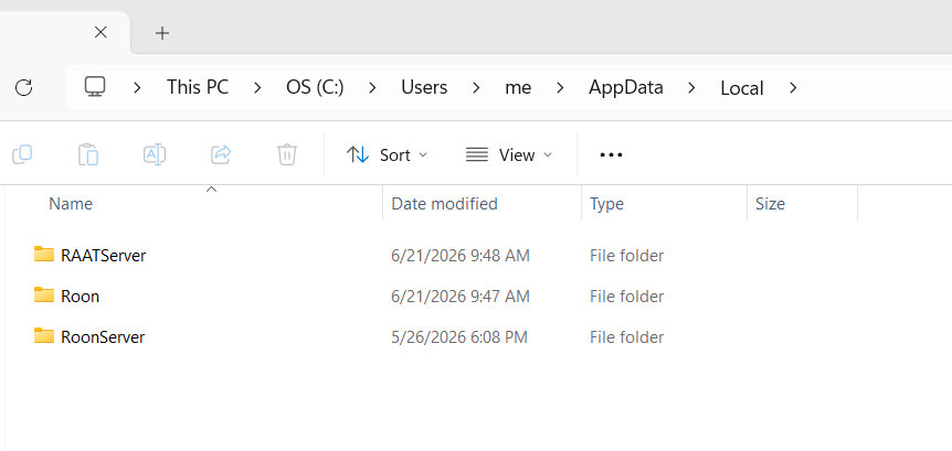

I did find it odd that I see logs on the Roon Remote system that would indicate it thinks it’s a server but maybe that’s normal, I don’t know.
